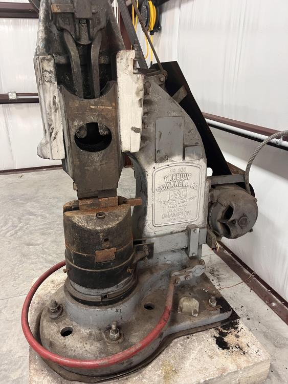

Simm367 Posted February 24 Share Posted February 24 I have a beaudry no 100 power hammer it has a 3 phase motor on it does anybody know what size hp it is ? Quote Link to comment Share on other sites More sharing options...

Simm367 Posted February 24 Author Share Posted February 24 If I had the tag to the motor I wouldn’t be asking with such little info this is all it has on it. And the company isn’t around anymore. Quote Link to comment Share on other sites More sharing options...

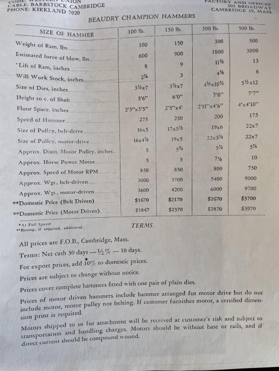

K A Willey Posted March 7 Share Posted March 7 I usually put 5 hp 3ph 900 rpm motors on motor driven clutch model 100# Beaudry champions. Are you going to use 3ph power ? Here is a factory Sheet for your hammer 5 hp 850 rpm usually 3ph was recommended the hammers never came with a motor unless customer shipped them a motor. paper is from 1943 hope it helps Quote Link to comment Share on other sites More sharing options...
Latticino Posted March 8 Share Posted March 8 If your motor is up and running (photo shows it already powered), you can put to work and measure the amp draw at each of the hot legs using a strap around (clamp on) ammeter. This will give you a direct measure of the brake horsepower currently required by the motor in question. Quote Link to comment Share on other sites More sharing options...
