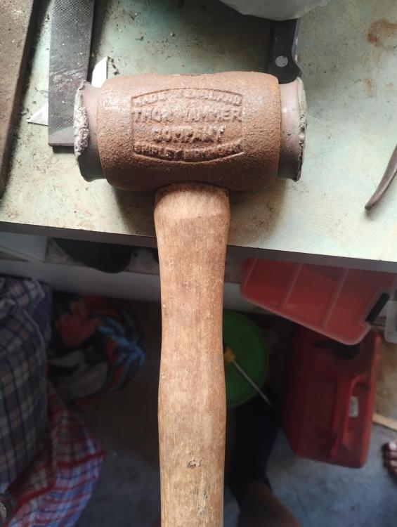

I was looking through my father's shed today and found this hammer.
From what I could find it may be pre 1970 as they changed the stamp to just be 'Size 3' in 1970.
Any advice on the best way to spruice this one up as I think it will be a handy hammer. I was thinking of using a wire wheel then put on some linseed oil.

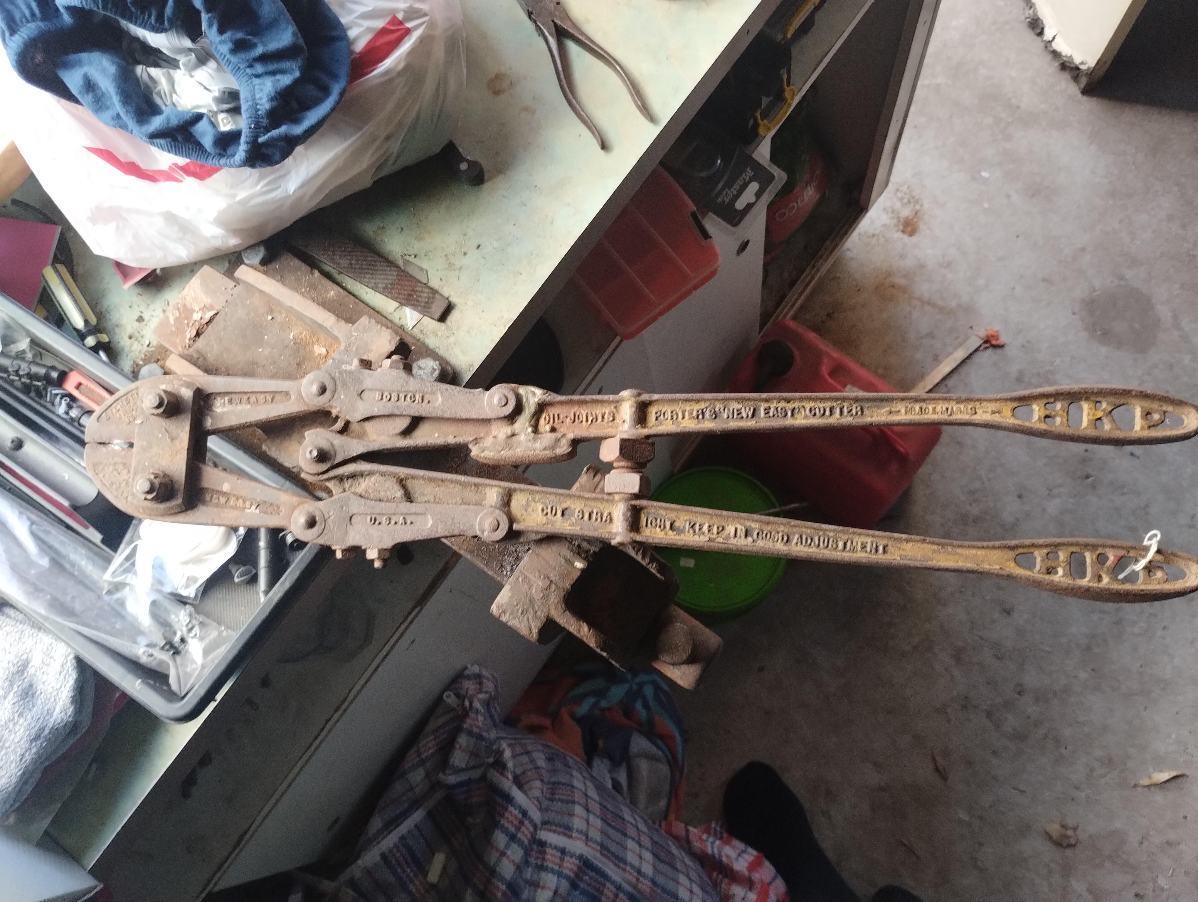

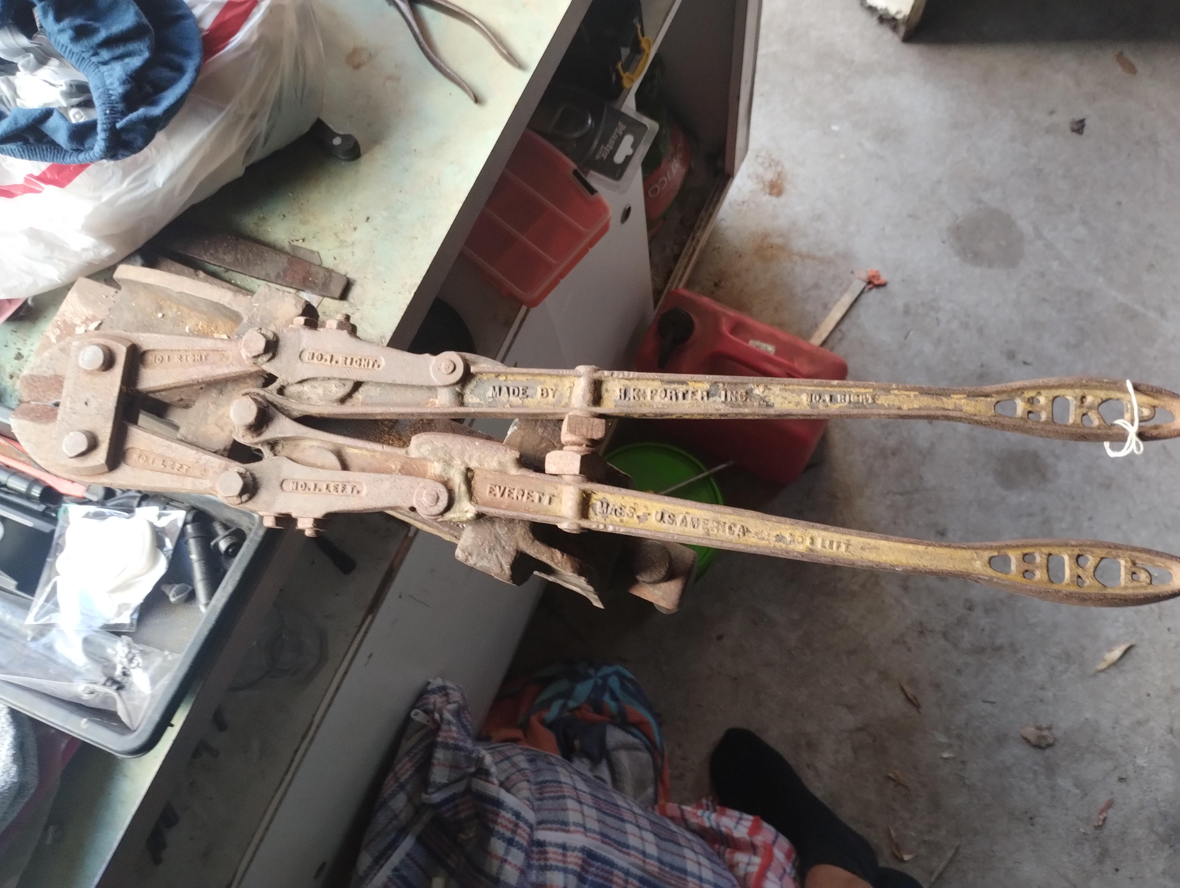

Also found these bolt cutters. Made in the USA so must be good quality hey?

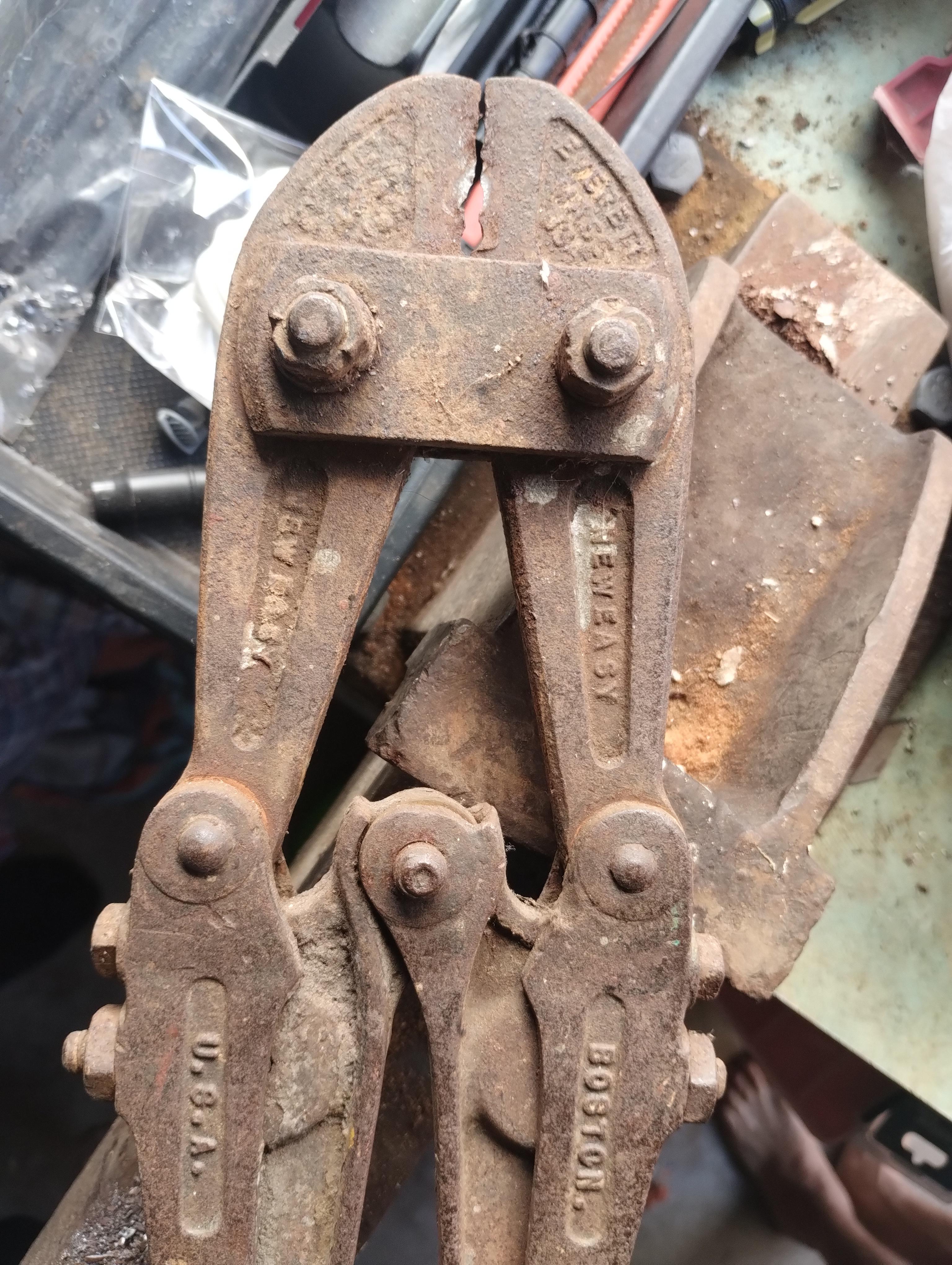

Is there a way to improve the cutting jaws as they are a bit rough?

About the only thing I would do is file the rolled edges of the hammer head and BLO on the handle. Sorry to say not much can be done with the bolt cutter jaws without adding material by welding with the correct electrode and grinding them back sharp. If you know an experienced welder they could do it.  I fixed a pair just like those that way.

Since the hammer is cast copper and soft I would do as Irondragon suggests and file back the mushrhrooming on the faces.  I am sure that the faces are dinged up and I would smooth them out by filing or grinding and perhaps polish them a bit.  That's all.
I agree with Irondragon that the only way to salvage the bolt cutters is to diassemble them and replace the jaws or have them build up by a welder and ground back to shape.  He or she would definitely have to use very hard rod to build them up since in use they are subject to very high stress.  I'd also look to see if repacement jaws amight be available but I would be very careful about the geometry of the bolt holes on a replacement.
It's been a long time ago but I think the electrodes I used were Stoody Stoodite 21 rods, preheated the jaws and quenched in oil.

Copper and brass hammers are nice for struck tools, as they are softer than the drift/punch/whatever, so they tend not to deform them as much. Unfortunately, they get pretty dinged up and mushroomed in turn. I've also used them to straighten twisted pieces, especially hitting them onto wood, but that doesn't work as well as a wooden or rawhide mallet.

The surface rust is the main thing I want to improve on the hammer so I can preserve it. The faces are actually pretty smooth. I read old posts suggesting that the copper inserts eventually wrap around the head which protects it. Replacing the inserts is a pain from what I read and it's recommended to just buy a new hammer. As it seems like it's very old I would have a go at replacing them but that is a long way off. Having one end as rawhide would be ideal.
With the bolt cutters I did find old posts regarding replacement jaws on other sites but not sure if they are still available. I will do some more searching. Im sure they will still cut, it may just take a few goes. Otherwise they may just end up on the wall as a decoration.

If you can separate the various metals, copper, brass, iron, there are a number of effective chemical treatments to turn rust, corrosion, etc. back into clean metal. For iron / simple steels a phosphoric acid treatment works nicely though it WILL cover the iron with a black phosphate (I think) surface layer that is pretty stable or you need to take precautions to prevent it forming. There are common treatments for copper alloys like, "Brasso." I am blanking completely on the jingle we were having fun with recently. John?
