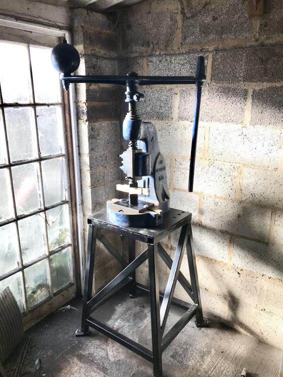

Can you weld? this is totally solid and silent. I would second that it needs to be bolted down really.
