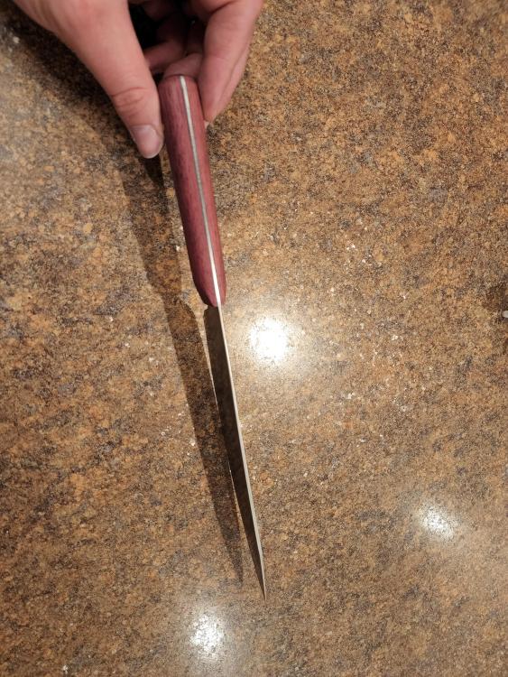

First completed knife
jmhallrn
Sorry, I forgot to post the specs. This started as .125 x 1.5 1095. Rough forged to shape including bevels, then finished on the grinder. The handle is purple heart and copper pins. It should get more purple over the next few days. Still trying to decide on the best finish for the wood. The oil/wax I did won't last long in the kitchen.
