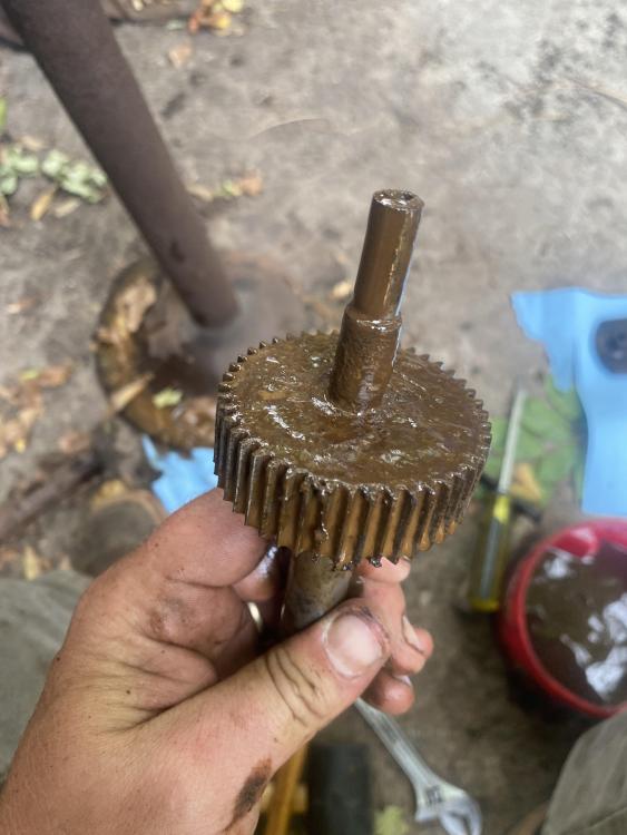

So I decided today that I was going to do a heavy oil on all my blowers especially the new to me ones that I haven’t got around to messing with yet,
and when I got to this little candy Otto and started filling her up while turning it over I noticed straight rust pouring out after a minute,

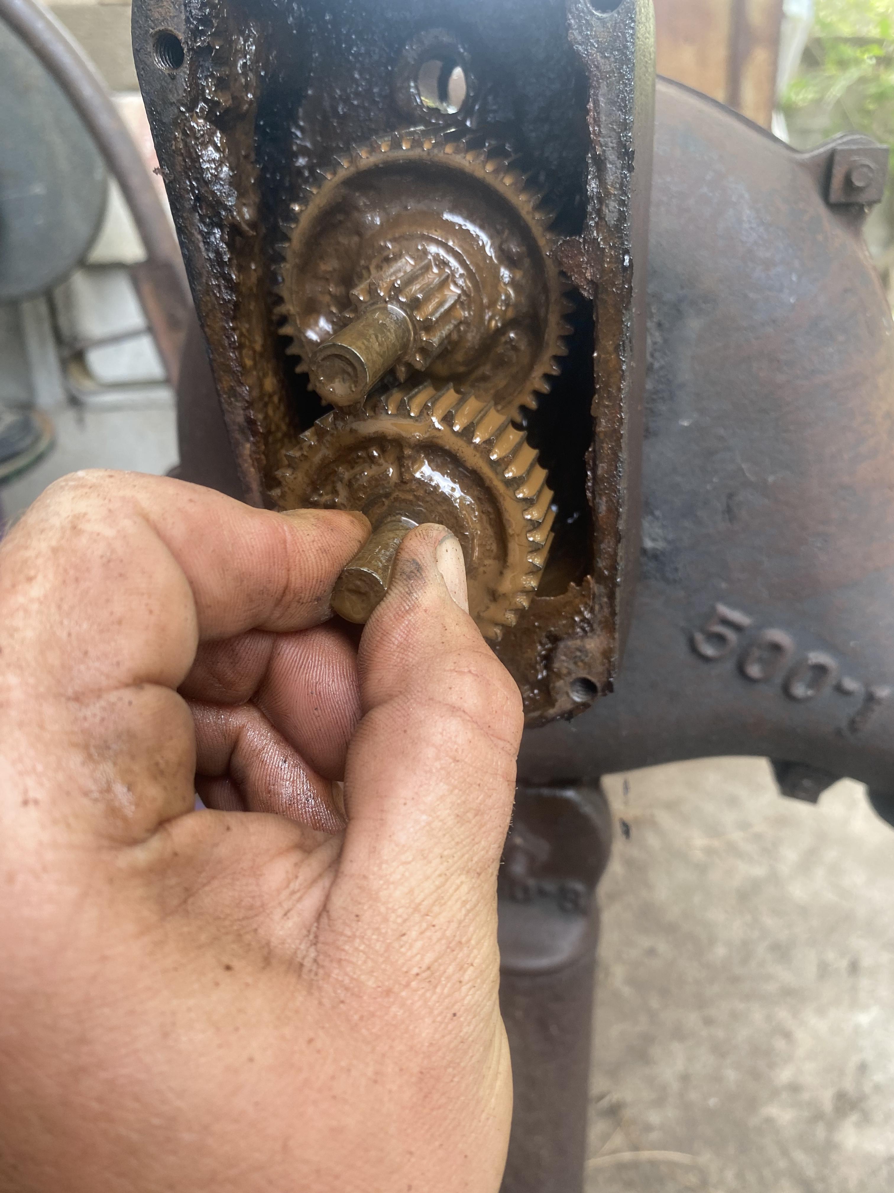

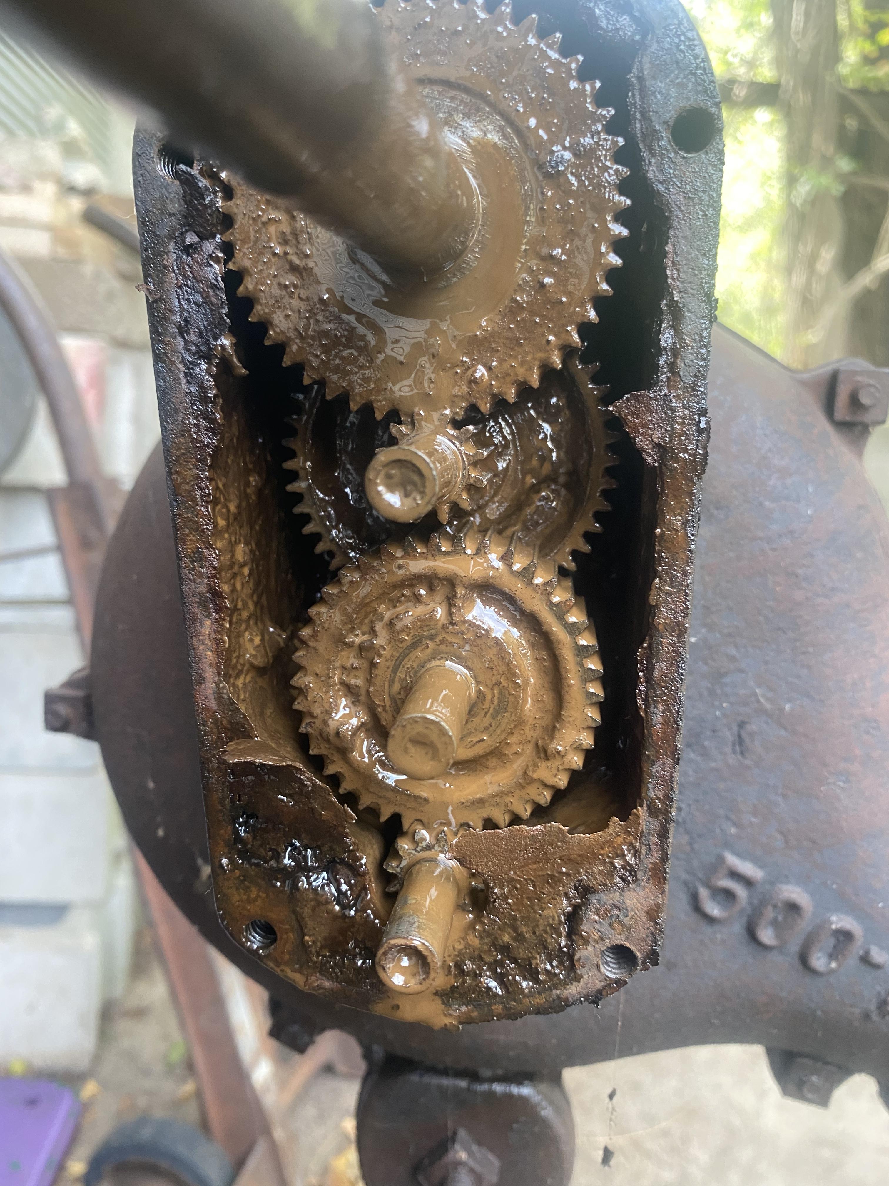

I decided I’d take a look in the gear box and….. decided it needed cleaned and flushed out,
there was lord knows how many years of dirt, rust, and ancient grease, (not to be confused with Ancient Greece) beat you to it Frosty!  lol,
Anyways the gears had hard packed rust an dirt between the teeth so it was a pretty tedious job, I soaked and used a wire brush to no avail so I ended up using a small flathead to bust the junk out from the teeth,
i dugout and chipped out the inside of the gear box and then finally flushed everything out, I reassembled it an put grease in the bottom, to help seal up an hold oil,

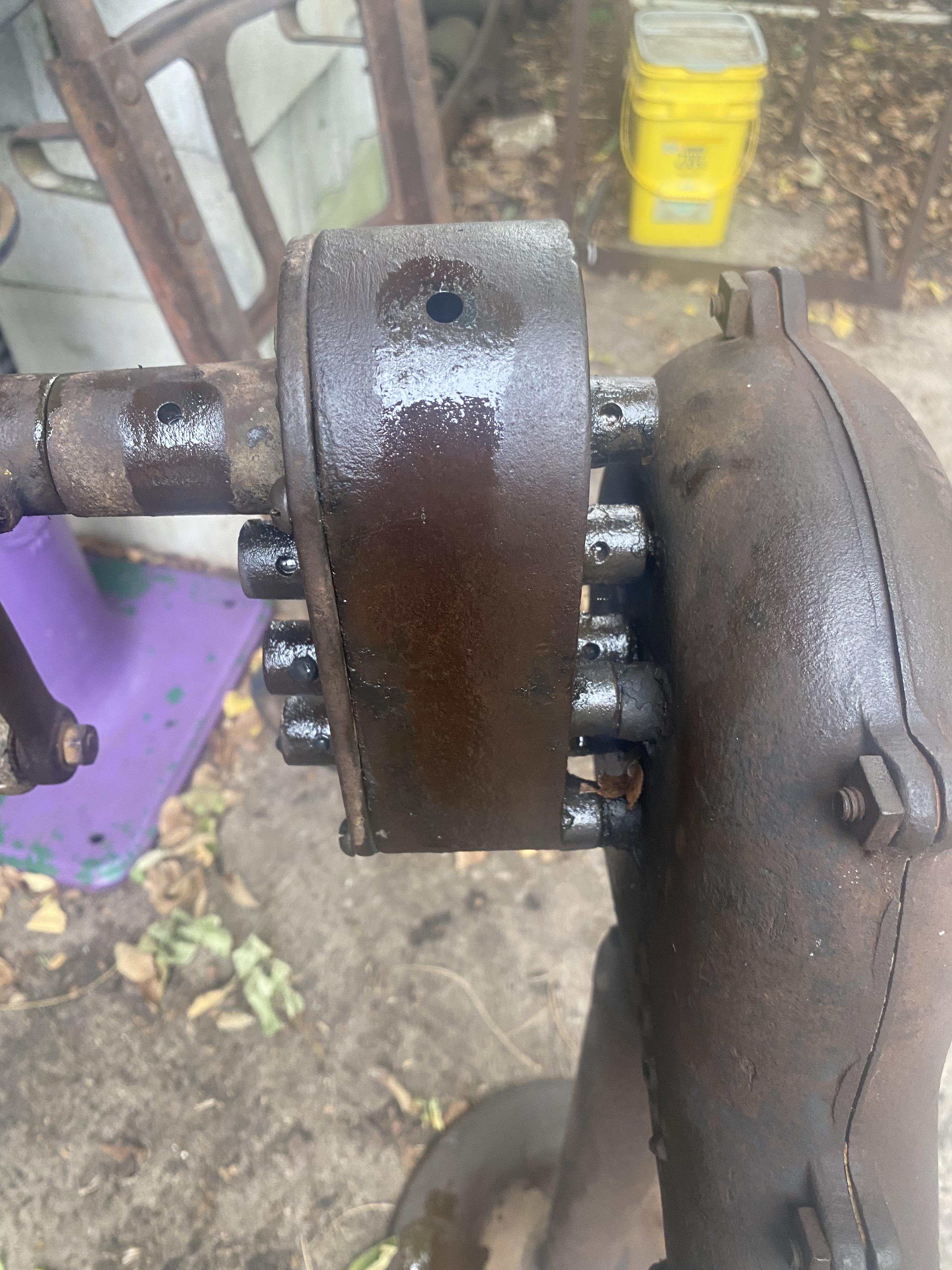

One thing I found interesting about this blower is it has nine oil holes!
Four on each side of the gear box for both ends of the four shafts and then another on top!
anyways she’s turns smoother now and turns three times after letting go of the handle,
only one thing is I think I may have put a little to much grease in it because after turning it awhile some grease started coming back out of the bottom oil holes,

I'm always pleasantly surprised at how well old equipment like this cleans up and how well it works after restoration.  The old grease and oil inside the sealed gear box seems to act as a preservative and once it is removed the machinery is as good as new.  A lot of these are a century or more old and I suspect that they my be working well for at least another century.
I doubt it ever had grease in it, oil dries and oxidizes into a greasy sludge before it turns into an asphalt like solid. Mine loves life with a couple few drops of bar oil in the oil holes. My main machinery oil in the shop is a gallon jug of chainsaw bar oil with about 1/4+ cup of Duralube. It sticks to the gears but splashes enough to get o everything in the gearbox.

Frosty, your prolly right about it not being grease, the bar oil idea I really like, I think I may start trying it out too, ive been oiling my blowers with sae 30, but I keep several gallons of bar oil on hand in the shop so it won’t be a big deal to switch over, thanks for the idea!
