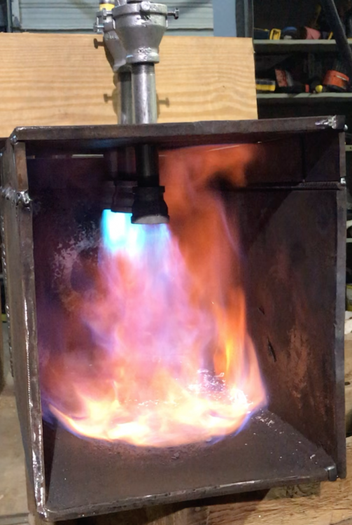

I read other posts trying to determine what to do but I figured ya'll need to see this yourselves. I have soooo many questions. Feel free to give any advice about this setup.
Box is roughly 12"x14"x24" with half inch plate steel, the burners are on a 0-30psi adjustable regulator and they are roughly 4" spaced apart, I was thinking of decreasing the spacing between the burners, and I was going to double line the inside of the steel box with Inswool 2300F, mount that with Hellcote 3000 Refractory Cement, and then have firebrick walls and floor as my working area.
I thought the insulation would take up plenty volume that I'd have a small enough working area, and I thought I could always add more insulation to close in more volume if need be.
My forge starts to choke out when its vertical like this right now, I wasn't sure if I should try using it on its side, or maybe angle the burners in there to help create more convection? before I tried putting in insulation I wanted to know if i should basically just scrap this or if I can still make this work.
Sorry in advance for my ignorance, this is mostly me googling things, comparing, and reverse engineering. I appreciate all help and responses.
Why so long?  Do you plan to do a lot of railing balusters?  Not many things require heating more length than you can hammer before it cools; though ornamental ironwork where you may be bending spirals in one go and doing long twists in  a single heat.  Heating more than you can work is TERRIBLE for large blades as it allows for grain growth, decarburization and scale losses.

I thought I could burn one burner at a time if need be but that doesn't really seem like an option, so now the plan is to bring the burners closer together, and then maybe close in the back area with 3-4 layers of firebrick to cut down on that length.
I'm not sure if over insulating is a problem inside the forge? I guess the biggest downside would be that it would take longer to heat up?
If over insulating is a problem, then I could just cut off some length to shorten it up.

It appears to me that at the time that picture was taken your burners have an excessive amount of gas compared to the air they are inducing.  The more burners you have in a given space the more opportunity there is for conflicts between the burners.  They can compete for air at the inlet side, although with the design you used it's not likely to be the main problem.  On the flame end back pressure is created, and back pressure from one or more of the burners can impact the performance of other burners.  The closer they are together the more likely that is to happen.
You posted this in the Ribbon Burner section of the forum.  A ribbon burner may be a good option for you, especially if you are going to decrease the length of the forge a bit.  Half inch plate is extreme overkill for a forge shell.  A sixteenth of an inch is more than sufficient.
It would most likely be worth your time to peruse our Forges 101 and Burners 101 topics.  They are quite lengthy, but they do contain the answers to most questions that people have about forge and burner design:
https://www.iforgeiron.com/topic/46536-burners-101/
https://www.iforgeiron.com/topic/47439-forges-101/
If you still have a lot of questions after reading those topics and/or others in the Gas Forge section that catch your attention let us know and we'll try to get you operating as quickly, efficiently, and inexpensively as we reasonably can.

Would you use a free car engine that got 8 mpg or one that cost several hundred dollars and got 40 mpg?  We say that "free stock isn't free if you have to spend hours pounding it down to a usable size/shape!"  For propane forges the main expense over time is the propane so you want to build one that's just right for what you want to do the most of, expecting to build others for special projects over the years.
Research First then build!  (Or follow an acknowledged known good plan *EXACTLY*!)  I'm down on folks who don't know the design details on complex systems who "design their own" and then want other people to figure out how they can make it work.  (This is different from folks who know something about things and enjoy tinkering on their own to come up with design improvements.  Of course I just swapped Frosty T burners into my 20 year old forge I built at a forge building workshop put on by an ABANA Affiliate.  (Relined more times than I can remember during that 20 years...)

It depends entirely on the insulating material.
2" of 2600 degree Ceramic wool coated with a refractory cement, and a coating of radiant flame face coating like plistix or the like- think of that like a heat mirror. It will keep the heat in the forge while being durable. The forge will also cool faster when turned off.
A hard fire brick- while fire & heat resistant... will work. But they're like a heat sink. Think of them like a sponge- that will soak up the heat from the interior of the forge. Eventually they'll get up to temp, but will take alot longer, and more fuel to do so. The forge will retain heat longer when turned off. Great for an oven, not so much for a forge.
I kind of explain like this- the burner isn't to heat the steel. The burners heat the forge, then the forge retains the heat, and transfers it evenly to the steel when inserted.
So the less effort to heat and maintain the temperature in the forge- the faster and hotter it'll heat steel.
If your forge is sucking up the heat, and not retaining it... only so much of it will go to your steel.

Gotcha! That helps so much, In that case it seems like I could still use this box just fill lots of the volume with the wool, and then be sure to coat it with the 2 appropriate coatings you mentioned.
Since i have an excess of insulating material it seems I could still salvage this forge and shape an appropriate interior with the insulating materials.
