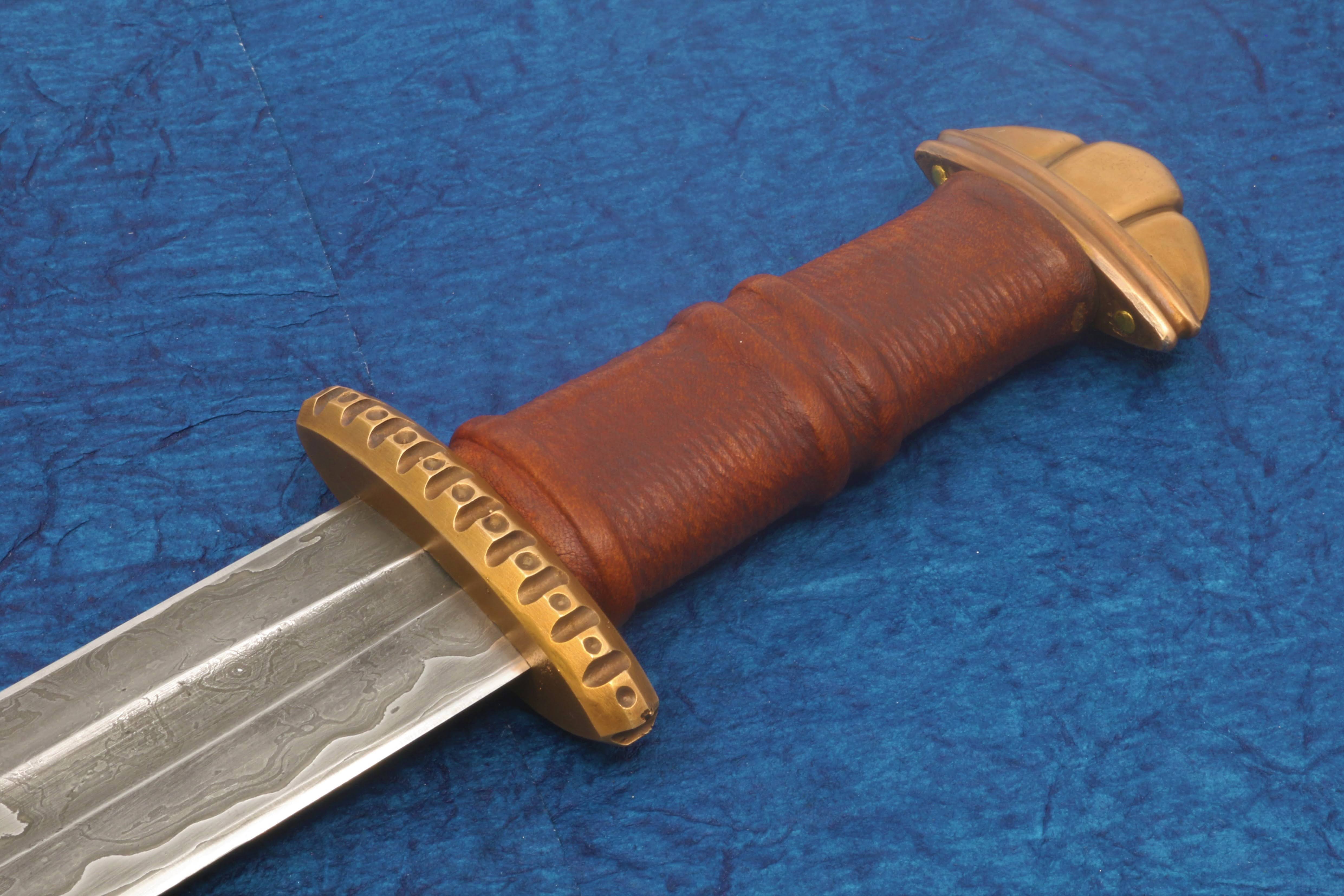

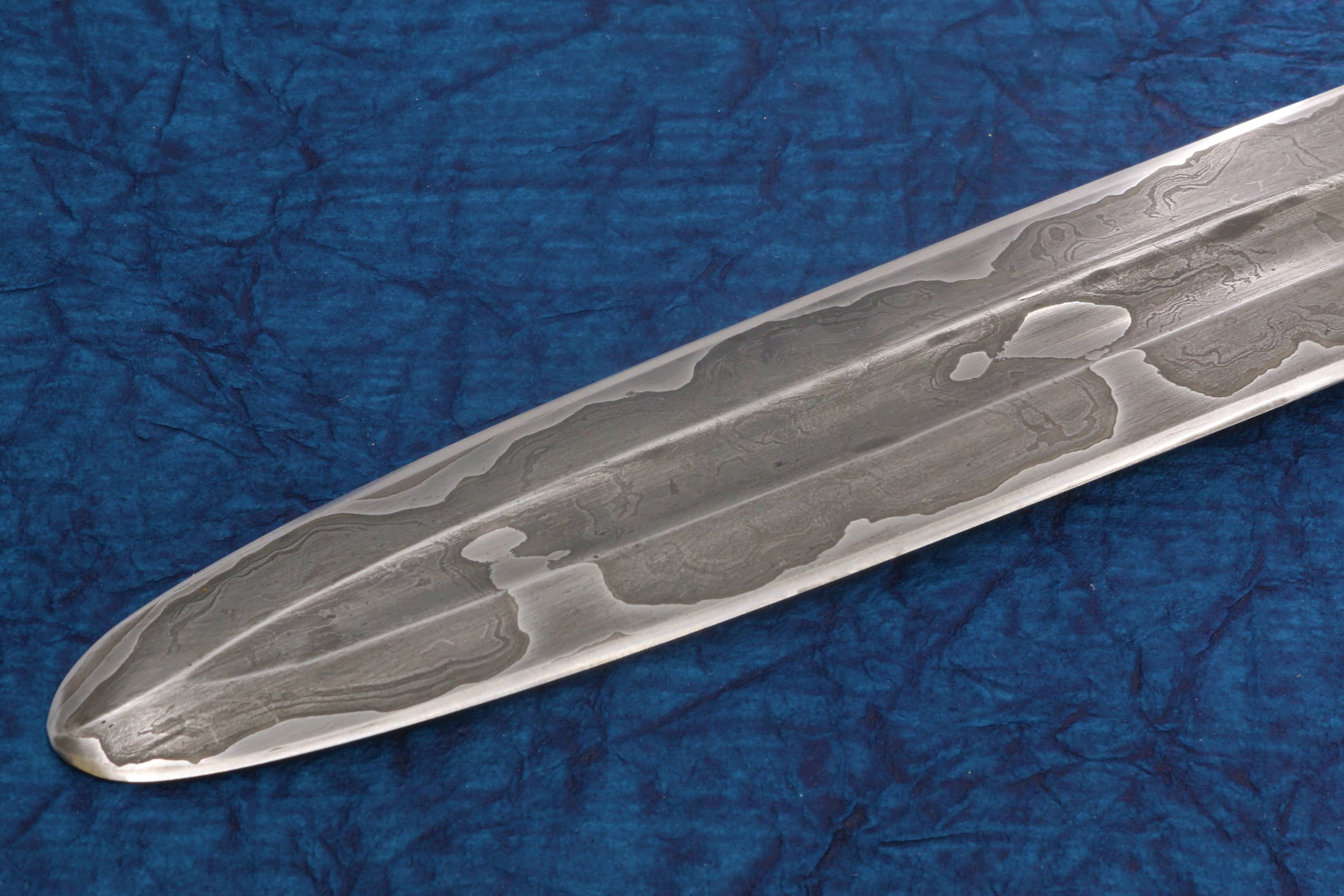

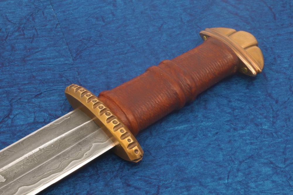

The last piece is just an art piece I did for giggles.  It is sort of a miniature Viking era sword.  The blade is made from a go-mai billet with cable on the outside surfaces to sort of mimic the look of wrought iron.  The fittings were my first attempts at investment casting bronze.
