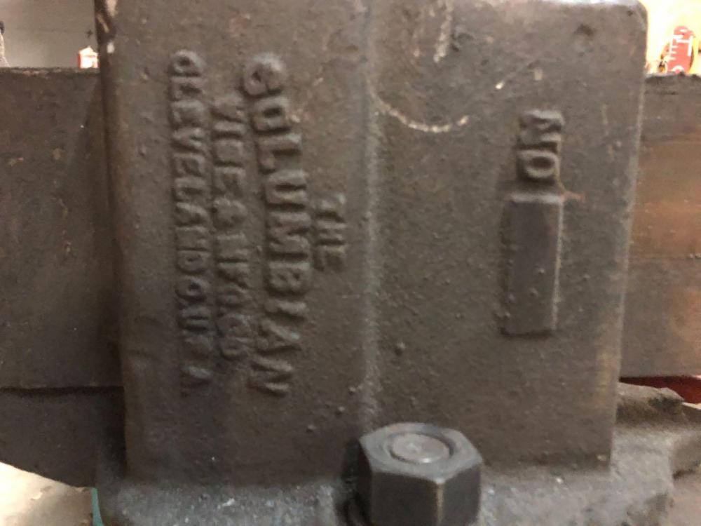

Here you go guys. 8” jaws
8" is the width of the jaw and not the distance it will open? AKA the "throw".
I have a columbian vise that i have owned for 30 plus years that looks identical to that one except that next to the branding is a spot  that could be punched with stamps the model #
Mine has 6" wide jaws.   My guess is that this does also.  If it does have 8" wide jaws send me a PM with your contact info Lavan . My " Little Columbian" has always wanted a BIG brother and you are not to far from me.
I recently sold a Reed 8" bench vise for $1200 if that helps your pricing any.
