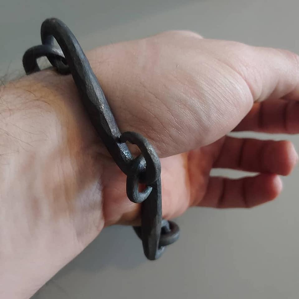

Good Morning Ladies and Gents,   I seem to have run into a dilemma with a few projects I'm currently working on and need some advice.   Had some concept designs that I've been mulling over in my head and finally decided to actually put them into steel.  They came out nicely, the problem is knowing what I can coat them in to keep them from rusting/corroding.   Looking for something that will hold up for a while, but easy to put on finished pieces.  Most of the pieces have moving parts so coating them completely in an Epoxy/Resin would require me to have to coat them previously to assembly,  which may prove difficult.  Anyways, any advice would be great.

I would prefer them to be transparent, trying to preserve the "raw blacken'd steel" look.  but the enamel/paint option is something that slipped my mind.  CP 1&2 Ti I'm going to have to look into for sure, I've been wanting to make camp utensils and such for a while now.

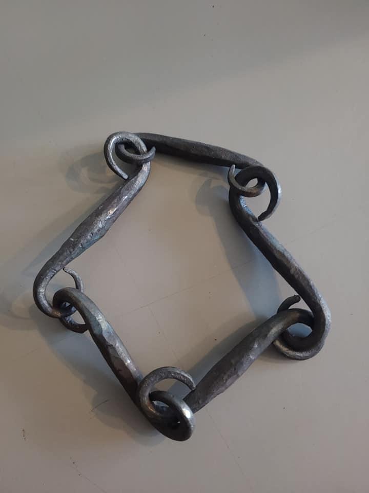

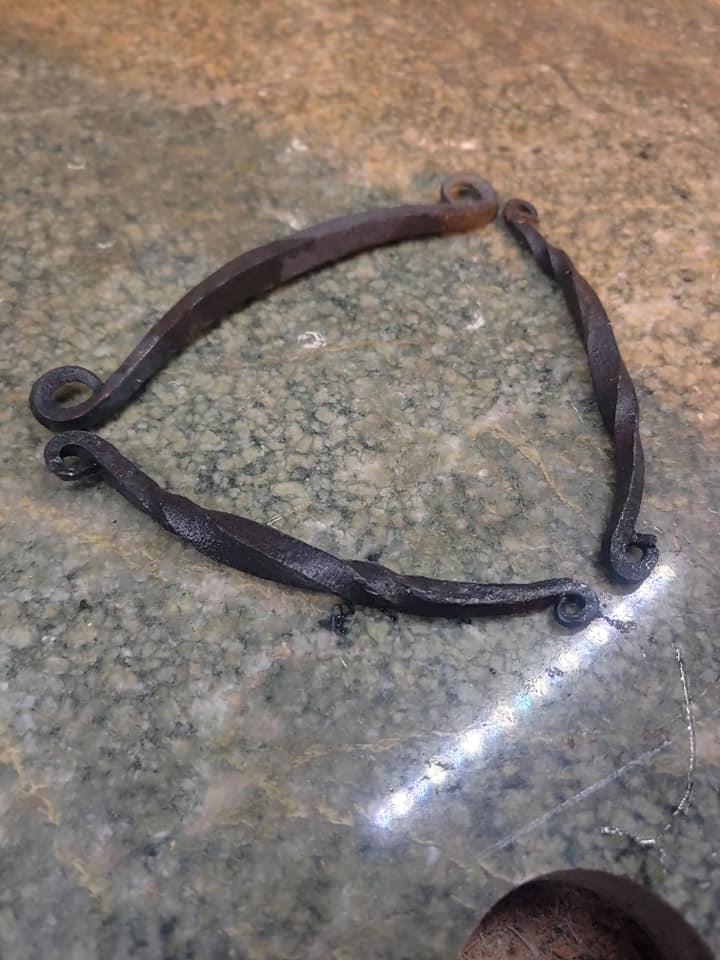

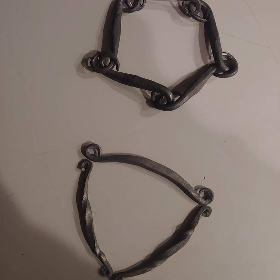

These are the two I have made so far, the three-sided one isn't completely assembled yet.
These are made from some 3/8" Rebar I had lying around.
can't beat a traditional hot oil finish. 50/50 linseed oil and turpentine and beeswax applied hot.
clean with denatured alcohol then at a low temp, rub and buff in beeswax.
