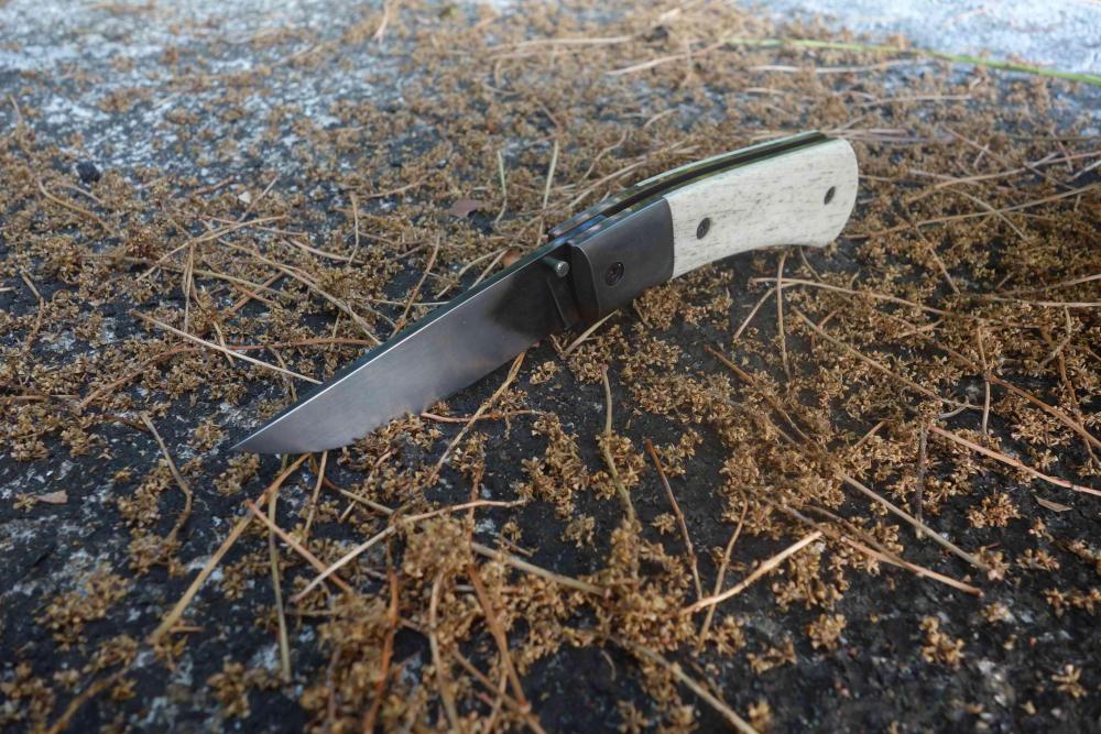

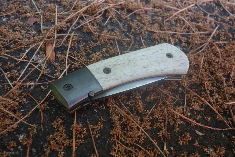

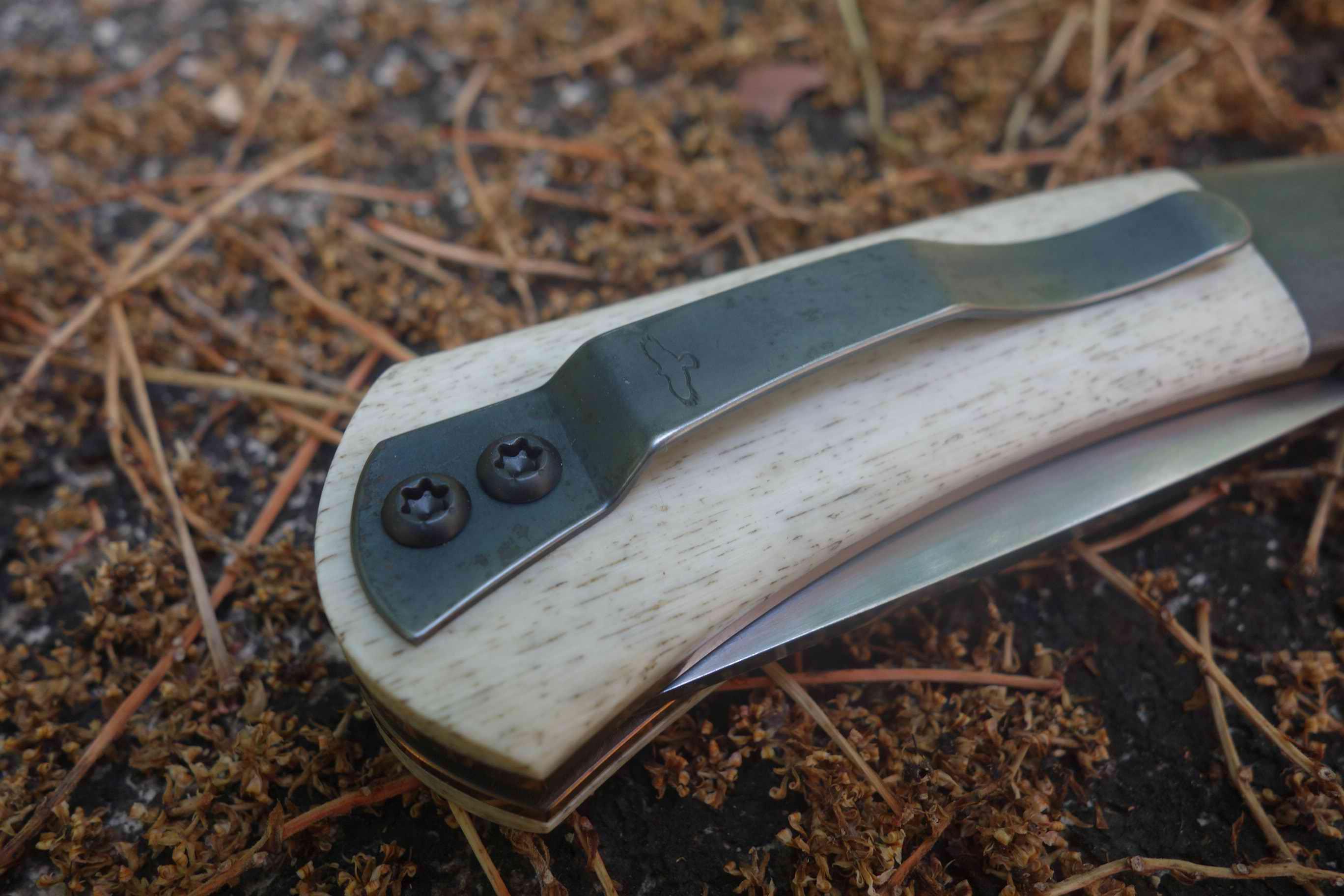

This liner locked folder has a blade forged from TNT triple6, detachable steel bolsters, 6Al4V titanium liners, a  high tempered clip and locking spring from high carbon spring steel(1.1274) and scales made from buffalo bone.The screws are hardened low carbon steel.
Blade measures 83 mm and overall length is 190 mm.
Cheers
Looks awesome! I really like the look of the plain steel with the bone handle.
Beautiful. Lots of work in a little folding knife. As always, I don't think less than perfection could be described in your fit and finish.
Never heard of TNT triple6.
