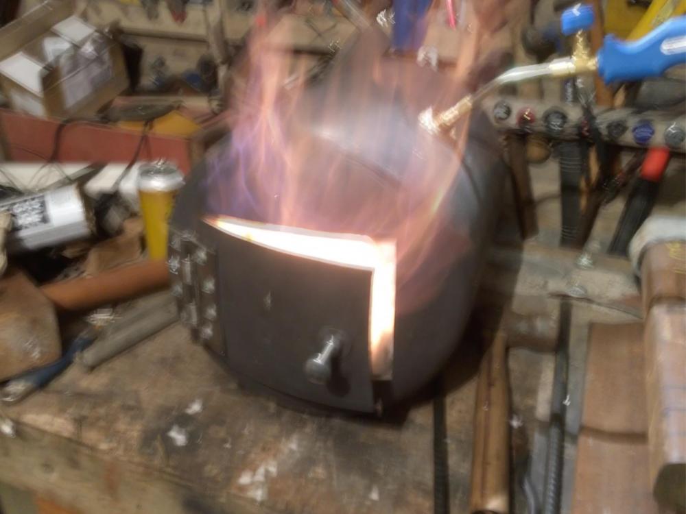

I’ve made a gas bottle forge, and have lined it with ceramic wool, but am trouble finding stabiliser in the UK, can anyone suggest a product?  Even my search results on Amazon are proving fruitless.  Think perhaps I’m using American brand names which aren’t available in the UK.   I’ve of course not waiting and fired it up anyway, wore a mask and had the shed doors wide open.  Still, I know I need something.

I’ll be brave and show my portable set up, anvil, and the results of my first days heating and hammering.  (Added a couple of ‘pre forge’ photos of hooks and one of my horseshoe cowboys.)
Ah, I also learned not to touch the handle I put on the forge door without gloves.  Fortunately we have plenty running water which is very cold in this part of Scotland!

You're going to fit in here just fine. First pull the torch farther out of your forge, the whispy yellow flames means it's not getting enough air to burn cleanly nor as hot as it should. Just the bare tip in the ceramic blanket, the less the better.
Try looking for, "Colloidal silica" if you can't find "Fumed silica". Pottery and fiberglass suppliers usually have it on the shelf for different purposes. You want the kind that mixes easily with water.

The handle on your forge door will be much cooler if it's longer and farther from the shell and if you insulate the door.

Thanks Frosty-will do.  I managed to track down some Colloidal Silicon, had no idea that it was sometimes used in boat repair mixed in with resin. A fairly local chandler who I’ve dealt with many times will deliver. :)  Thanks very much for that tip and although I didn’t get much time at it today I took your advice on moving the torch out, seemed to get hotter quicker and sounded a bit healthier too, the flame was bluer too which judging by posts on here is better.

Point re handle and door taken!  Although won’t be touching it without welding gloves on for a while!
