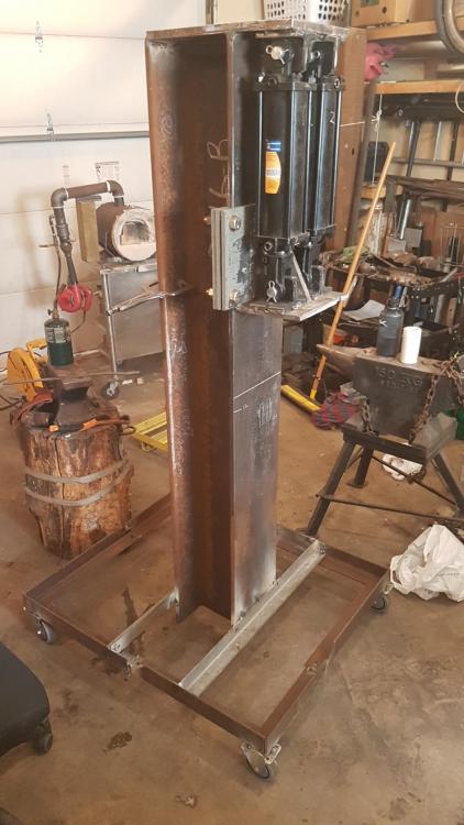

Hello everybody oh, it's been a very long time since I've posted. I just wanted to have a share of my press progress so far. I opted for a 5 inch cylinder with a 12 inch stroke powered by + 11 + 3 gallon a minute pump. I have a 3 horse electric motor that runs on 220 to go with it. I've seen and heard mixed things about whether or not that much power will be adequate but I figure worst case scenario I buy a larger motor to get me up to 3000 psi instead of 2000. These are a couple pictures where I'm at. Just need to clean everything up and prepare it for welds.

Are those both 5" rams? How are you equalizing flow and psi? That'll be pushing 40 sq/in, what do you have for a pump? It's going to be fluid hungry to get any speed but once it starts to squeeze it's going to be a brute.

Looking good, I can't see anything I don't think will work.

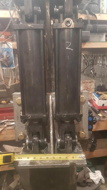

The 3.5 cylinder is going to want to bend the press towards the 3" cylinder.  1/2" may not sound like much but it's not just a 1/2 sq in difference, it's significant. 7sq/in. vs 9.62sq/in. If your pump develops a measly 10,000 psi that means the larger ram is pushing with 26,200lbs more force on that side!
A twin cylinder press MUST have matched cylinders. It's a rule, honest it is.
