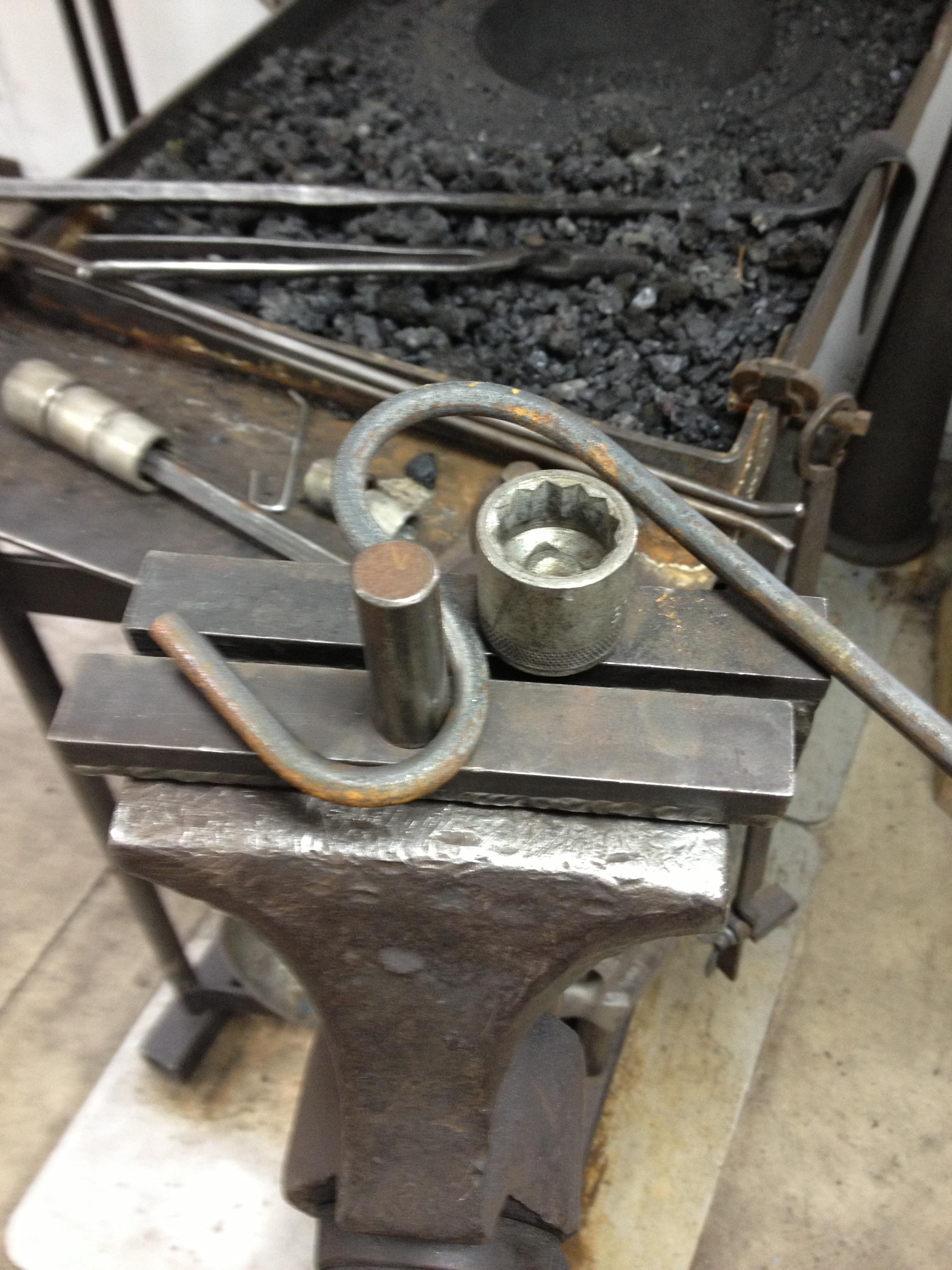

Hi,
  There was a picture (I think on Pinterest) of a bar bender for the vice that used a socket and a bolt holding it to a hex bar in a vice.  I thought there must be a easier to use tool. This is what I came up with and I had an extra socket set to use with it and keep out in the shed. I used old drills for the pins that can take a beating (1/4" and 5/16"). I cut a old 3/8" socket extension off with an abrasive wheel, smoothed it up and pounded it in a drilled hole that was a jamb fit. That let me change sockets in seconds. I could have epoxied it but so far dont need to.

Those are quick and easy to make and are very useful tools. Dies are inexpensive and come in a full set of sizes, metric or imperial.

           Yet another way to make a bending tool.. This way you just make the adjustments pinching the tool in the vise. Been using it for years. Easy to make..
Jim
Diacro and Hossfeld are the two big names in Benders; still available new and with lots of dies for them.  All out of patent date and so a number of copycats are out there---lately HF has been selling hossfeld knockoffs
