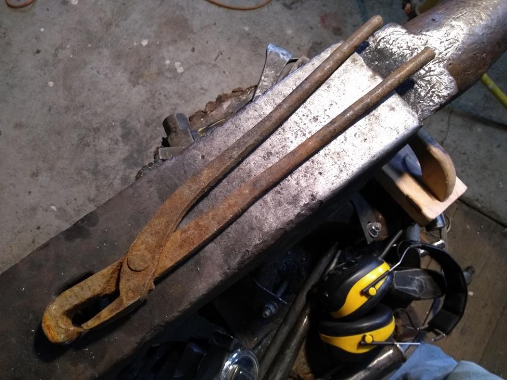

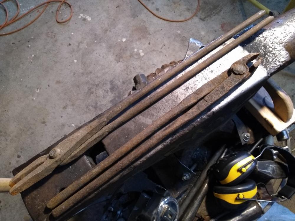

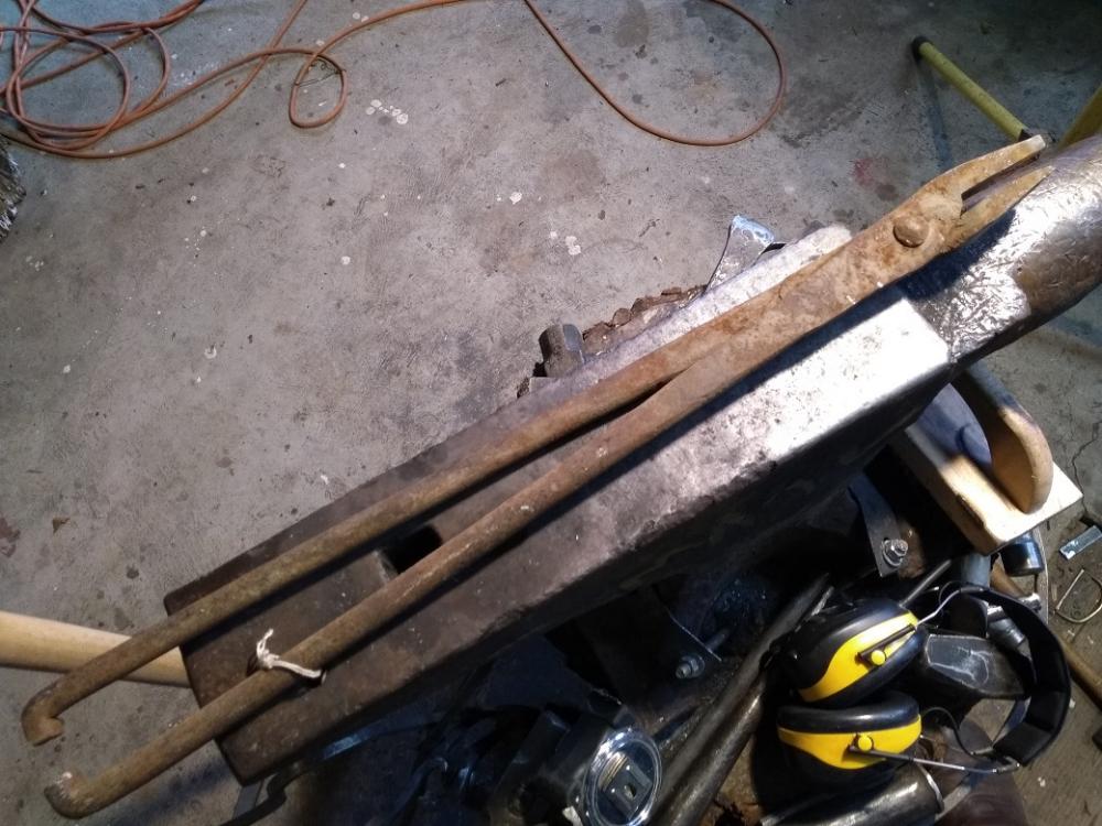

MotoMike Posted April 21, 2018 Share Posted April 21, 2018 A friend of mine gave me 4 sets of tongs today. One of them is quite large and heavy. probably more than I can get in my forge. the others will likely be useful. They show sings of being blacksmith made I think 3 of them have had the reins forge welded on. What is the intended function of the set with one hooked jaw? Quote Link to comment Share on other sites More sharing options...
Charles R. Stevens Posted April 21, 2018 Share Posted April 21, 2018 Pans more than likely. Think about picking up an open tuna can... Quote Link to comment Share on other sites More sharing options...

jlpservicesinc Posted May 4, 2018 Share Posted May 4, 2018 hook jaw is a pipe tong.. For use like a pipe wrench.. Some came in adjustable sizes.. Quote Link to comment Share on other sites More sharing options...
Irondragon Forge ClayWorks Posted May 5, 2018 Share Posted May 5, 2018 21 hours ago, jlpservicesinc said: hook jaw is a pipe tong.. Yep... I have several pair of them, easy to modify the hook jaw to fit whatever you want. Quote Link to comment Share on other sites More sharing options...
