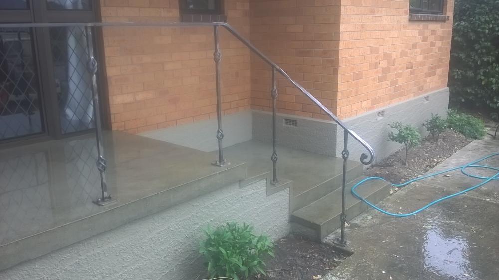

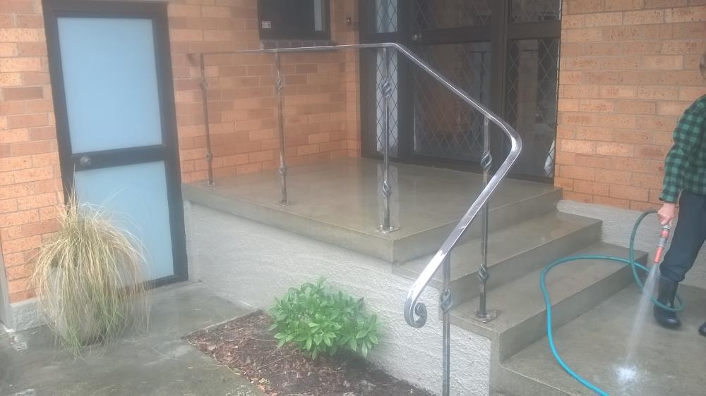

I have just finished some handrails made out of solid barstock for my mother

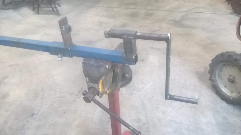

can you post a few pictures of your twisting rig ?   Thanks
Its very low tech and needs to have a better way of holding the two sockets so they are easier to change but this keeps the twist even and inline with the center line of the work piece Chers Beaver
