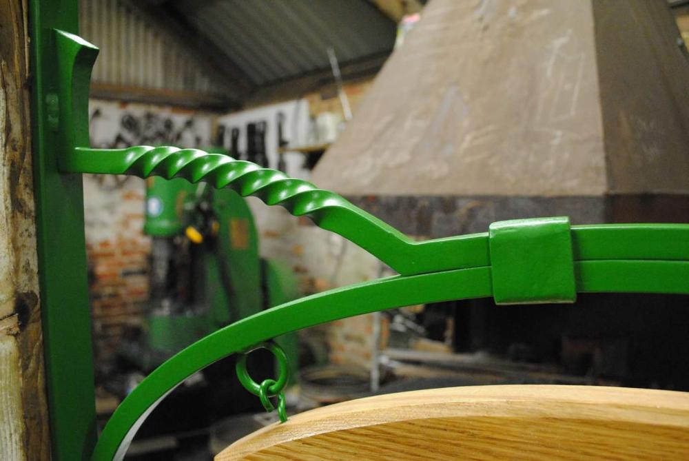

My hope for this thread is that folks will post pictures of their ironwork that has a colourful paint finish, (not black) with specific paint colour codes or paint name information.
Please only post pictures of colourful work if you know the colour information.
Folks will have to bare in mind that cameras & computers all have different colour biases, so this is a thread for folks to simply get inspiration for colours that they may want to investigate further & use on their own work.
I'll get the ball rolling; this is RAL 6002 "Leaf Green" on a sign bracket I'm waiting to install.FB_IMG_1509902740595.thumb.jpg.3f4597a445e43e46299639fc8576387e.jpg

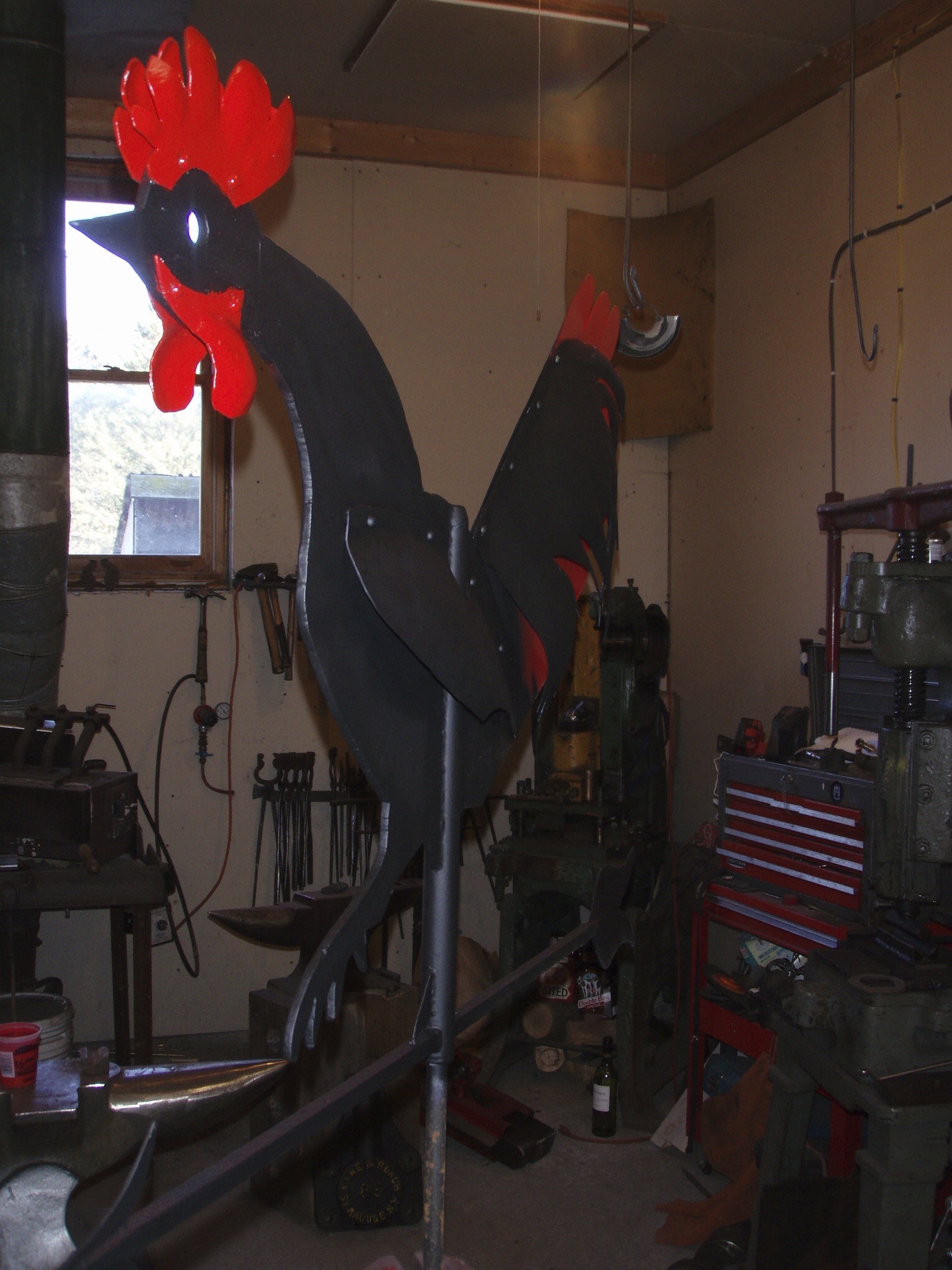

A splash of something other than black can really make something pop.  Here is my example.  Sandblasted and zinc solids primer before asembly, then etching primer, 2 part epoxy black base, Rustoleum gloss red.
