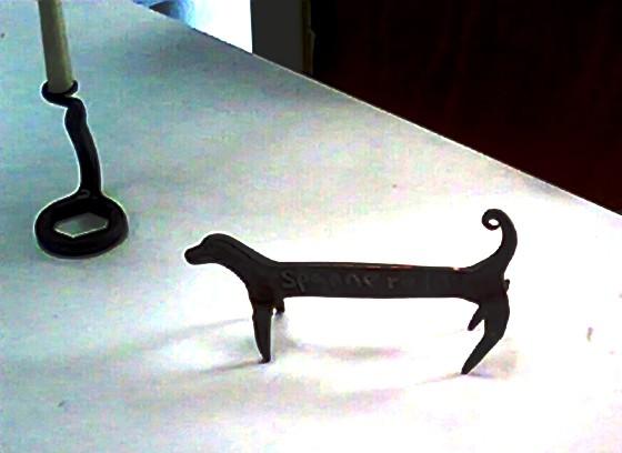

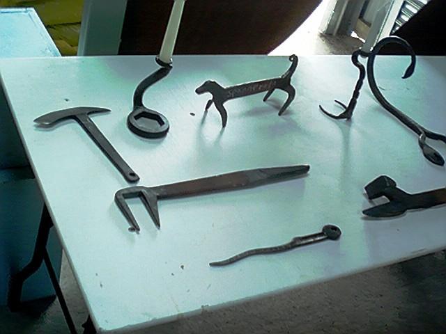

We Had a weekend playing with old spanners back in 2004, sorry about the picture quality.
This one started aas a single ended spanner, and  finished as a Twybil, used for making willow hurdles for fences or animal pens
A selection of the items made
An large ring spanner made int a candleholder, and a double open ended one made into mini bootscraper.
Found a great difference in materials used when the spanners were made.
