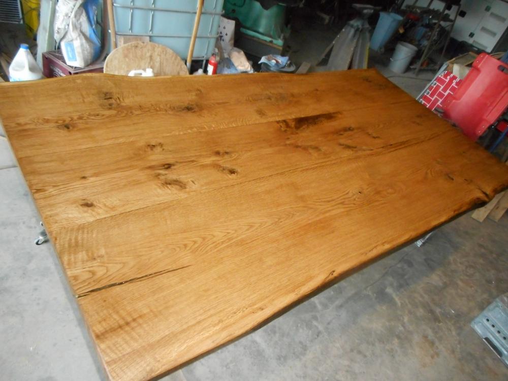

The dining room table is finally finished.  It is 4 X 8 and started out as 2" thick, but after all the planing and sanding it is finally 1 1/2" thick.  The frame is 1 1/2" square tube, the legs are 2" square tube, distressed under the power hammer and the quarter braces are 3/4" square bar, forged to octagonal and twisted.  The leg wrappings are 42" of 1/4" round rod, tapered on both ends.  One 3" HF planer died, plus quite a few sanding belts and sheets.  The metal finish is wire-brushed, then sprayed with Rustoleum Clear Satin enamel.  The wood finish is Minwax Golden Oak stain and 2 coats of water-based polyurethane.  The old guy on the table is NOT Burt Reynolds !!
Really good looking table! And one happy looking Reynolds ;)
