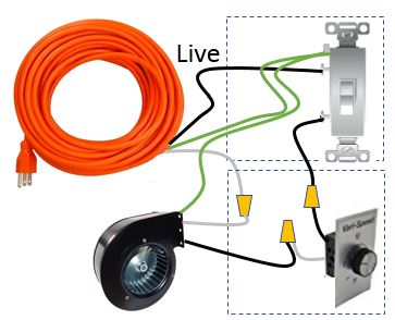

June 1, 20179 yr Nice. +1 on having the on/off switch in front of the speed control; my variac came that way, and it's great.

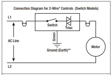

June 1, 20179 yr Author Absolutely - safety first. I would not want to cause any issue for anyone and will change the wiring diagram as you suggested and repost the document with edits. I'll also add the addition of a screen to the blower. THANK YOU GUYS. I have made edits and re-posted HERE. (I cant see how to change the original post). Please use this version ! Scrambler82 -- I'm not an electrician and would appreciate you checking this wiring diagram. Building a Portable Coal Forge from a BBQ - Tony Fenn.pdf

June 2, 20179 yr Author Hi Scrambler82 First to hopefully put the wiring to bed I have corrected the wiring as you pointed out and then attached two images here, one being what comes with the speed controller. I mounted the fan on top so I can see if it is running. It is very quiet, especially at low speeds, so I think it is better to see it moving. But thats the only reason. I'm sure others will modify as they need. Another question from someone was about using a manual blower, and of course one could be substituted. I found it hard to locate a manual blower. I bought the electric blower on advise from my teacher and mentor Trez Cole (Nokomis forge) who has used the same. I must admit I think its really good. I have actually being using anthracite coal and love that the blower at low speed keeps the coal at a nice steady burn. Cheers - Tony
