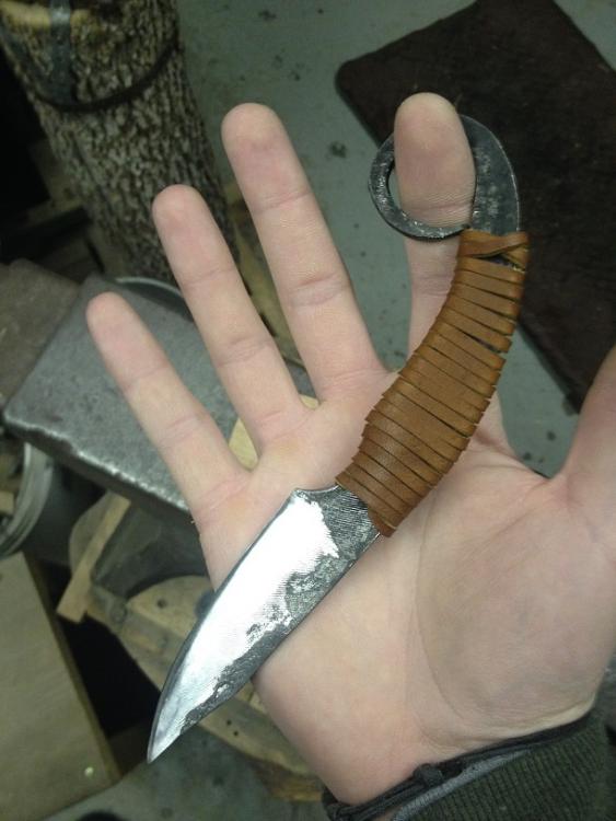

My First File Knife
Here is a pic of my first file knife. I was successful in hardening it and now just need to sharpen and clean it up.
Nice looking profile. How thick was the file to begin with, or how much hammering did you have to do to get it to the finished thickness? And what did you use to quench it with?
Thanks guys!
John: With regards to thickness I only had to hammer down the bevels, the spine is original thickness, I'd say its around 1/8" and I quenched it in fresh motor oil.
Theo: I'm going the K.I.S.S. route, just some leather lace. It already has excellent hand feel, I just need a little more thickness.
Thanks again for the great feedback!

Nice looking knife! Did you grind off all the teeth of the file before forging?
Thanks Charcold! No I did not grind off the teeth, I just went at it.
Nice... The handle shape looks great, must feel super secure in hand with the way it wraps around
Thanks! It does have a nice hand feel, I think it will improve once I finish it too, I still need to wrap the handle and put an edge on it. I shut down the smithy for a bit while I build my next forge over the winter......and the ol' lady wants a few of her wood projects finished, so more work, less play.

I've finally finished grinding, polishing and wrapping the handle; other than a sheath, this baby is done!
Comments, questions or critiques welcome!
