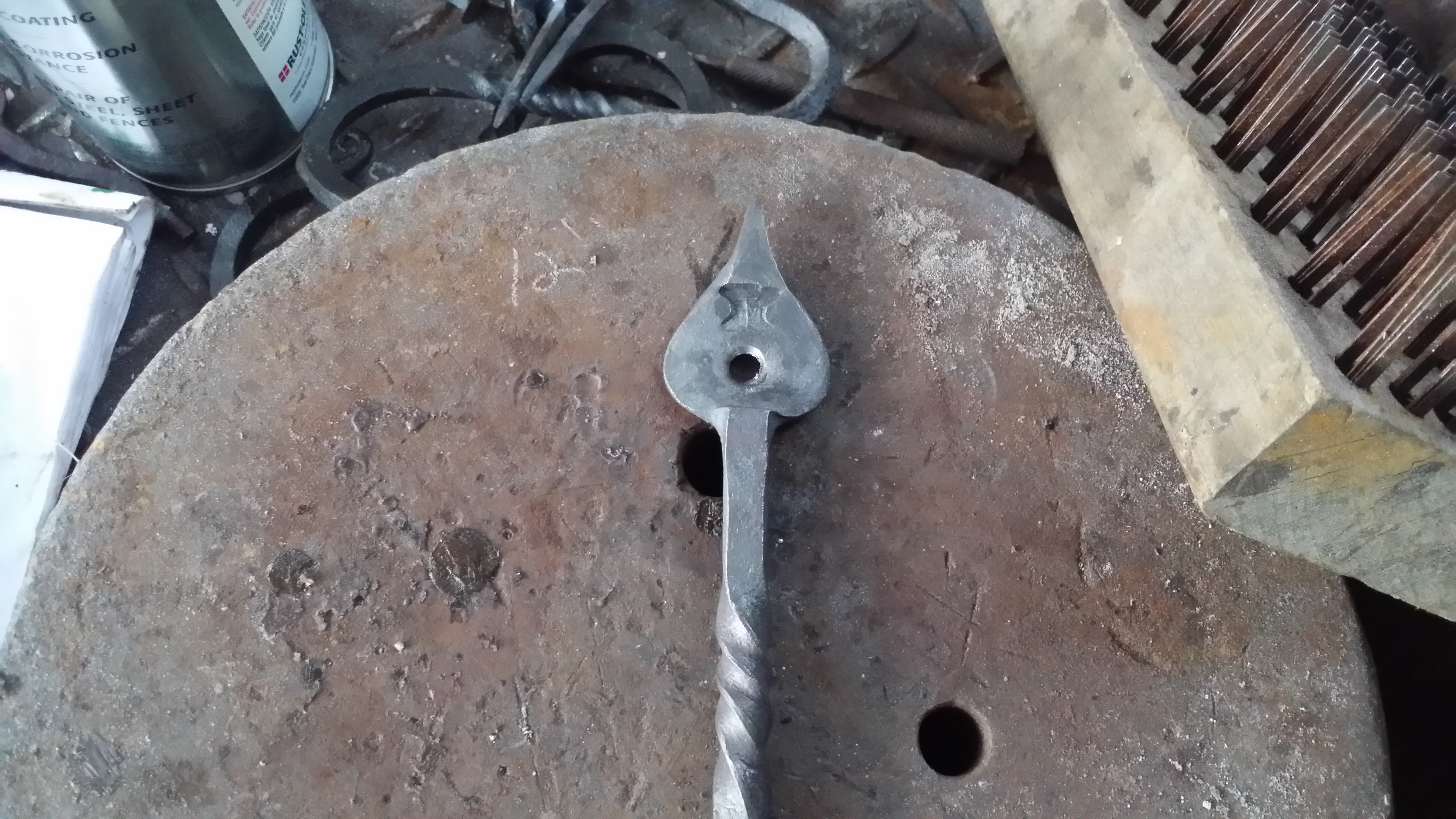

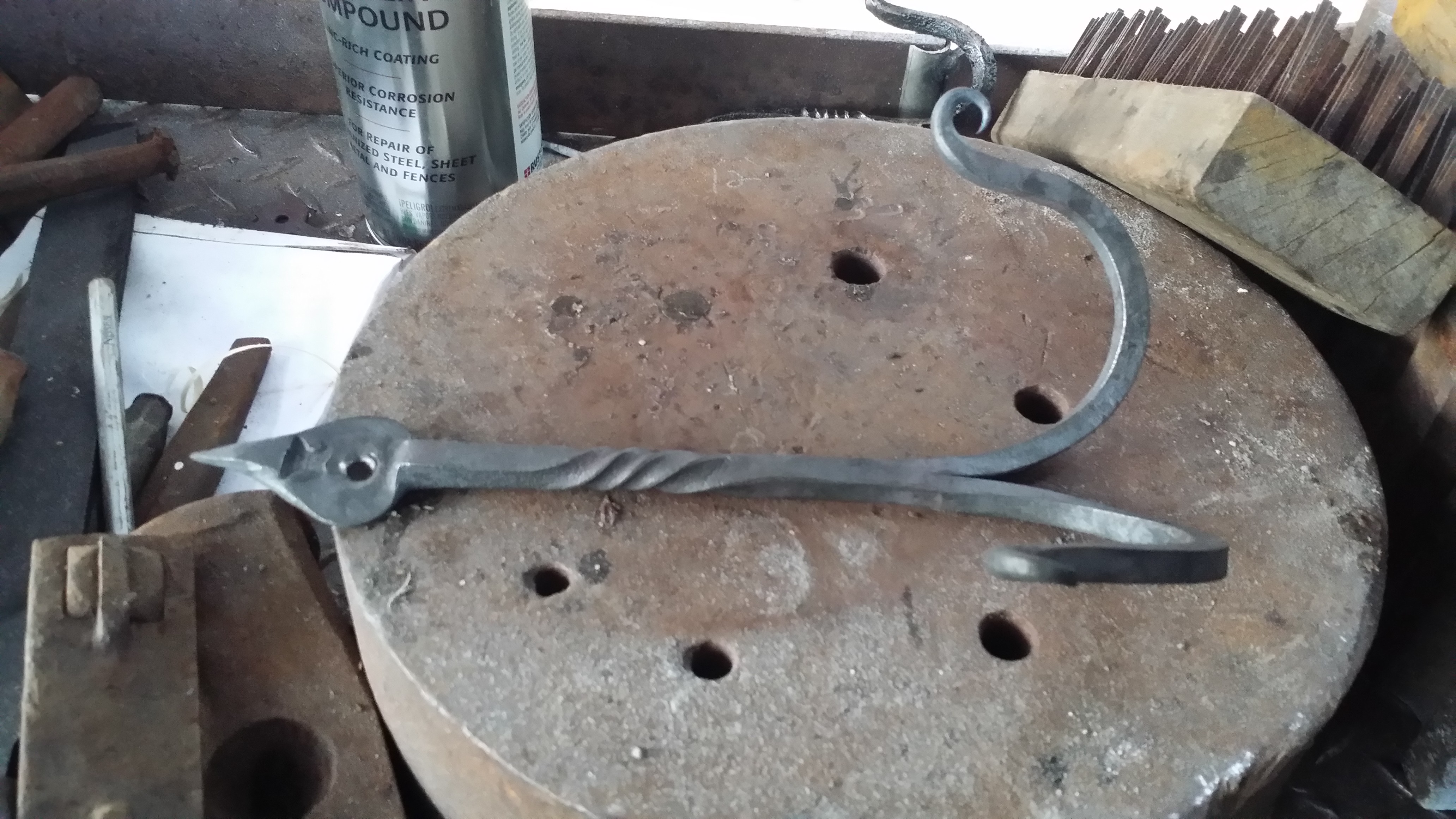

Had to test out some new welding flux..Made this from 3/8sq and 1/4" sq..
Few S hooks and nails thrown in for the fun of it..
Test looks successful to me. Nice wall hook. Does it hang straight on the single screw with say one heavy coat on one side? I like the looks of a single screw but they tend to go a little shifty on me.
If you didnt say it was forge welded I wouldnt know. Nice work. hope I can forge weld as well one day.

to correct this it just get another nail in the crotch at the split..  there is another nail under the group of S hooks..
Yes it was successful.. Thank..
