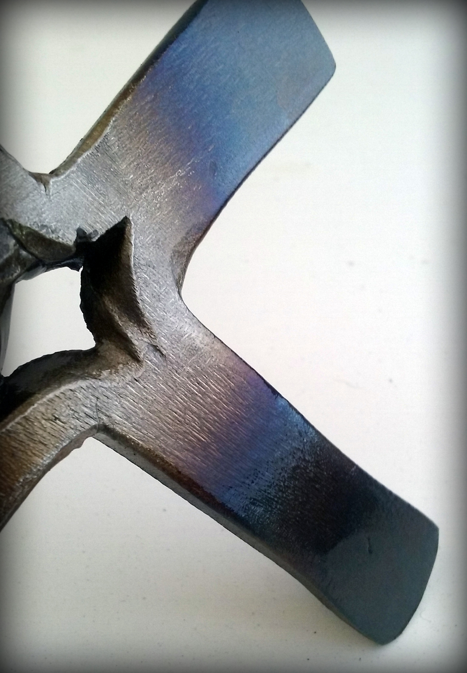

HEAP of JEEP Posted July 16, 2016 Share Posted July 16, 2016 Still trying to come up with some cool ideas for my first craft show in a couple of weeks. Played around with a spike last night. Saw this idea when I was googling spike ideas, and decided to give it shot. Took longer than I wanted but I think I can get them done quicker on future ones. Quote Link to comment Share on other sites More sharing options...

DSW Posted July 17, 2016 Share Posted July 17, 2016 I like it. I'd love to see picts of where and how you cut the spike if you make another one. Quote Link to comment Share on other sites More sharing options...
rthibeau Posted July 17, 2016 Share Posted July 17, 2016 I like the heat colors still on it.....nice work Quote Link to comment Share on other sites More sharing options...
Frosty Posted July 17, 2016 Share Posted July 17, 2016 It could use texture, I like wood grain myself, it's supposed to be a rugged cross. I'd ease up on the heat to let the colors run more evenly. Running from unheated to blue says the torch was too close, I'd use a softer flame. I also like a little more finial on the ends, splitting and scrolling flat looks nice as does a lateral draw though not so much. Making it stand on the head is a good feature though it'll still be tippy and being steel could do real damage if it fell off a top shelf or mantel on a foot, head or something fragile. NO, I haven't figured out a wide base I like, though a small mound shaped base can represent Golgotha. Still . . . That's just me though. Really nice job on the crucifix, well done. Frosty The Lucky. Quote Link to comment Share on other sites More sharing options...
HEAP of JEEP Posted July 18, 2016 Author Share Posted July 18, 2016 On 7/16/2016 at 10:26 PM, DSW said: I like it. I'd love to see picts of where and how you cut the spike if you make another one. I forged up another and ran video of it. Don't know if I showed everything, but it gives the general idea. Don't know the rules on posting video links, so I don't do it, but you can find it on my youtube channel under HoJ Forge or I can private message you the link. Quote Link to comment Share on other sites More sharing options...
DSW Posted July 18, 2016 Share Posted July 18, 2016 I found the video. Now things make more sense. Thanks. Quote Link to comment Share on other sites More sharing options...
