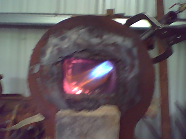

The first pic is my first NA forge. It's about 500cu/in with a hard inner liner and 1" kaowool outer liner, no kiln wash. I built it a little better than 25 years ago. This is my first functioning and reasonably tuned T burner. It's a 1" T and running pretty rich in this pic. See how the flame is pale and pretty opaque? That's not bad it's short but you can see orange IN the forge, that's unburned fuel in an atmosphere with on free oxy. This old pipe forge is seriously over gunned and easily melted steel if you didn't keep an eye on it. It's not up to temp in the pic it's just been lit.
