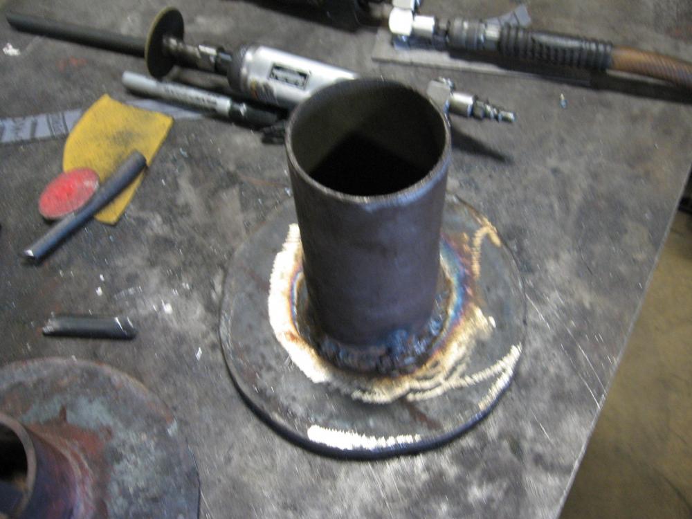

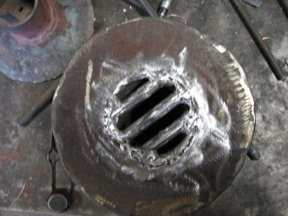

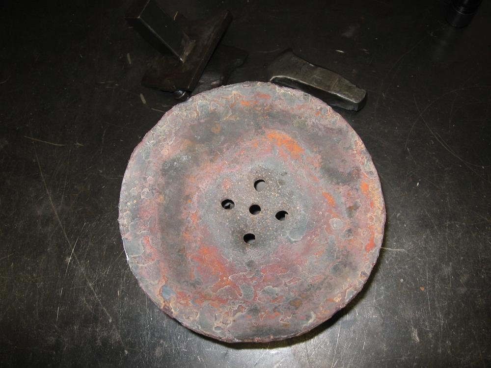

SReynolds Posted March 22, 2016 Share Posted March 22, 2016 Real tired of punching out these holes in the large masonry forge. It will get plenty hot to weld when the holes are free, but they seldom are. Lots of punching. Time and again. The fellow prior to me build this for the historical society and I thought it was a mathematical science to design a tuyere. CFM and size of fire pot, the size of the bellows and the counter weight etc. etc.all had to coincide with one another. I have used this large forge for years and had enough. The bottom of the fire pot is 8.5 inches and is eight inches deep. About 18 inches across at the top. There are four 3/8 inch holes in original tuyere. 1/4" steel plate and very badly warped. Inlet to tuyere from bellows is 3 inch pipe. New fire pot base is 1/2 inch steel plate with 1/2 inch steel stock welded inside the 3 inch hole Quote Link to comment Share on other sites More sharing options...

SReynolds Posted March 22, 2016 Author Share Posted March 22, 2016 I didn't attend college to study forge design and function but I can tell you the old tuyere don't function well. The worst aspect of the old is the 2.5 inch pipe fits inside a 3 inch pipe. Thusly, as the four holes plug the air is now routed AROUND the firepot. My small rivet forges won't plug up like that as they have much larger holes. Enter my new designed tuyere for the large masonry forge. It will initially be experimental. if it works as well as I hope; it remains. Quote Link to comment Share on other sites More sharing options...

SReynolds Posted April 3, 2016 Author Share Posted April 3, 2016 Report on this new tuyere design. It's like this. The last smith who was quite obviously experienced, designed the tuyere I have used for the past six full years after he left the organization. I figured this is how a forge works; crappy. No or little air. Fight to aquire heat. Frustration. Agrivation. But yet tuyere assemblies I have designed for two rivet forges works well. Tons of air. Loads of heat. Satisfaction. So I have to wonder what this other smith was smoking. 6" deep fire pot. 9" across the bottom. 18" across the top and he makes a tuyere with four 3/8 holes. This newly designed tuyere is so fantastic. .....so user friendly. ...so efficient. ....so effective I am worn out from smiling all day. I had to put my free hand in my coat pocket to keep from waving at the visitors. I used it for 7 hours today. I think I'm going to patent this application. I need a nap. Quote Link to comment Share on other sites More sharing options...
