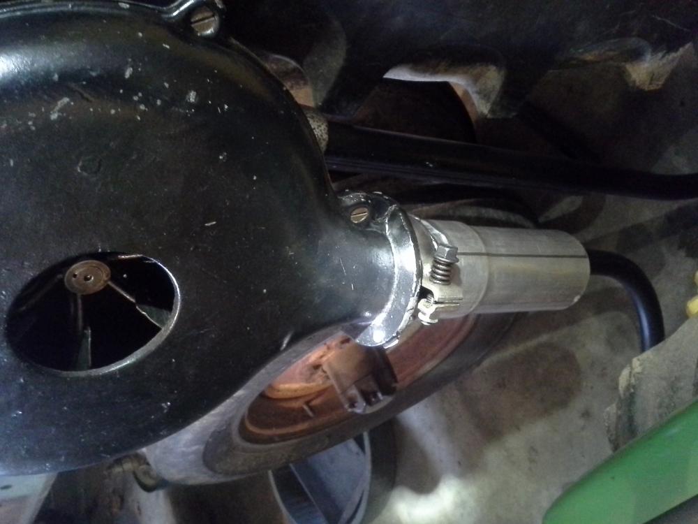

I became tired of looking at folk's blower pipe held together with duct tape and decided to offer ready made adapters for champion 400 blowers.
Never could figure why folks will have a shop/forge/blower and make/sell all sorts of items and yet retain the blower pipe to blower with duct tape. But as Kermit the Frog would say; "that isn't any of my business"
Other models coming soon such as the Canedy Otto.

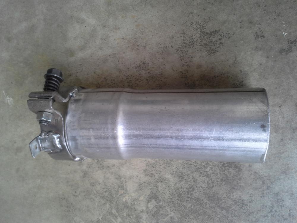

Champion 400 adapter is three inch pipe outside dia. The outlet of the blower is 3 1/8 outside dia. AND tapered. Probably because they didn't want folks employing some rinky dink hog podge of a blower pipe. Had to buy the factory stuff.
So anyhow. .....this is the cat's meow.  It is going to the patent office.
So I visit this historical village and they got this nice blacksmith shop. And naturally the blower pipe is held on with duct tape. . . . . . .
Looks like it will do the job, nice work. What's the purpose of the little dog-leg bracket? Is there a tapped hole in the blower flange? (Might have to pull the duct tape off mine to see.)
Sorry. You reminded me I forgot to post another pic.
The flange of blower outlet has room to drill holes. One hole "may" be from original pipe. I don't know. I could have made a complete flange but two little pieces of angle iron do same job.
I don't intend to poke fun at blacksmiths making all sorts of items while at same time employing duct tape. Ok. I guess I do. But my point is "there is a better i. e. More professional way" and coat hanger isn't it. Yeah. You know who you are. But as Kermit the Frog says. . . . .
The spring loaded clamp makes this adapter adjustable.  The competition's clamp isn't.
Ok.......there isn't any competition. But knocking down the competition sounds cool.
This is the original set-up and it clearly demonstrates a clamp on the outlet just under the flange. Not sure how it all fits together but the other pipe(s) have a clamp and a flange as well.

You can buy essentially the same thing ready made at a muffler shop that handles semis. The shop will have drops and will flare or swage it to fit for not much. You can slit the end with a hack saw and use a muffler clamp. It's where I got the exhaust pipe I used to make the tuyere and ash dump for my coal forge.
