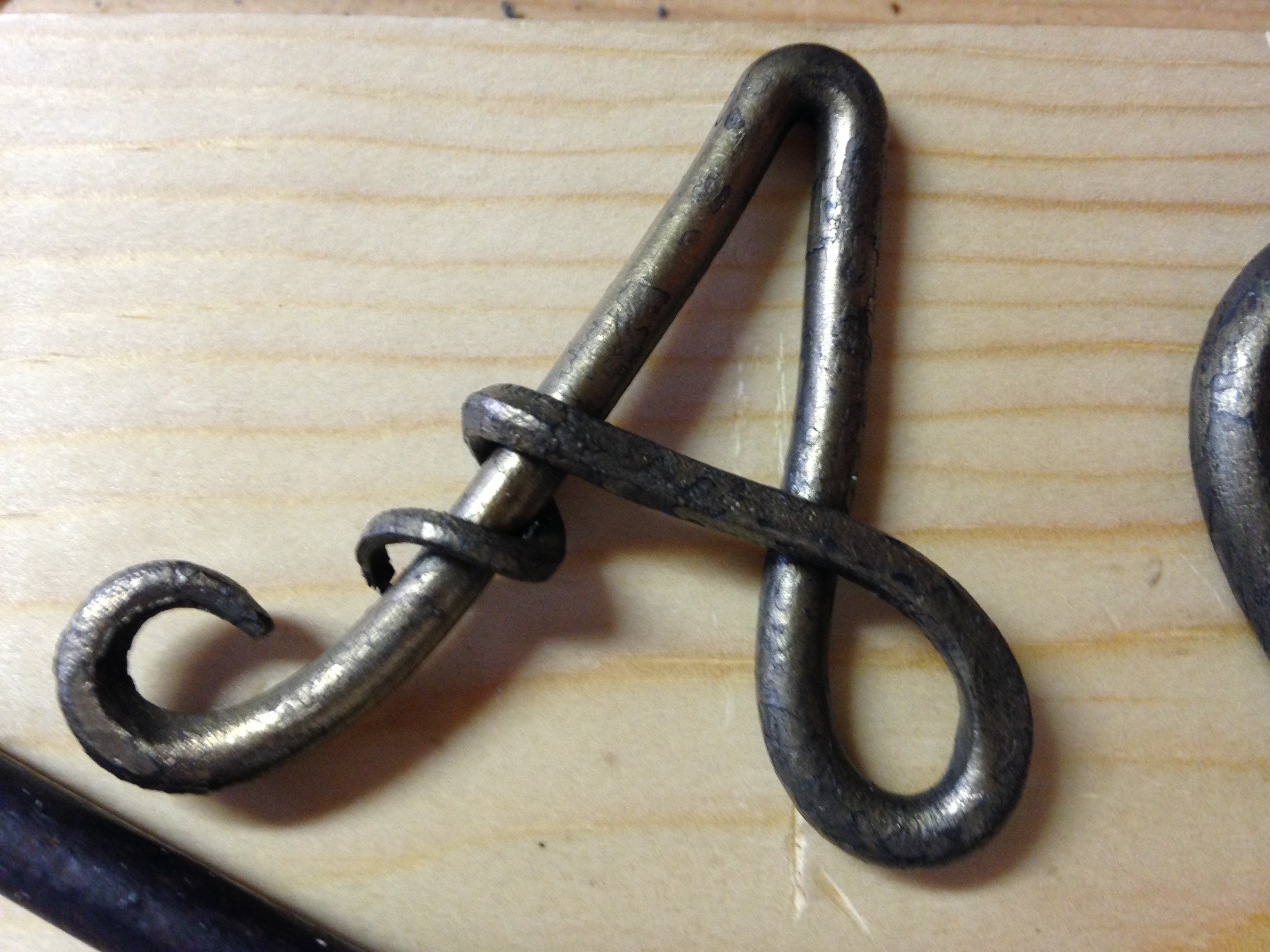

Marcy, I feel your pain, literally.  When I first started I began with only the small stuff, like initials (attached).  My own trial and error figured out the best way for me at least was to make a quick jig.  At the time I just use what I had, a piece of wood and some screws as posts to do the wraps.  Later I bought a small bending jig that fits in my hardy hole with its own pegs, just right for these small pieces.  It helped to take some thick soldering wire (a trick I learned from one of my blacksmith friends) and fiddle with the best way to create, wrap it in wire before attempting it with steel - I'm a visual learner, I needed to see the process and get my head around which end to start with.  Hope any of that makes sense?  The small stuff is indeed a challenge.
