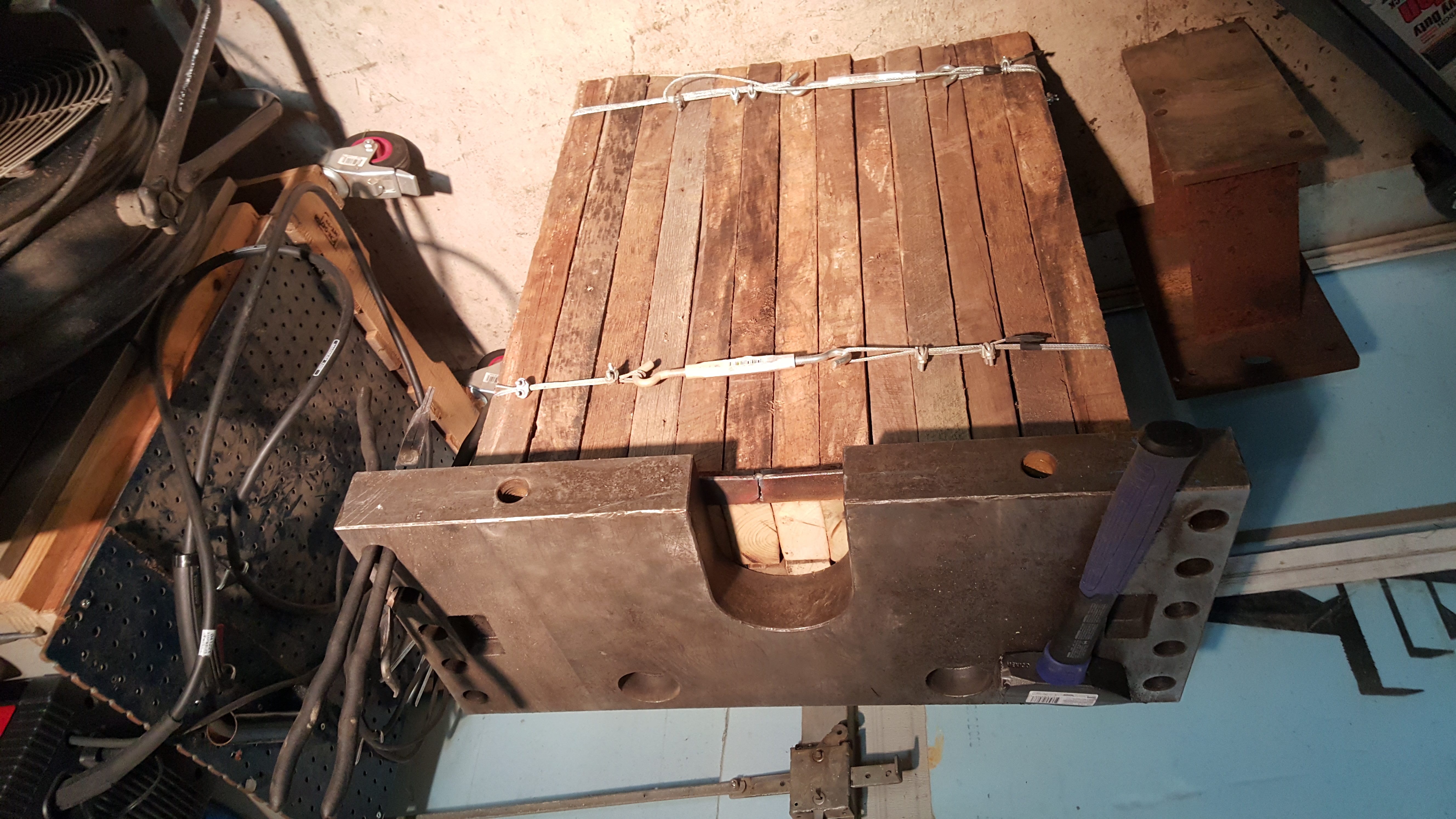

My homegrown non-anvil shaped object is done!
I was planning on making a ledge on one side later. Your first reply to the original pick really got me thinking of all the options for this baby. Thanks for the input.  I was testing the height and it was rebounding great. Can't imagine when I sit it on edge
No end of possibles with those "design features". As for a vice, I think I would be looking at a stepped jaw set up, using those edge holes as "jaw hardies". front jaw needs only a short screw as the rear jaw could be stepped along the rest of the holes, even across to the other side for if needed!  Such a ice could be made to take signficant punisment and overhang the edge for location and tall pieces.
p.s. please be aware if your magnetic hammer gets warm it may fall off the anvil!
