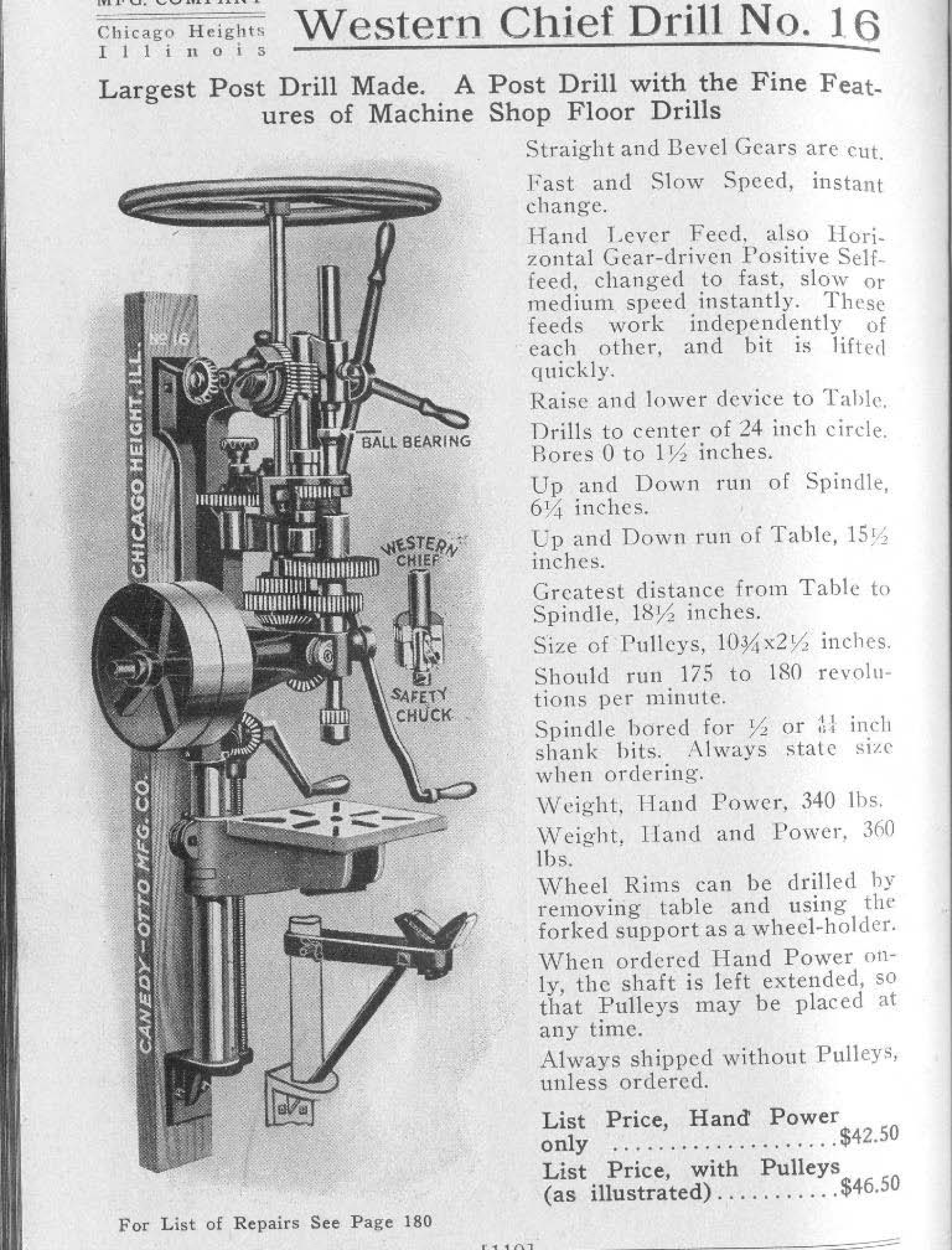

notownkid Posted January 3, 2016 Share Posted January 3, 2016 I don't know about "being Fine" but it will work I would think but it's got to continue to wear if it isn't running straight. Something has worn that's for sure. I have a large chenay otto drill press setting on a pallet in my shop in pieces that needs restoration and I hope to get time sometime to do it and mount it in my mechanical shop. This has wetted my appetite but winter in Vermont isn't a good time to tackle this. This what it is suppose to look like, mine doesn't at the moment. It was headed to salvage when the guy offered it to me, My wife said you can't let that go to junk so to save it I said Oh Sure no problem. Last time in the shop she said You haven't got that done yet!!!! Some wise guy once said women and children should not see unfinished work. You will note in the picture it says ball bearing with an arrow Quote Link to comment Share on other sites More sharing options...
