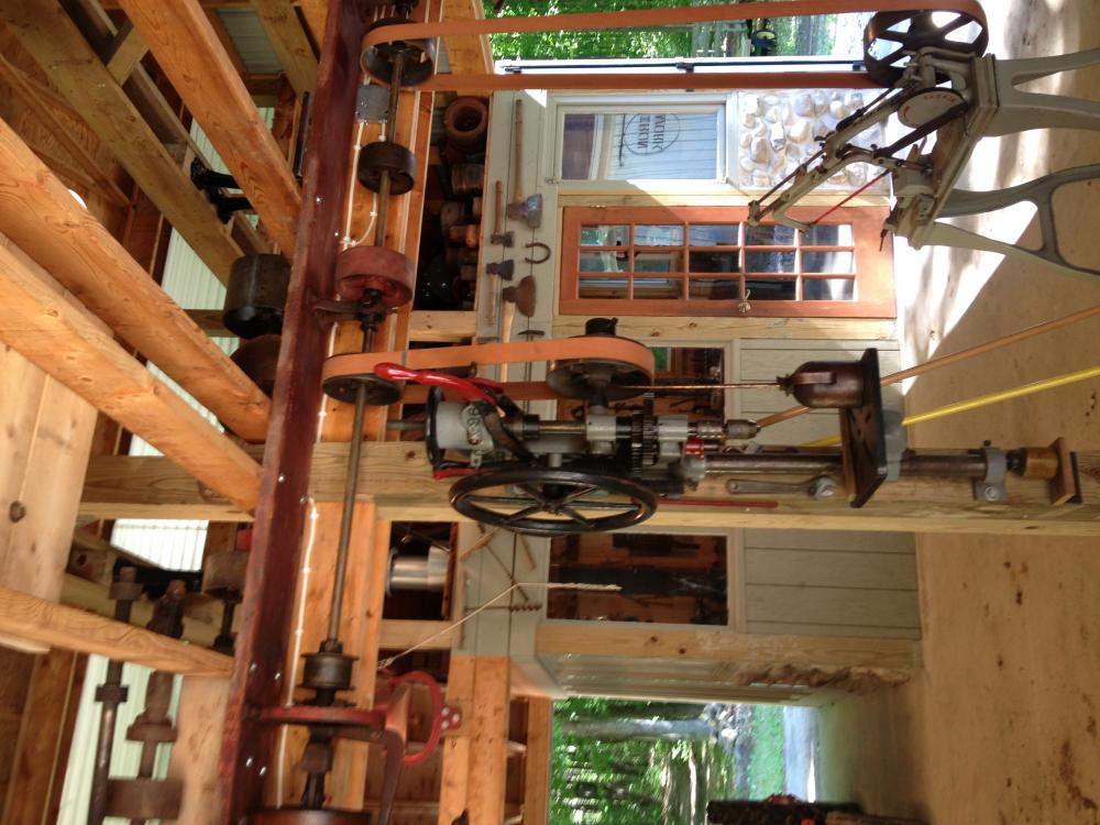

Greetings Tony,
I have several post drills . They are fun to restore and use. It's hard to tell all problems by your pictures but I was able to pick out a few things..
Lower table support missing from the shaft.
Crank handle not original but easy to make.
Still worth 75 to 100
Have fun
Forge on and mak beautiful things
Jim
Thank-you for that information, Jim. Your shop is beautiful!
I would make sure you check the bearings. I don't think the flywheel with the belt groove is original. When these are used with an electric motor they wear out much faster. All of the ones I have scene which were converted to use a motor had worn out quill bearings to be of much use.
