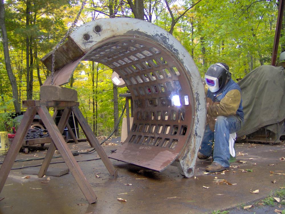

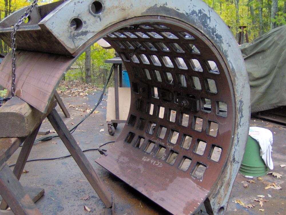

Big time sneaky lurker here.               Regarding Hardox 450 /500   and AR 450
 Twice a year I have a job welding in a wear plate in  to a "grate".     I use  1/16   TM 771 wire shielded with co2.  Lincoln sells the same thing only better called Ultra core 712C.
If its cold out, and it almost is all the time,, I pre heat as  hot as i can get this big lump with a 2'' propane torch and weld .   The welds (every 4inches) keeps the whole thing sort of warm.   Also after its welded I lay down a pass of hard face wire over the weld to protect it .    I have never had one cut loose '' on the job''.
     BUT,  as I weld temporary hoisting loops on the wear plate I have had them break off without warning.   I believe its because the weld was small and cold.
Will try to load photo
The other Woodrow   in Northern Wisconsin
