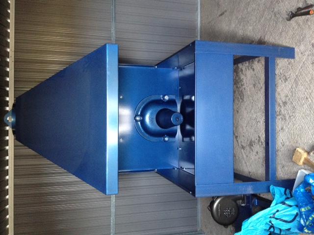

I have only ever used other peoples forges during courses but now I have my own and was wondering how to prep it. I have heard some people line their forge with clay and some seem to collect ash from other forges. I have also seen some forges with heat resistant panels just below the opening to the tue iron, is it worth reenforcing that area?

Usualy a couple of fire bricks under the tuyeer keep us from geting rambuctius and digging down to deap. 2" of sand, ash or cob is sufficent.
Other than that fill her up with sand or dirt, dig out your ducknest (a bit of water and a soup can mold is usefull) fuel and go, if your using coal an inch or two bellow the rim and you can store fuel on the table, charcoal all the way up, as fuel on the table will just catch
A brand new Vaughan's forge? Pretty swish!
Yeah, I was looking for an old one and when they come up they still go for a fair amount. And if anyone else is thinking of getting one try asking what the best price they can do, I got a good discount on mine.
Will the ash that forms naturally from a charcoal fire be enough? Is the build up of sand / ash etc primarily there to protect the bottom of the forge or to raise up the pile of fuel?
Raise and contain the fuel. As long as you have 2" under the fire is enugh with the thin bottom, but if you use charcoal filling it up will just eat you out of house and home. Filling in the box will just save you fuel

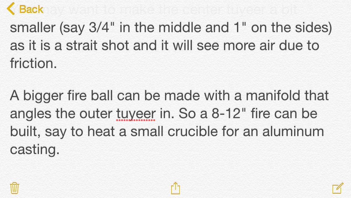

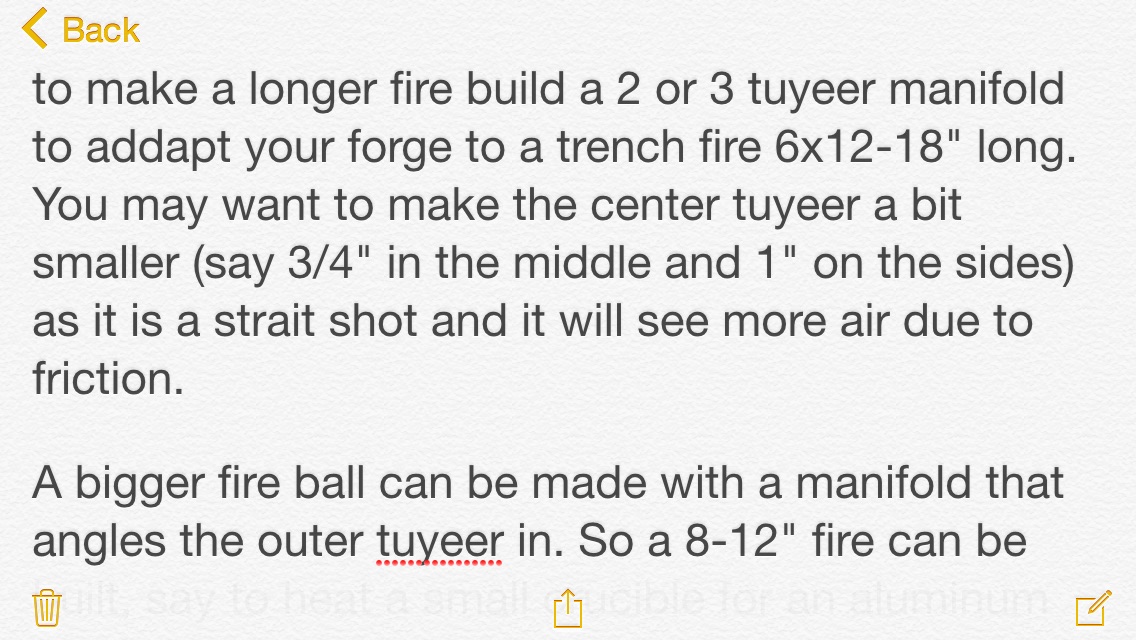

Charcoal likes small (6") fireballs and gental air. Adding more air to make a bigger fire just cools the fire, breads fire fleas and burns up fuel.
Now the cant edit and disapearing post buggs are chewing up my posts
Edited by Charles R. Stevens
TTYF! Lol
Sorry its a bit disjoited trying to work around the new and improved bugs
