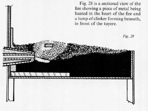

Your going to have a pile of sand and ash between the fire and the bosh anyway, somthing like brick only keeps us from geting silly when we are cleaning out the duck's nest. If you let the tuyeer extend out into the fire it picks up way to much heat, keep it back out of the fire. honestly old clay brick will work, or adobe/daub. I think its classic to line the back wall and most of the floor with brick, just to take up space and duribility, but as slag sticks to brick, fire or otherwise sand and ash overthem is just about manitory.
I have a side blast I built several years ago based on Mark Aspry's plans. There is a thread detailing the build on here somewhere. At any rate I would not bother with the fire bricks for the back of the bottom. I think the front of the tue is far enough away from the back that it will not cause problems. The you also want some room under the tue for clinker to build up. If you put brick and sand right to the bottom the tue will become clogged with clinker very soon. The clinker will also end up stuck to the fire brick and you will have to chip it off. I set mine up like it show in The Blacksmith Craft with coal dust filling the pan.
Side_Blast_Fuel_View..thumb.jpg.56286cce
