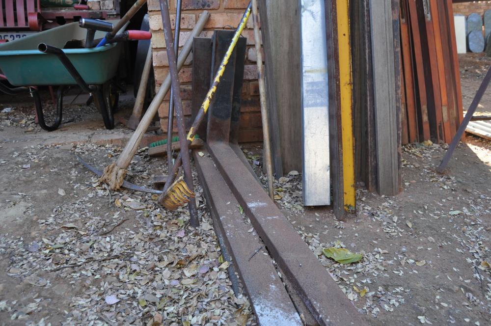

Yip, you're correct, they are out there.DSC_0032.thumb.JPG.8194b0e049c8a104d8ec1
