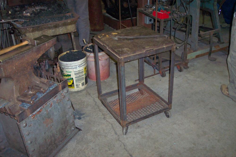

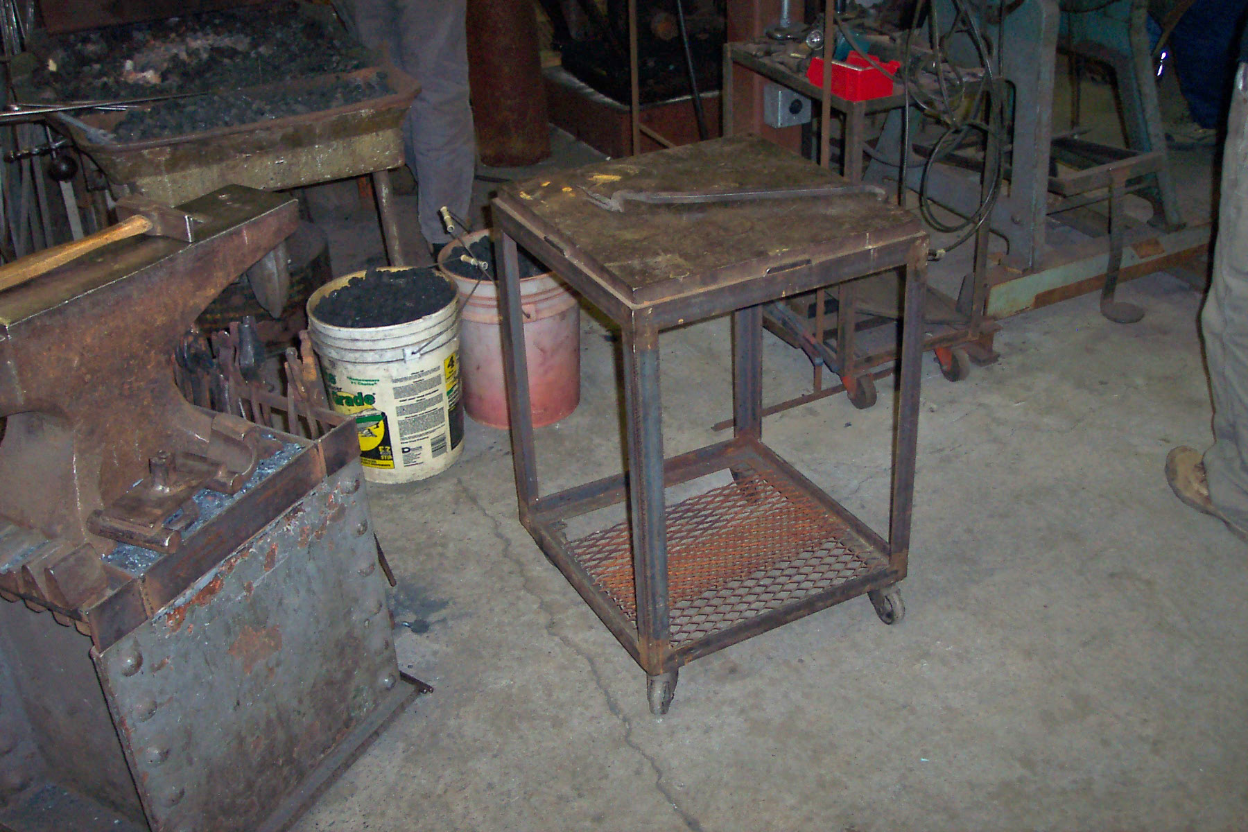

notownkid Posted August 15, 2015 Share Posted August 15, 2015 Not sure is these are what you are talking about but this was compacted sand and it was said real easy to accommodate different height workers. Quote Link to comment Share on other sites More sharing options...
Everything Mac Posted August 15, 2015 Share Posted August 15, 2015 Notownkid those look good. As far as I understand it you have to compress the sand down a bit so it's packed in tight but that's about it. They make a very heavy stand... Andy Quote Link to comment Share on other sites More sharing options...

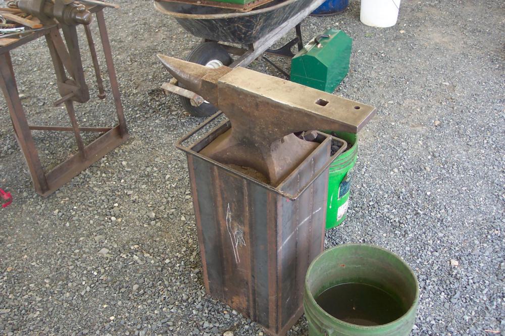

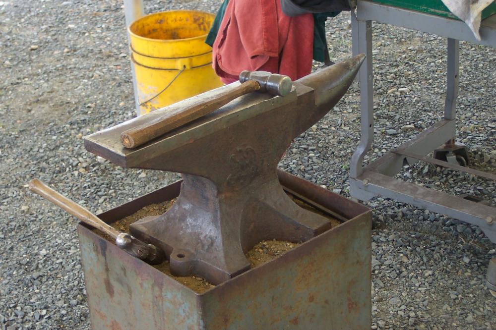

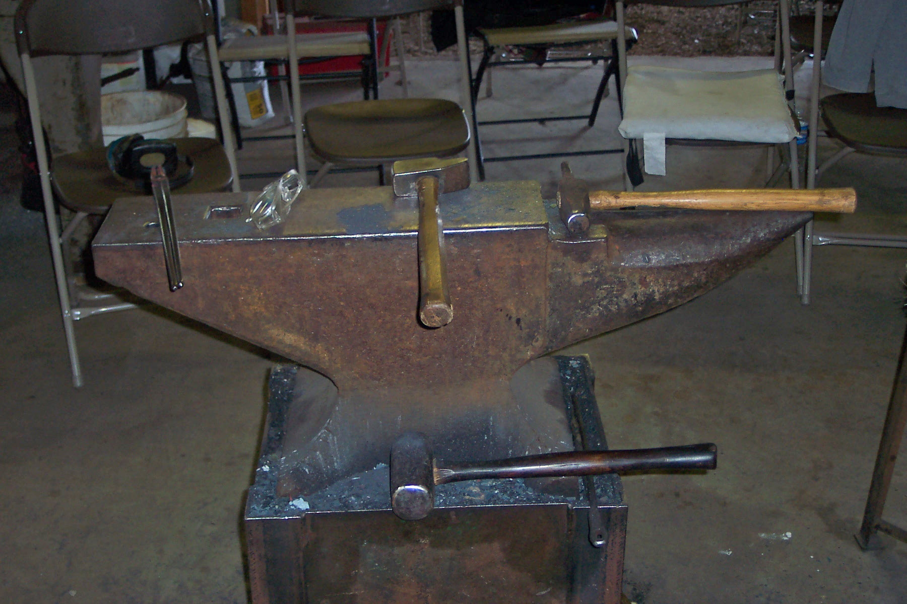

notownkid Posted August 16, 2015 Share Posted August 16, 2015 Huh! it looks like everyday sand to me, I'm sure they are heavy but they get hauled around to meets a lot. I have another pic somewhere of a 500# anvil on a sandbox. I was told they added or subtracted sand as needed to fit workers appears to be self leveling. If I can find a piece of tubing large enough I'm considering replacing my stump with it. Quote Link to comment Share on other sites More sharing options...
notownkid Posted August 16, 2015 Share Posted August 16, 2015 These are the other pic. I found from the same shop. This we were told was a 500# anvil looks the part. Interesting base in the first pic. Quote Link to comment Share on other sites More sharing options...
