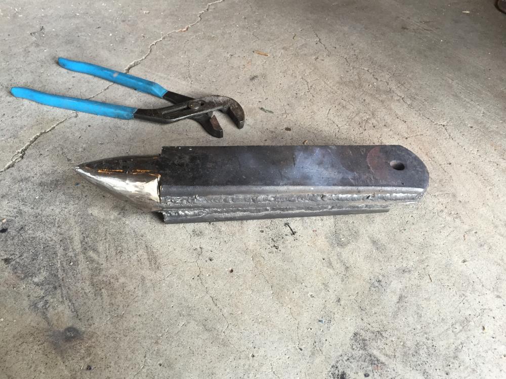

I am also in the process of making a small anvil out of a thick piece of leaf spring someone has donated me. It's quite small and I plan on going to a scrapyard soon to acquire some forklift tines to make a more capable anvil.

I hardened and tempered my tiny makeshift anvil this evening. Couldn't quite get it to heat evenly and come up to critical temp all at the same time. Although I probably didn't do the best job I did a before and after file test and it is a bit harder than when I started.
Don't worry much about hardening it unless you plan on missing and hitting it with the hammer often. You'll be beating HOT steel and that will absorb impact energy not the anvil. Sure a hard face is a good thing but you can run into problems trying to get a good heat treat on salvaged steel and that's a pretty light anvil. Safe is better than a little extra efficiency.
