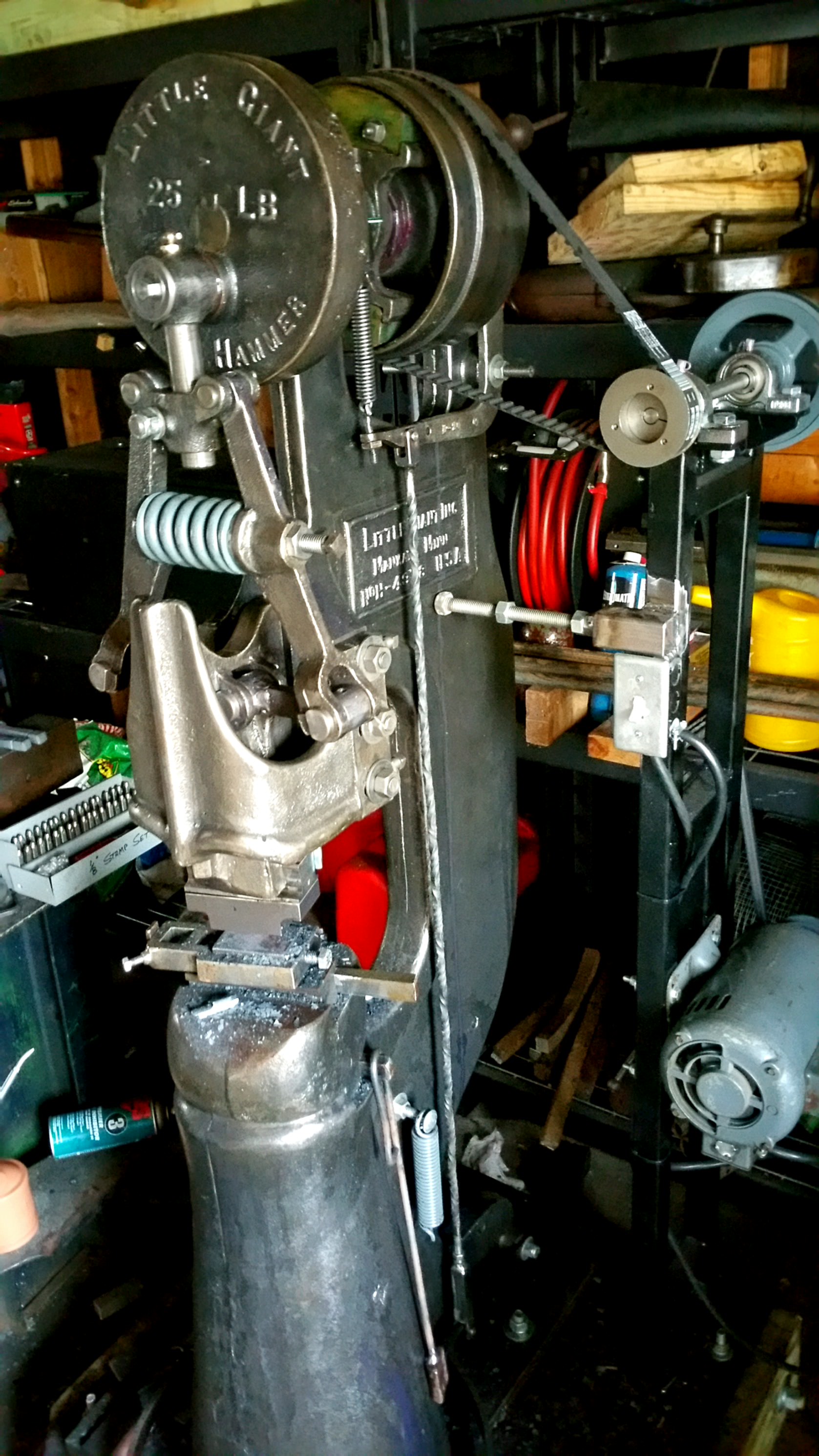

If you have a large enough timber base or a base with a steel plate on it, I would think you could put the same arrangement off to the side and redo the slack belt tensioner arm going to the treadle.  No one says it has to be vertical to drive the hammer.  If you're good with metal fabrication I think you could do something similar to what I did with my LG.  I did not want the motor weight up high on the hammer making it more tippy, and wanted to keep the center of gravity low.
I have a 32"x 36" 1/2" steel plate on top of a timber base made from 6x6's.  The motor "ladder" is has pivot pins down on the base that allow the ladder to tilt towards or away from the hammer.  The threaded push bolt pressing on the frame provides the timing belt tension.  I really like this arrangement, works very well and I will be doing the same thing for the 50# I'm going through right now.  Very easy to change the rpm's of the hammer by changing the belt pulley diameter on the motor or the upper one on the transfer shaft.

I would think you could do a similar side-mount arrangement for the Dupont.  Drive motor would be mounted down lower on the ladder (whatever height works best off to the side), V-belt running up to your transfer shaft that drives the line belt, and the slack tensioner arm between the motor ladder and the hammer.  It would take some time and fabrication, but I think it could work quite well.  ....at least in my mind it seems to...  ;)

Should be easy to do.  Everything in your picture above the idler pulley is after-market home built, probably bolted on.  I *think* the idler arm is reversible to point down rather than up, will have to take a look at the one at work.  You might need a new belt depending on how far you move the jack shaft.
