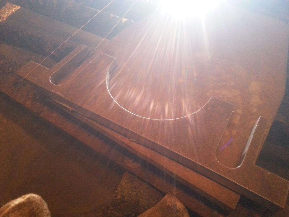

It's that time of year again, I seem to build and re-engineer one of these things each year. lol I've got my cylinder, all the little important parts and pump from my previous c-frame, the biggest problem with it was a little too much flex for my liking, so I'm back to the H style frame with a twist. I'm waiting on some 3x4"x0.25" tubing to come in, so until then the build is on hold. The principal idea is, I'm making my frame out of 3x4, welding it together at the joints and then sandwiching the frame with 0.375" plates one either side, securing them with bolts and maybe a few welds if she needs it (but I'd like to avoid that in order to access the internals of the press which will contain the guides and possible springs for the traveling top die plate). The whole press body is 28"x32". I want the whole unit to be able to sit on a table that my rather large hydraulic tank and pump will sit under, instead of being twice the size and requiring it to be wheeled around the shop. I've rough cut the front and back panels and the cylinder mount on the plasma table. I'm just sort of making this up as I go along so I'm sure I'll be making parts here and there, but I figure I'd show what's been done so far.

Gussets were always in the plan, however the exact execution was a little up in the air until this afternoon when my supplier called me back. The don't have 3"x4"x0.25" in stock at the moment.. however after he dug around, he found some 2"x4" with a 0.375" wall. So, now the idea is to make 0.375" thick L shaped gussets affixed by welds (drill 0.5" holes and fill them, grind flush) and the existing bolts on both sides of the frame, just like is found in some bridge work. I may also make 4" wide L brackets for the outside corners to get bolted and welded into place for added support. The nice thing about having a cnc plasma cutter is not being limited for certain parts. If I can draw it, I can make it. Here's and updated png overlay showing the tubes in light green-grey, gussets in red and corner brackets in blue.

Sure Allen, you're always welcome to come by the shop, once I get the wrinkles ironed out. :) I'll probably compile a dxf file of the parts so it could be taken to any cutting operation, but in the meantime I've got get it beyond the prototype stage. :) Of course that's really only helpful if someone wants a press with only a 3" ram extension like I do. I didn't find it restrictive for welding up or drawing out billets at all, and on the previous c frame version I started by making my dies 3" tall, so if I needed more clearance I could just change one or both of the dies down for a smaller one - technically I could start with an 8" piece of stock and by changing dies a few times draw it down to 1/8th. It may be next week until I get to work on it again, my stock on ebay is dwindling so I've gotta brave the cold and make a few knives over the next few days..

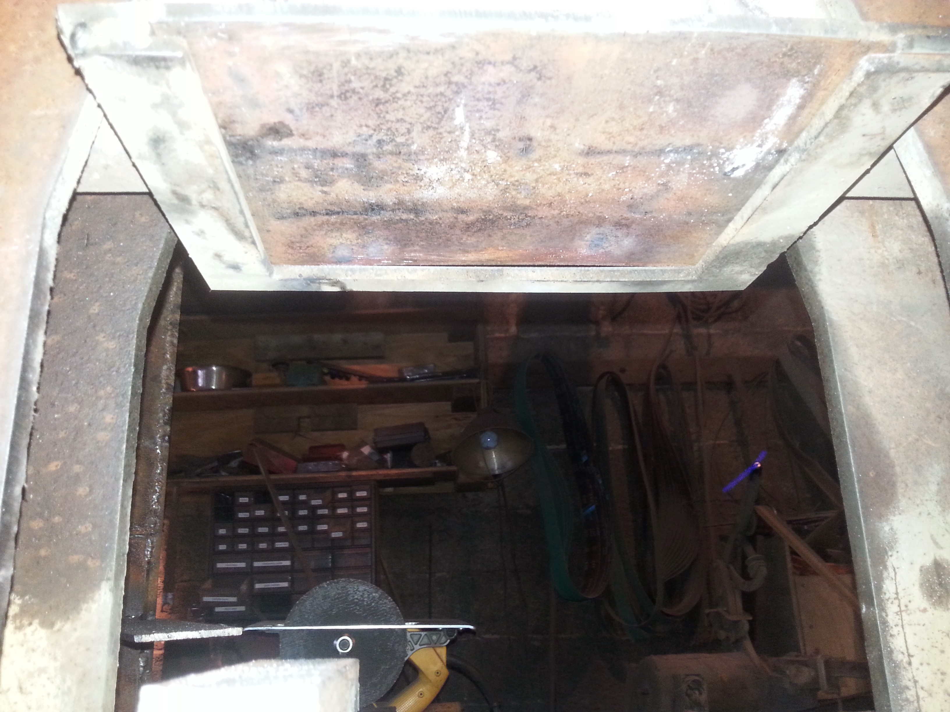

So here's the inner frame so far, please ignore the ugly welds, I swear I'll pretty them up later but for the moment I'm dealing with flux core wire because I'm out of welding gas and didn't feel much like running anywhere as it's in the single digits here. Each corner was welded on either side of the frame before placing the gussets. The gussets are 0.375" with two channels that are being filled by a multipass weld. Three bolts will pass through each as well. The tubing is 2"x4"x0.5". Tomorrow I should have the gussets in place and smoothed out and will start drilling the holes for the front/back plates, I wish I could use my drill press for this, but I think I'm going to have to do it by hand. The more I think about it, I will probably end up welding the plates to the frame and ignore my previous idea of being able to access the interior - I may put two springs in, but they're not needed as my cylinder is is powered in both directions and I can't see them actually performing any sort of job. Anyway, it's time to get out of the cold and head home for the day.

I got the gussets in place and cleaned up for one side. I positioned the back plate and tack welded it into place. Next step is drilling 40 holes - yay! - I had to put everything on hold today because I can't seem to remember which box my corded drill has been tucked away in. I think I might be better off going to Harbor Freight and buying one of their low speed drills. I think 550rpm will be plenty for this operation with the bits I have and everything I've read says that despite its brand it's actually a tough drill capable of some heavy action. I'd love to just use my drill press but the switch died on me this week so I'd have to replace that and the frame is already weighing in at around 200lbs which I'd have to move by hand and support it rather precariously on the table of my drill press and the arbor press which sits beside it.. Rather than move the unit 20 times I'm really leaning towards doing it by hand. Anyway, it's definitely starting to take shape. Here's a quick snap of the body/frame and one of the cylinder which is going to be mounted in it.

Got the right drill for the job, low speed - high torque. Cobalt drill bits are just going through this like butter, making nice long spirals! Yay! I have to finish drilling the holes, but here's how she's shaping up so far. Next step, I'm welding some base supports on and switching up to horizontal drilling. Fingers crossed. At the moment we're weighing in at around 180lbs. which is just about my comfort zone as far as moving by myself and I'd rather not lay it on the shop floor again if
I don't have to. For the moment the face plate is just bolted into place until I get every other aspect planned in my head. After the base and holes are drilled I'm going to mount the cylinder and focus my attention on the dies.

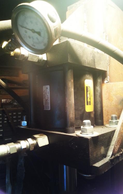

I got my cylinder liberated from my other press. opened everything up to finish the internal reenforcing and decided to do a quick test fit. So far, so good. I'm going to cut a two piece 0.875" riser that will get inserted under the cylinder from the front and the back, with slots to accommodate the four bolts, and then shim it against the top beam.  Tomorrow I'll finish up with the internals and hopefully the die mechanisms. I don't want to jinx myself but I may just have a working press again by Thursday or Friday.

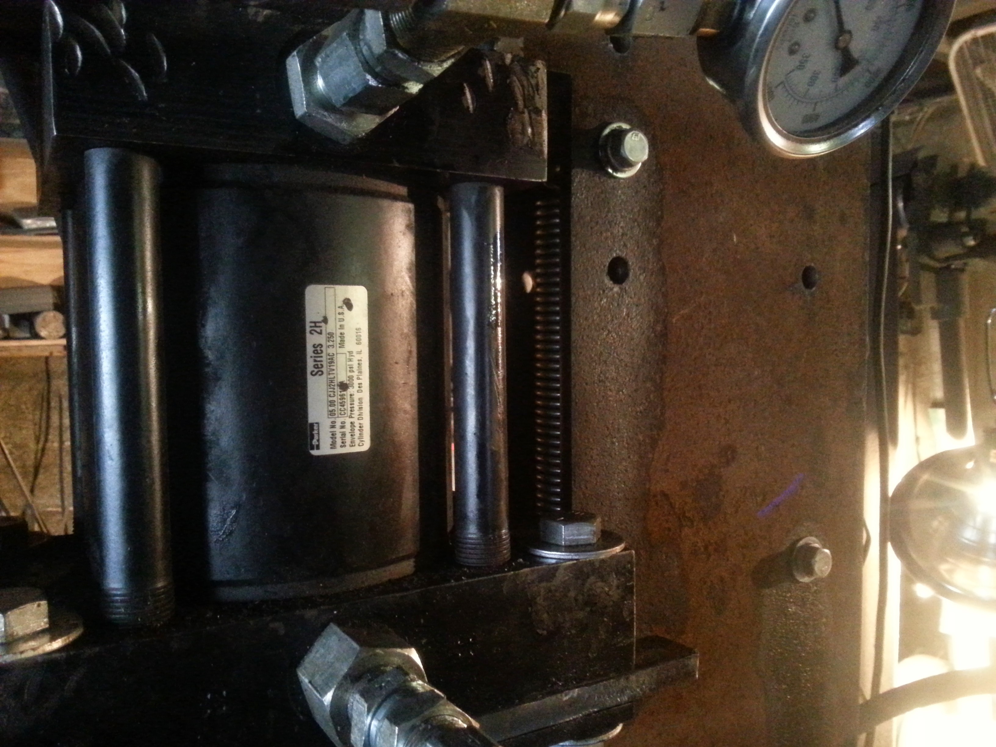

After attaching that image I couldn't write a description on my phone. So, the above picture is 1 of two riser plates that slide under the cylinder from either side above the single piece 0.375" plate that the cylinder will be fastened to. These will lift the cylinder 0.625" providing a little more die clearance and provide enough clearance from the ram seal rings so the cylinder can be centered in the press. Everything is partly assembled but I had a little fluid leak when I disconnected the hoses and I didn't feel like mucking up my phone to snap another picture. Tomorrow I'll make the remaining parts and do a test run under 1/2 pressure.

Coming down the stretch. Cylinder is centered, Bar for mounting the upper dies is in place and has springs attached. I still need to figure out how I'm going to attach the ram to the bar. In a previous life this cylinder was welded in place and the cut to remove it was slightly off - I suppose I could make the needed shim and a receiver for the ram to keep the bar level and in place, Or I could just get it level and weld it like someone else obviously did. Ideally I'd find a 1.5" 12 tpi bolt to place in the female threads and weld the bolt head to the bar, but my trip to the local "has just about everything" hardware mecca turned up nothing, only 6 and 7 tpi in stock. So far so good though. I need to cut a few triangles to weld to the outer panels to hold the cylinder down and a shim for on top of the cylinder, which as luck would have it, needs to be 0.625". Well, back to SheetCam!

Today I finished up the die mounting system and took the play out of the bar. Fired up the pump and ran it through a quick stress test.. Heard some creaking as everything trued itself but even at full power under load everything worked great. I cut a bunch of die plates today, made one quick one up, but I'm not super happy with it. In the morning I'll make a drawing/ flattening set and give her a good run just to see if there's anything else that need be addressed immediately. If I can get caught up on actual work, I'll try to shoot a video of it in operation. Maybe I'll even paint it.. Nah!
