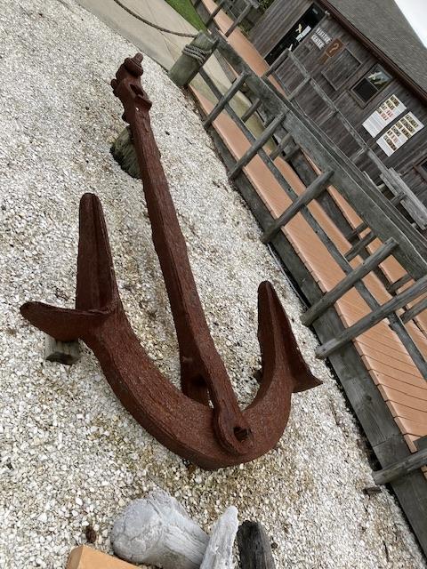

Wrought iron can be found at old farm sites where a silo was.....5/8" round rod was used as the bands to hold them together. Old wagons with wood wheels had wrought iron bands as the "tire". Ships had anchors and anchor chain of wrought iron. Over 110 years old and it's probably wrought iron. Bridges, structural iron in buildings, etc.....it was everywhere.
