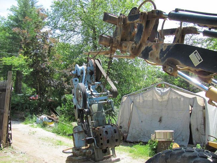

As I posted elsewhere my beaudry will finally be put on a foundation. I needed to get it moved today so we can start on the foundation for the Nazel but the beaudry foundation will not be poured till this weekend.
Just a couple of shots along the way!
Big forklift!
Resting place for the next week or so.

It looks like the jack shaft and idler pulley set up is not original. If you plan on doing any long work you will need to change how that and the motor are mounted. It looks as if you cannot straighten work lengthwise across the dies without running into the V belts.
What year is that hammer? It looks in pretty decent shape. I think the #8 is rated at 250# ram weight
The big issue with the v belts for me is the way the hammer runs. By slipping the v belts and having the secondary shaft still the hammer comes up to speed slowly. It basicly eliminates the single hit that this style of hammer is known for.
I will however wait till we are using it and have other stuff sorted to make any changes. Right now its working ok and hits plenty hard.
Yup 250 lb but I dont remember the year. The serial # is 8051

I've run into a little snag as it appears the anvil is slightly turned and the mounting holes are blocked somewhat. Is there a trick to rotating the anvil? I do have the hammer up in the air on 4*4's at the moment and can get to everything.
I haven't lifted the frame off the anvil yet. From talking to the previous owner and several other beaudry owners I was under the impression that the anvil was loose in the frame and anchored to the floor through the bigger holes in the base. My anvil has a hole that a piece or pipe or round bar can be stuck through. When we loaded it on the trailer to move it the anvil and frame were chained to each other and lifted together but the anvil appared to be loose.

I'm still having problems trying to rotate the anvil. No pins or anything? I've oiled around it and am letting it sit but its pretty firm.
I'm thinking of stablizing the ring that holds it from underneath and lightly running the hammer. maybe with a 4by4 between the dies.
My Beaudry hammer frame has about 3/8" clearance on all sides to the bottom anvil - so the frame can be lifted free without interference. The anvil has oblong holes so the dies can be lined up if the mounting holes are set correctly. If your anvil is stuck to the frame as it appears to be, it may have been caulked with lead at some point (which I have seen on two-piece hammers) or it may be glued with paint/rust.
You might want to take the main key out, remove the sow so the anvil can clear then pick up the frame a few inches off the ground and tap the anvil with a sledge to break it loose. It should eventually drop free and you'll be able to see why it was stuck in the first place.

It seems to be caulked with some kinda black pitch like substance. Adding to it is the anvil is jammed up into the ring too high , about an inch and a half on one side and half an inch on the other so its really jammed in there.
I'm having a hell of a time with it and only have one more day with the forklift. I can get a smaller lift later that will be ok though.
We have heated it, Chiseled out all the caulk we can get to, thumped it on the ground with the lift, driven it fairly hard with cold steel on the dies. Nothing, no movement at all. I even tried a few wedges used for breaking stone but decided I can't risk the castings like that.
Tomorrow I'll take a sand blaster and try to clear all the larger areas of all the 'tar'

After removing all the tar I could ( Im convinced its asphalt/tar at this point) I think the only thing left is the inch or so thick area above the anvil ring but under the machine.
I decided to go ahead and set the hammer as the anvil is captured anyway. If it finally drops from use it can only go 1" down so no harm anyway. Once it moves (IF!) I can remove the leveling shims on the lower die and simply bolt it down to the foundation.
I can't see anyway it can hurt anything at all or do any damage to the machine or castings.

The tar is probably in there to keep scale out from underneath the anvil. Scale can migrate down under the anvil and actually lift it usually not squarely. So if your hammer is used quite a bit you should probably seal up between the hammer and anvil when you are done installing the hammer.
From your description, it sounds like your anvil got cocked in relation to the frame and is now bound up. I agree with your solution of simply putting the whole assembly in place and using it but I think you have to have every particle of asphalt removed so it can slide when the time comes to break loose. In addition, you may want to check parallel on the dies now to determine how far apart they are for the purpose of having a reference so you can tell if the anvil is moving after use.
