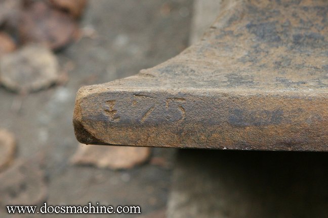

DocsMachine Posted October 22, 2009 Author Share Posted October 22, 2009 Better photos, in the sober light of dawn: I took the small wire brush to the sides as well- there's not even a hint of any stamping or marks. The numbers are on the front foot. Hopefully the serial number will help with the age and ID. Thanks. Doc. Quote Link to comment Share on other sites More sharing options...
DocsMachine Posted October 22, 2009 Author Share Posted October 22, 2009 Going by this old ABANA post:If you see a series of numbers (serial number) on the front foot, it is almost certainly to be a Trenton, Hay-Budden or Arm & Hammer. If it starts with an A, it would be an H-B. Arm & Hammers do not go over about 52,000. Too high a serial number and no "A", so would it then be a Trenton? (Trexton?) Also, is there any way to ID this leg vise? Doc. Quote Link to comment Share on other sites More sharing options...

Frank Turley Posted October 23, 2009 Share Posted October 23, 2009 It looks like a Hay-Budden, and I don't think that it is ugly. The faces are normally 4" wide or just under 4". Often, on an anvil of that size, the waist width is also about 4", measuring side to side, not horn to heel. My "Anvils in America" book gives an approximate date of 1912 for its manufacture, and that is based on the six digit serial number.Turley Forge and Blacksmithing School : The Granddaddy of Blacksmithing Schools Quote Link to comment Share on other sites More sharing options...
DocsMachine Posted October 23, 2009 Author Share Posted October 23, 2009 So is that a pretty positive ID? A Hay-Budden? Doc. Quote Link to comment Share on other sites More sharing options...
Sask Mark Posted October 23, 2009 Share Posted October 23, 2009 Didn't most Hay Buddens have serial numbers on the left of the foot, while Trentons serial numbers were on the right of the foot? If this is the case and if your anvil is indeed a Trenton, it would be made in 1926 (according to anvils in America) Quote Link to comment Share on other sites More sharing options...
irontwister Posted October 23, 2009 Share Posted October 23, 2009 hay-budden, really looks like a hay-budden to me. im no expert but i have been lookin at a lot of hb photos and i stumbled across one that looked like that. it was a 70 pound but i dont know if it really was or not. i dont remember where i saw it but i will try to remember. last night i just found my serial number and weight on my Hay-Budden. its a #208. Quote Link to comment Share on other sites More sharing options...
ThomasPowers Posted October 23, 2009 Share Posted October 23, 2009 What dos the bottom look like HB has a very different indent than Trenton! Quote Link to comment Share on other sites More sharing options...
