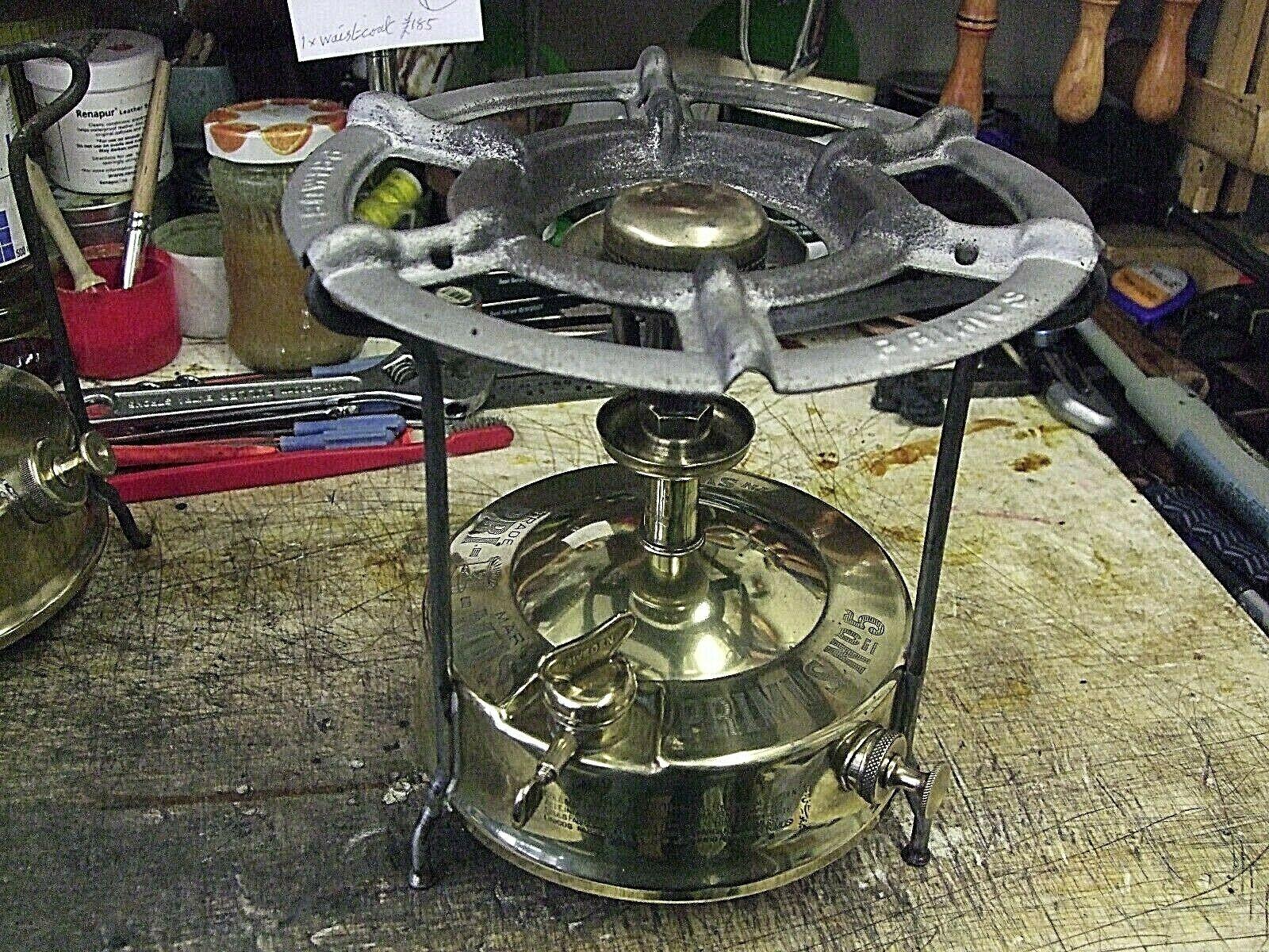

  7. Sorry if it was stating the obvious. I didn't know whether they were exported to the USA.
    In the UK the pressure lamps were either Tilley or Primus brand. But the paraffin pressure stoves were almost exclusively Primus. Blimey just done a search for an image and see they are worth £50-85 on eBay...we have two or three in the shed I must look out!
    image.jpeg.af9e9c4dcd2a05f4052d78f984d867b0.jpegimage.thumb.jpeg.3f05bb7d50e84e9ec329e9aa25f8055b.jpeg
    Alan Knight, the smith I worked with when I left college had a neat folding petrol pressure stove which collapsed into a rectangular box made by Coleman I think, and I had the impression that was ex military USA. We used it every day for tea and coffee brewing

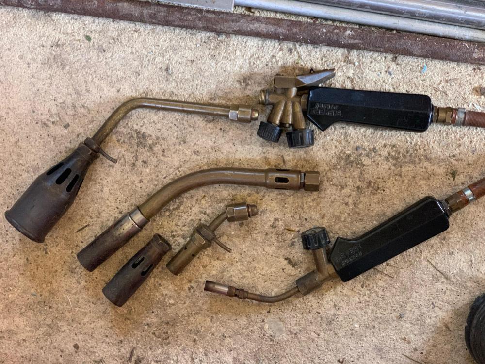

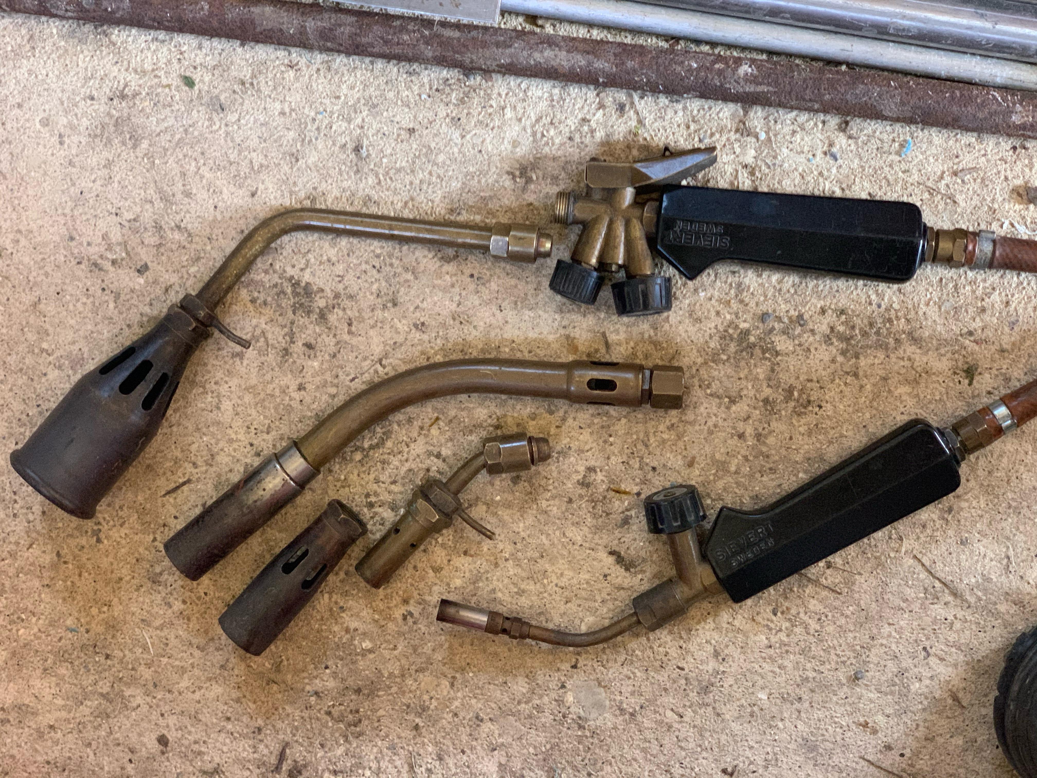

  8. The Sievert propane Torch is top quality. I have a couple of them...bought them back in Mid 1970s when I started out and was earning a living as a jeweller and silversmith.  Still in regular use now, last used two days ago to stress relief anneal some cartridge cases.
    The nozzles are still available. The handpiece is universal and with various necks and nozzles will do fine silver soldering to hot felt roofing. Good website.
    The large diameter neck in the middle produces a helical flame which licks around the back of copper pipe work for plumbing.

    Sievert are one and the same with Primus who made paraffin (kerosene) cookers and lamps...the sort under pressure rather than wick burners.

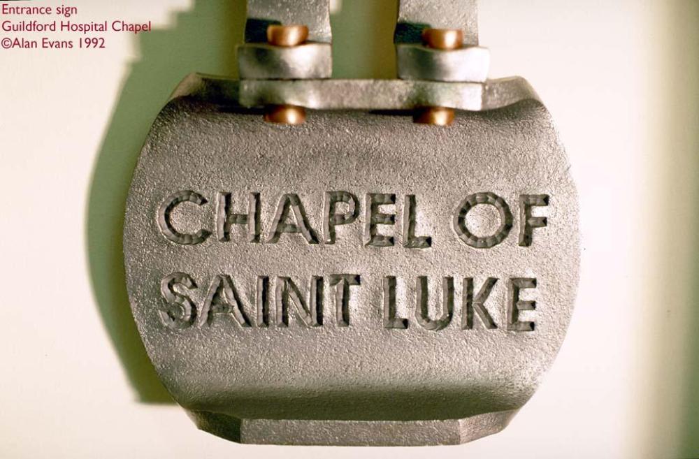

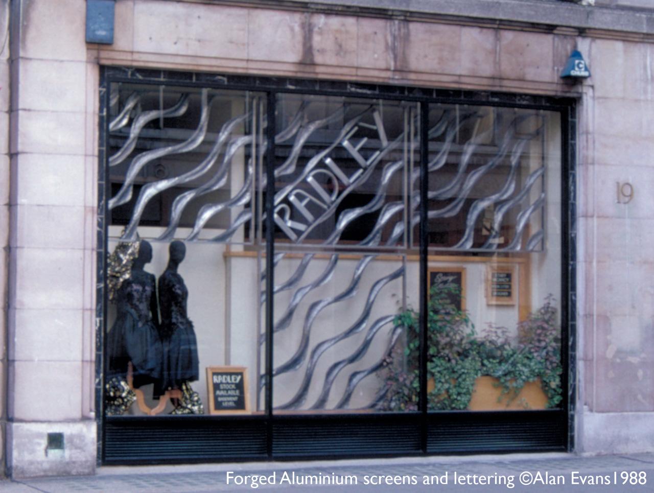

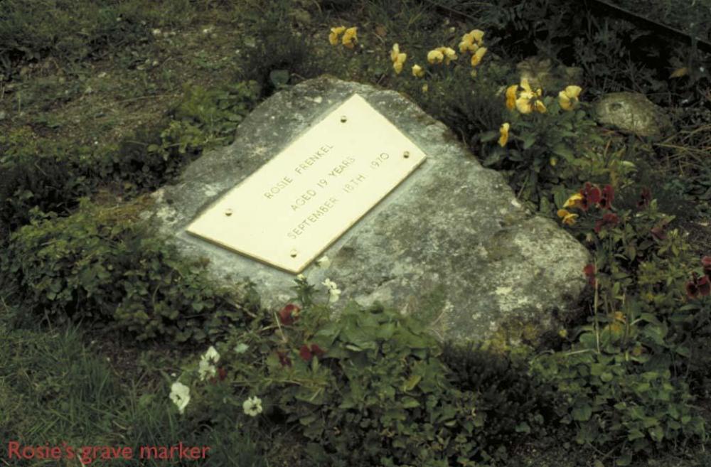

  10. Create your own? Make it your own script like your handwriting? Good fun playing with letter forms.
    I have had a few projects with lettering and each time made up a script and the tools to make it. The project determined the approach.
    A grave marker for a friend was chased into a 12mm (1/2") brass plate. It used I think 7 basic straight and arc punch forms to create the letters.

    One project was for a fashion house shop window and was formed from 50mmx25mm (2"x 1") Aluminium flat bar...
    I experimented by shearing off some sheet aluminium to 2:1 section strip and working it with round nose pliers
    Royal Surrey Royal Surrey County Hospital Chapel sign punched into 12mm (1/2") plate
    786180100_178signGuildfordHospitalChapel.thumb.jpg.bd82f12441e8e9b564dce0740e562470.jpg
