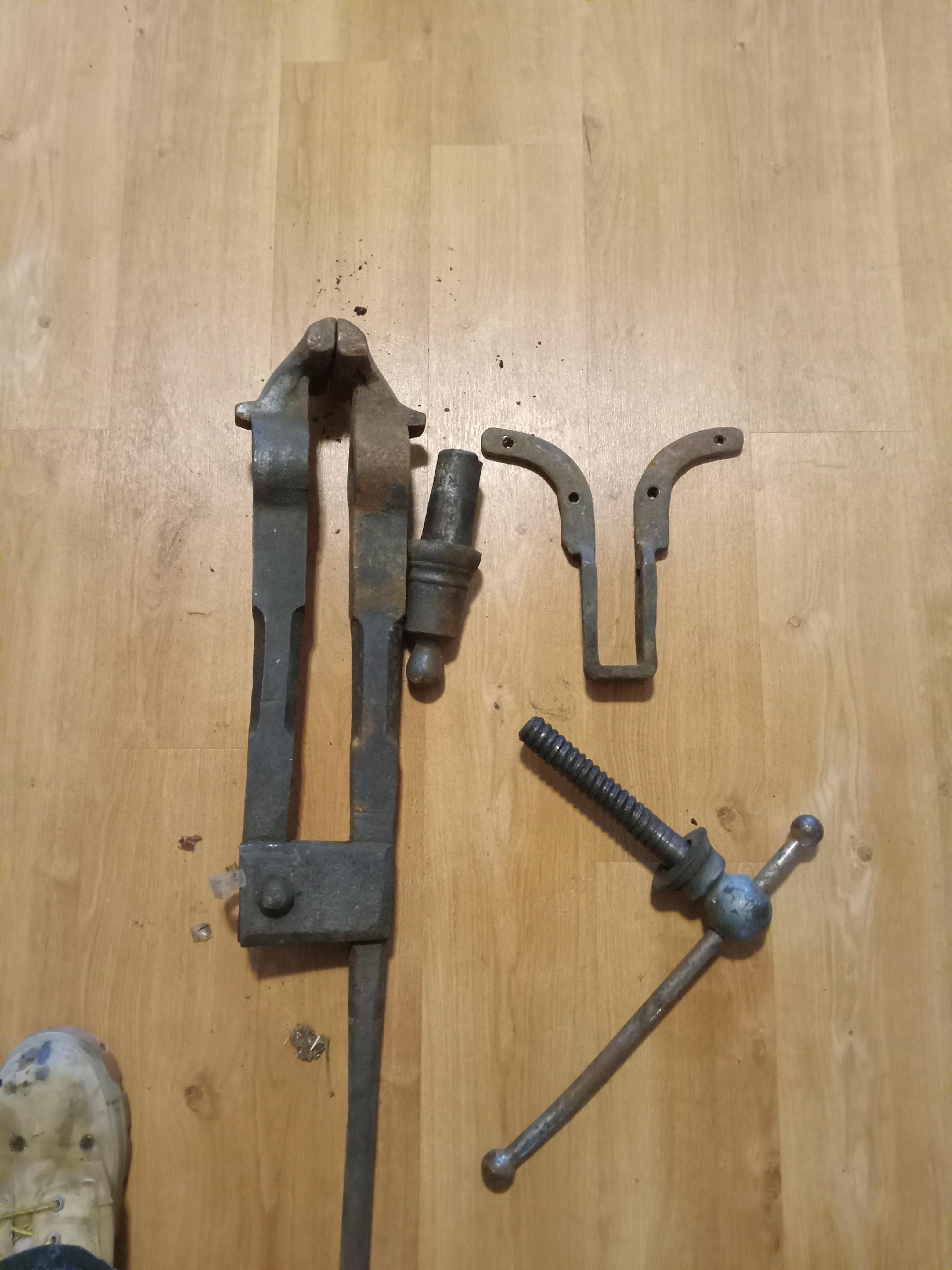

Hello again! Just wanted to do a quick final update. Everything came out great! Got it mounted, the spring forged and a decent wedge in place. Opens nice and smooth, and ready for years more of work. Thank you guys for the all help! One day I may reforge a second spring, cause mine has funny looking ears, but it does its purpose lol! If I remember I'll take some pics and post em too. Take care! -

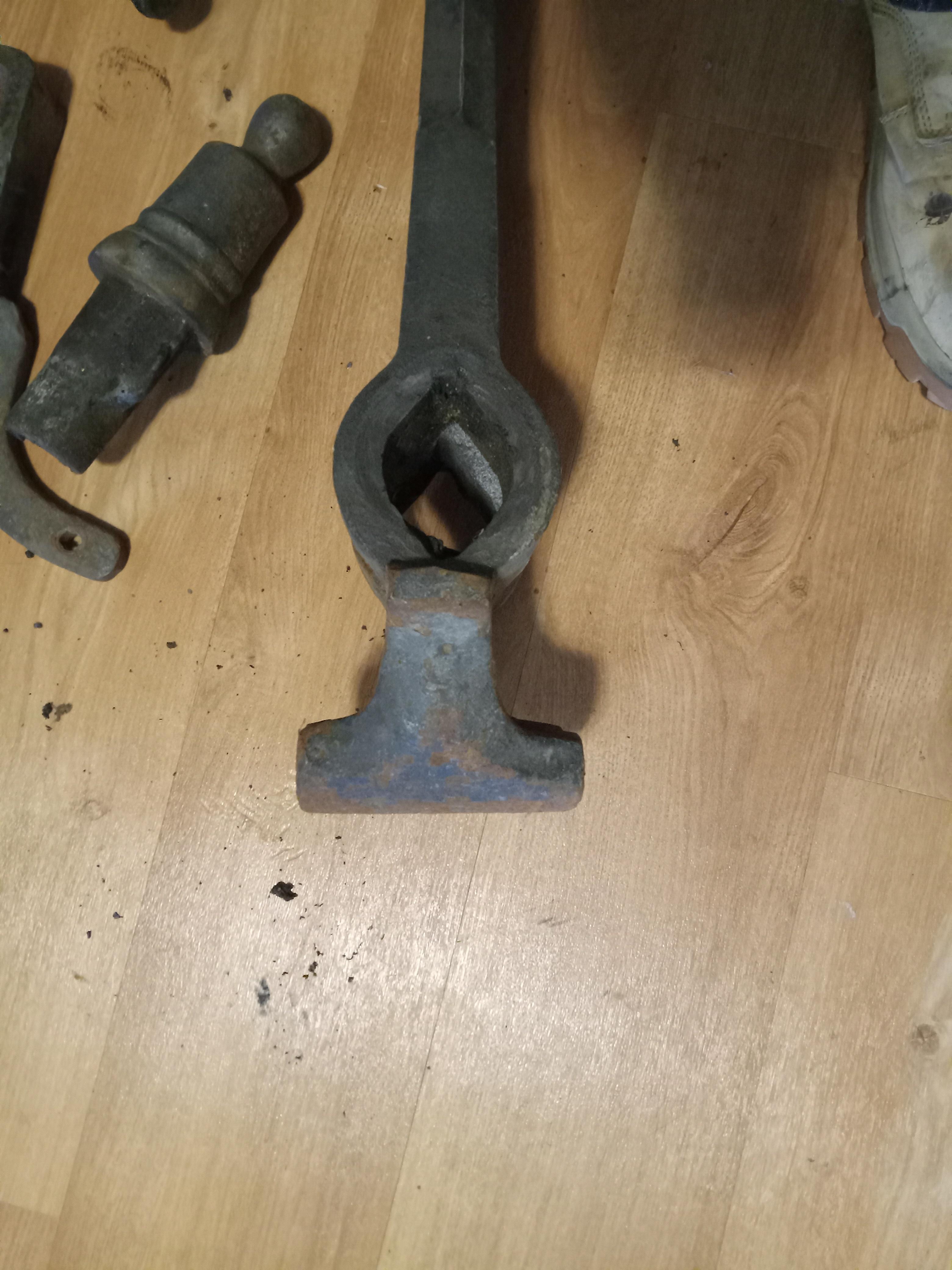

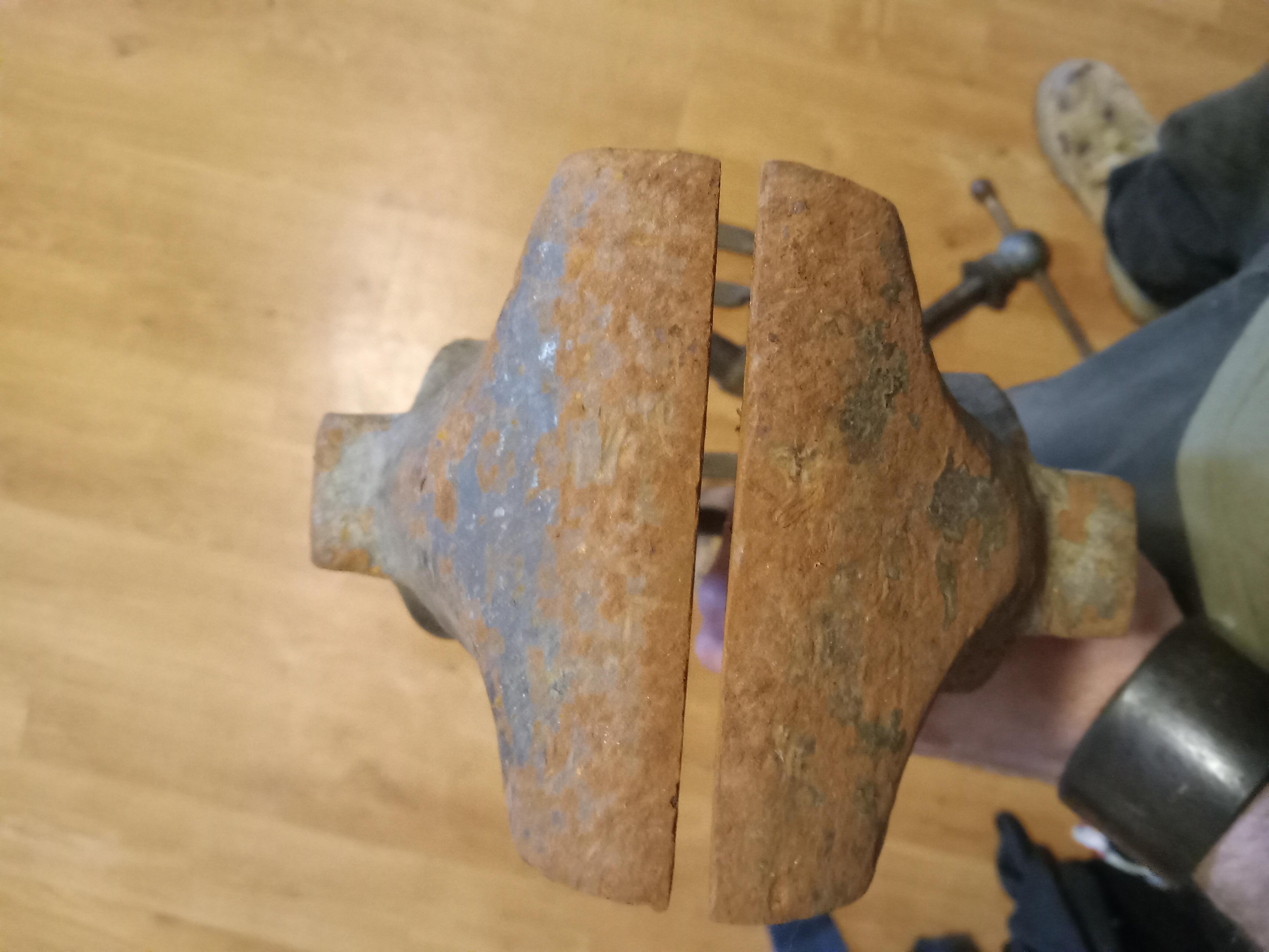

FrontierBoundPrivateer started following Irondragon Forge ClayWorks
