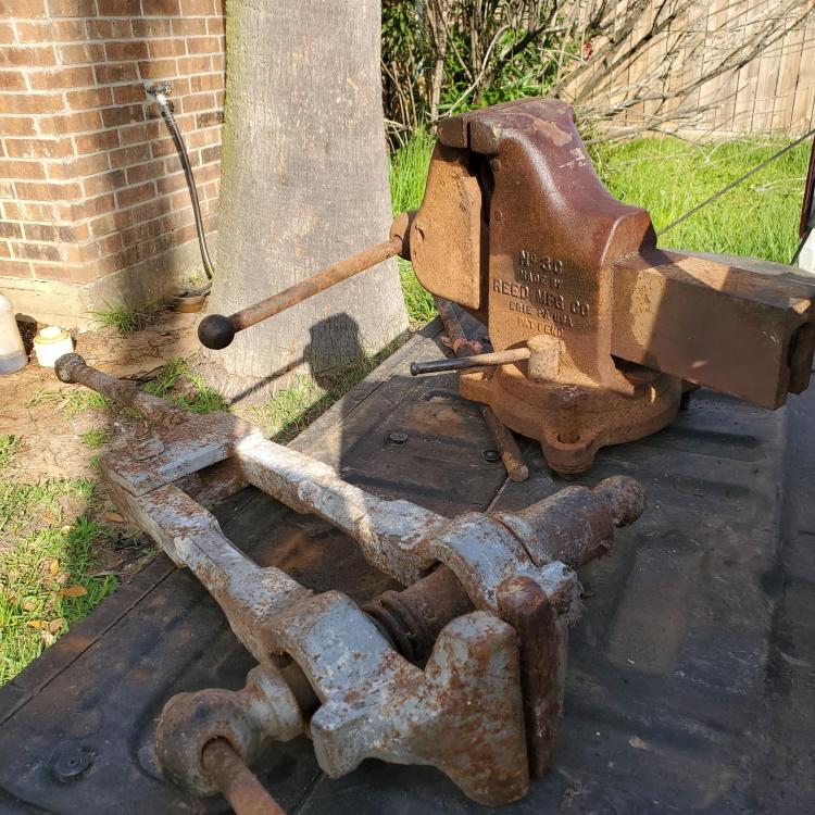

  1. IFCW thank you. Would never have thought that. So no heat! George yes absolutely. Thought about that after reading what I typed. I was getting ahead of myself. I'm assuming the jaws are frozen. I need to remember to take one thing at a time. But being from Cleveland Ohio, salt capitol of the world, and being a tech for 16 years I would bet my paycheck that the jaws are frozen. Getting ready to see what breaks loose here in a bit. The post vise seems to work fine. Just no tension. I'll take some more pics in a bit to show what I'm working with. Looks like there is a coil spring around the bolt. Doesn't seem to be doing anything. So I'm not too sure. I have a bunch of leaf packs laying around waiting for a purpose! Hopefully this will be one lol Shoot George. I just reread your response. Are you saying that the jaws are attached to the screw? So if the screw moves the jaws will follow? I thought the screw could be removed separately from the jaws Talking about the reed
  2. Thanks ifcw and Frosty. Yes that's the secret sauce. Thought mechanics were the only ones who knew about that. I have it soaking right now. Unfortunately not submerged. I plan on making a spreader. I have a couple rippers from a box blade that I think will squeeze in between the jaws. If they do I'm going to drill and tap the first one and just notch the second. I'll screw 2 bolts in the tap and slowly tighten until the jaws begin to move. Going to try not to use any heat but that's always an option. I'm assuming there's bearings on the front and rear side of the screw? If there are then heating is not really an option imo. Hopefully this 'spreader' will work. Fingers crossed
  3. So here is the bench vise that I found buried and a post vise I found at a garage sale this morning on my way back. Paid 75 for the post vise. Any feedback on how to mount or what to look for as far as operation is concerned would be appreciated. I did notice there was no spring in between the 2 arms if that makes any sense. The reed vise is frozen so going to fabricate a tool to separate

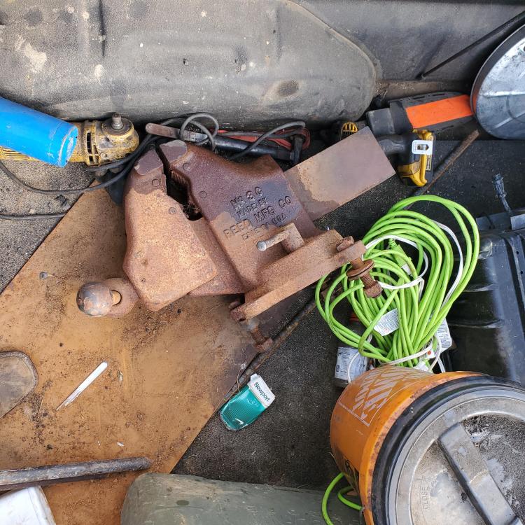

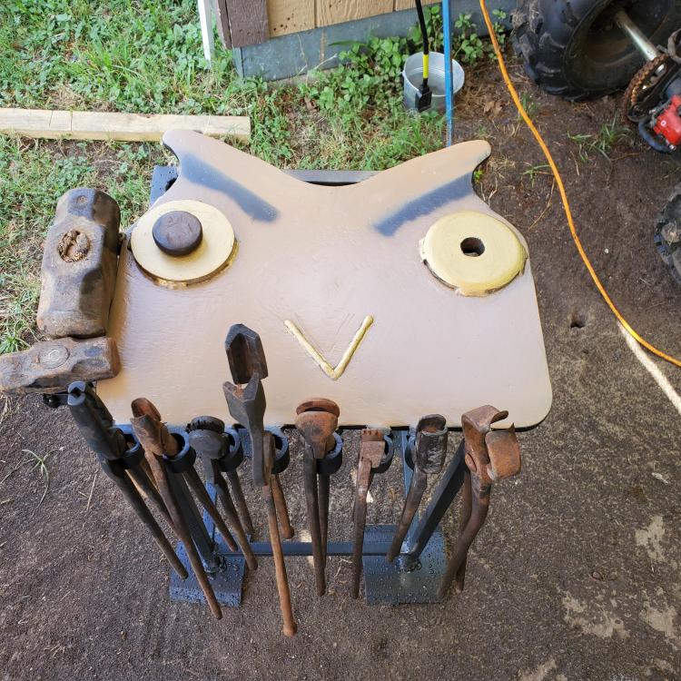

  11. I was given a cooking apparatus for the back of an RV that stored a barbeque grill and a cabinet. The whole unit probably weight 400-500 pounds. That piece was the base for where the bbq sat. Then I just cut some brackets from another plate and welded the eyes for my tong holder. Welded some flat bar for the hammer holder. Pretty straight forward. Love Frankenstein builds. And yes there is potential there for other uses. For now it's my portable tong holder. Got sick of putting them in buckets And yes a swage is definitely on my list for next piece of equipment. I'll find one eventually. Also a leg vise. I was hog hunting the other night and was walking through the woods when I tripped over something. So I look and notice it wasn't a root or stump. 35 min later after digging and digging I found a 9'long rail road track and a diamond....a reed 3c bench vise. It's a monster. Well over 100 pounds. After I get back I'll clean it up and take some pics. Super excited

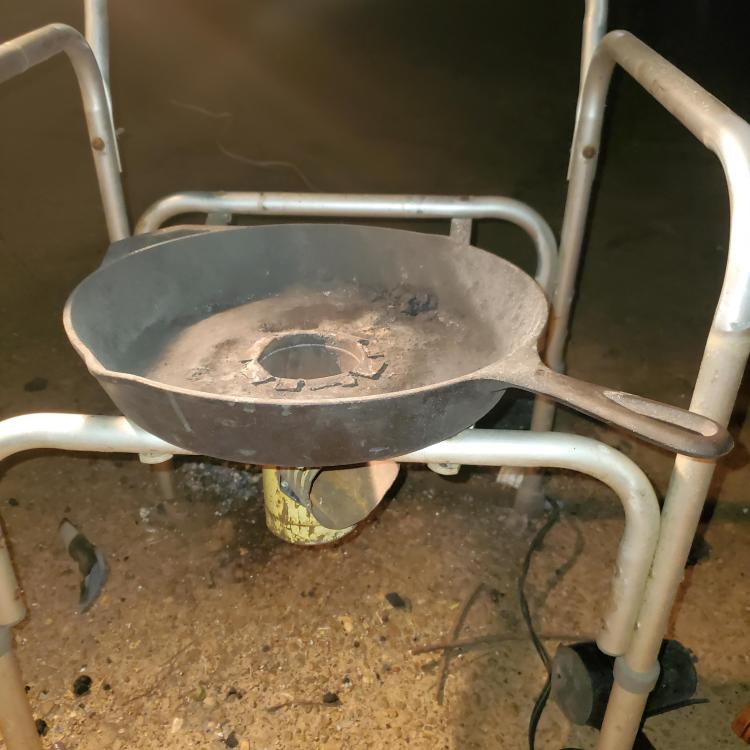

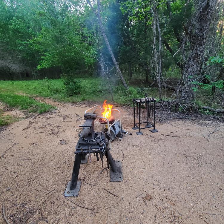

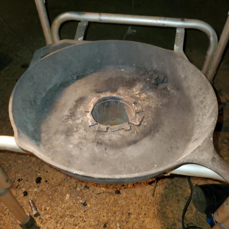

  13. Yes sir. That makes sense regarding the 6' distance. Going to have to rearrange some things. The more and more I forge the more I realize the importance of efficiency and keeping the piece as hot as possible. Appreciate that advice. The table that I use for my tongs doubles as my punch hole for making the bottle openers. The holes were already in the piece of steel that I salvaged, I just had to enlarge one for the final step. Thought it looked like an owl so I painted it lol.
