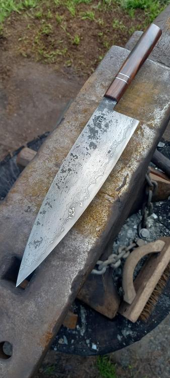

  2. Thanks mate I was happy how it turned out. It's fairly big 240mm x 57mm high

  4. Yes I was very surprised how differently the wrought moved compared to the file steel. I'm certainly no expert but maybe w2? I've done lot of san mai before and I do everything flux free. My next billet will have 3.6mm 1084 core and see how that moves. This is the forged blade

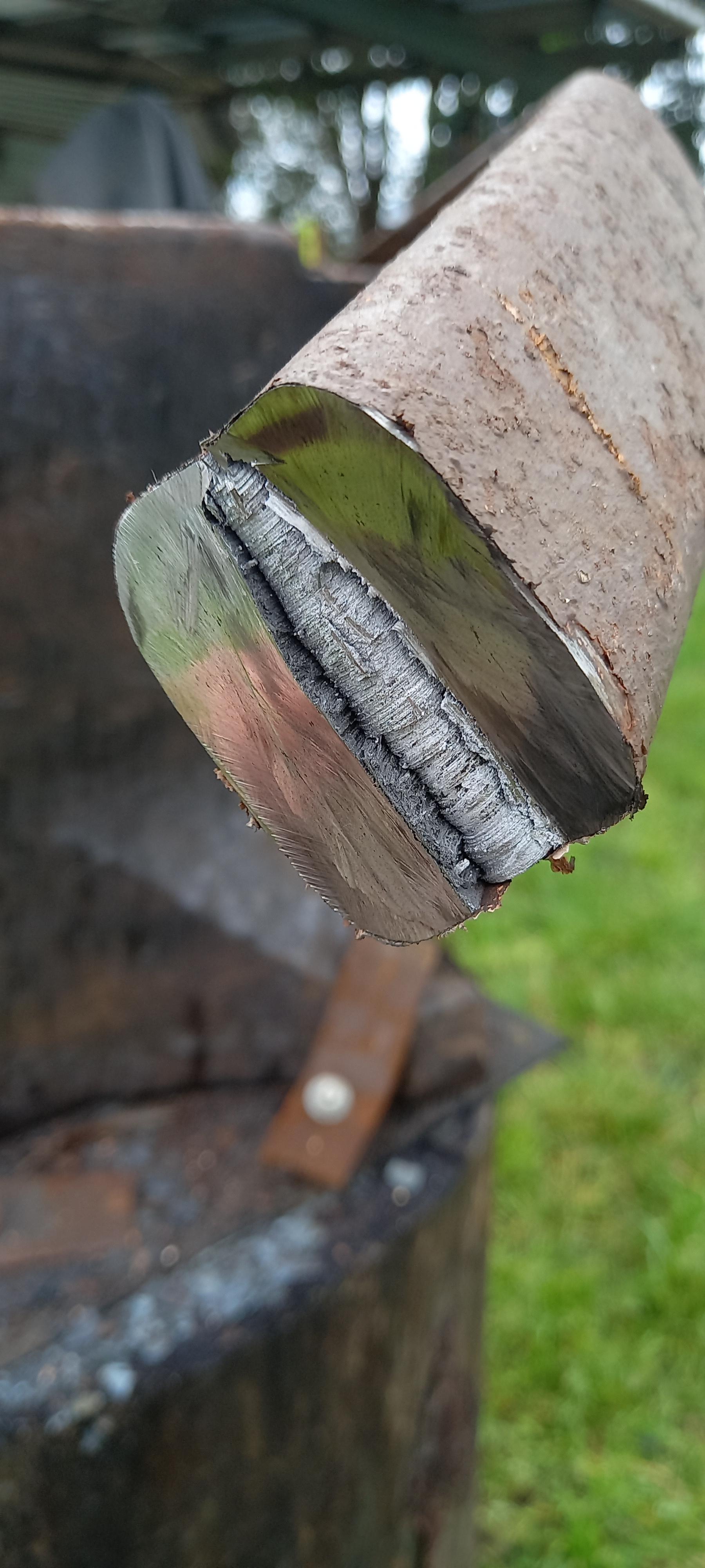

  5. Ripped into this wagon tyre today. I forged it from 20mm thick to 9mm. Cut it and cleaned up, the only high carbon steel I had around that thickness was an old worn out file so I used that as the core steel. I've used old files for kitchen knives before and I really like them as monosteel blades. It turned out to be a bad combo with the wrought, I've got way too much core left, hardly any wrought. I forged it almost all the way to shape just to keep the cladding where I need it but I'm guessing I'll grind through the a lot if the wrought layer. I'd be interested to know how other knife makers work with wrought. L
  6. Thanks for the replies, so I took a punt and picked it up. Couldn't see any welds, it had a thick coat of paint over it, couldn't make out any grain until I got it home and gave it a sand back

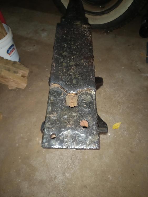

  12. Thanks for your reply. Have you tried doing this before? How did you go about the anvil pre heat and post heat?
  13. Good on you for fixing it. You made it whole again

  15. Beautiful looking knife. The profile looks great too. That's my go to handle shape in my chef knives. After forging what is your heat treating process? How do you find the performance of your steel? Edge retention and all that?

  18. Well said, I think I'd have to agree with you. I guess there was just a part of me that wanted to make the anvil whole again. Thanks for your help
  19. The anvil was $600 Aud, which is pretty good over here, and they are not really that common in the 100kg+ range around my area. The anvil pre heating and post heating to build up the face, is that really getting in the range to ruin a temper on the rest of the face ? I don't think I'll attempt it but how long would it take to build up that section with welding rods?
  20. Hi everyone, today I picked up a peter wright 2 0 0 weight with a clearly busted top. The price was ok and the rest of the anvil still had pretty good ring and rebound. I'm wanting to fix the broken part but not sure how to go about it. Any heavy hardy use can be on my other anvil which is a bit bigger and not broken. I can weld fairly well and I have a supply of some 9260 at 8mm thick. My first thought was to harden a suitable size plate then weld it to the broken heel and grind it all back. Any thoughts would be appreciated. Thanks

  24. Thanks for all your replies, my new anvil has been put to use already. I love the history of a tool this old. Its a privilege to have it in my workshop knowing many before me have used it. Its a testiment to the workmanship and quality that the anvil that its lasted as long as it has.
