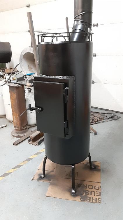

  1. Thanks, the Falcata/Kukri has a blade of just over 12inches long. You can call me Zeke if you'd like--its what most people call me. The woodstove has an air supply coming in the backside with a quarter turn on it. I will run a pipe from it out the wall of my house to that I wont being pulling air through thd cracks in our tight house. Im afraid there's no ash cleanout. I'll just have to man up and scoop out the ashes by the way, how to I attach the name of the person that Im replying to at the top of my reply?? Thank you Oh, just figured it out-ha!

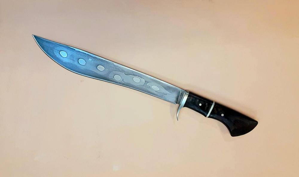

  5. Here are several blades I built recently. The kitchen knife I finished today. The blade is 1095 high carbon with a handle of Koa. The falcata below that I forged from motorcycle chain and 1084 powder cannister damascus. The fittings are nickel silver and the handle is African Wenge. Next is a 4.5" blade Japanese hissatsu with some of my 32 layer damascus and local Alaskan Birch. Then a bowie, and last a dagger also from my 32 layer with nickel silver fittings and an ebony handle.

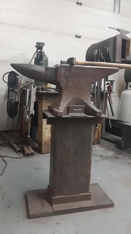

  6. Ive got an old 200 year old, about 115lb Peter Wright made in England. Its in decent shape. I bought it from the man who turned me from a knifemaker into a bladesmith.

  8. Thank you sir, glad to finally be a part of the forum. About 99% of what I build is blades with a little welding thrown in on occasion and a little bit of blacksmithing. Honestly, Im not much good as a blacksmith and have specialized in the forged blade for some time now. I built myself a woodstove recently, and here are a few blades I recently completed.
