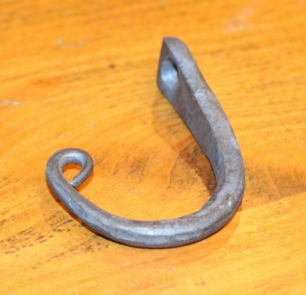

  4. I realized similar things about my hook Frosty. Thanks for the tips. Cool thing is, I can reheat it and get a little practice with tongs next time and save it. The edge above the hole is rougher than I like so I can smooth that out a bit too. I was trying to keep it simple and not get above my raisin, so I figured that hook was actually kind of a good basic thing to try for a first outing. The simple act of adding some tongs to it will be a new thing for me as well so that's actually cooler than it probably seems to you veterans. I just got done with another filling session on the anvil. I don't stretch them out too long because I get a little punchy after a while. I figure after about another 5 or 6 sessions that part will be done I think.

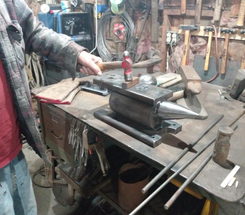

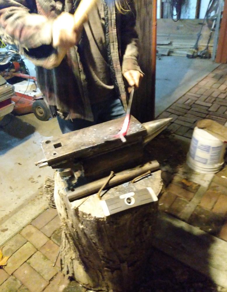

  5. It's apparently an anvil. It's not fully baked yet, but it's adequate for some light cooking. Took it over to my brother's forge and tried it out. I'm blown away by how much better it functions than the makeshift rail track thing we used before. I'm giddy. Below is a pic of THE FIRST thing I've ever actually forged. I started by just trying a bit of drawing out some 1/2" round bar to a small taper so I could curl it. I was just goofing so didn't intend to make anything, but figured heck, it could be a coat hanger somewhere, so straightened it back out a bit so I could make a flat and poke a hole, then curved it back and chisel-cut it off hot. No big whoop and not a fantastic piece, but I'll be darned if I didn't make a little something. Did I mention I'm giddy? This is getting fun. First pic shows my brother roughing something out on my anvil. It works!!! It just gets better from here, right? My first ever thing!

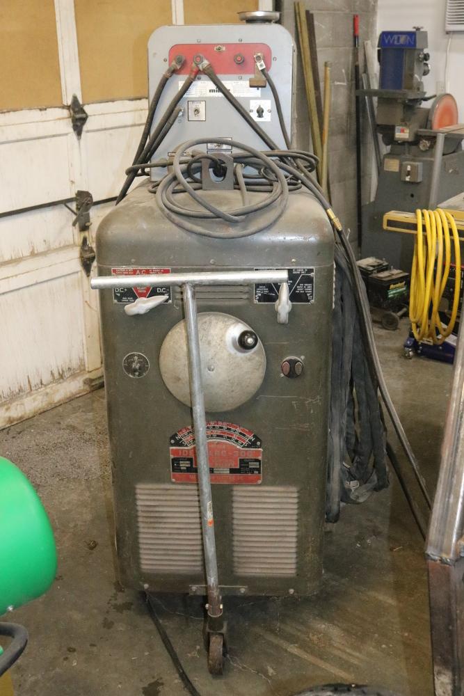

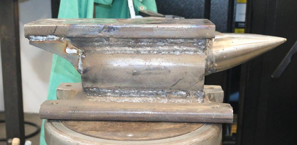

  6. I cut out some steel filler pieces for the back and welded them to it tonight. There are 4 of them across the back which are spaced out to help leave the thru holes thru while also making for a guide for filling weld in between. Also aiding that is 5 brass bars fitting the holes to help keep me from getting weld into them mostly. I may have to occasionally drive them out maybe and then file or ream the holes to smooth them up when I'm done, but no big deal. These brass guards should help when I'm hardsurfacing the top one day too. I'll be filling more, but probably not until tomorrow. I'm just kinda beat for tonight. Might be obvious, but the brass is just the stock I have. They'll be shortened to useful lengths once I start needing them.
  7. I realized I didn't specify which rod after I clicked "save" but figured nobody was interested. Since I was wrong, it's an old case of Lincoln jetweld LH-70 which is equivalent to 7018. Verified it is indeed 5/32" and not 1/8" It's just setting on a little wooden crate for a table to work on. Here's a couple more snappers I think I missed a spot!
  8. Well I just completed another filling session. I'm guessing I've put maybe 100 rods on the sides so far. I dunno, that might be an overestimate, but the pile of stubs I swept up looked like about 50 both times. 1/8" rod... I think. Could be 5/32 but I'm halfway sure it's 1/8" rod. You'd think a guy would know these things laying it down for a while, but I just dove in and didn't care. Best I can figure I've added a little under 5 lbs. of metal so far based on cubic inches of 1/8" rod. Less than I thought it might be but not nuthin' I guess. I'll try to figure out the top surface thing eventually, but there's other things to beef up in the meantime. Making some progress.

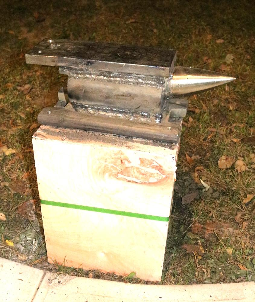

  13. Thanks a lot Glenn !! Well Thomas you might get to see some vertical round too. Not to be outdone, my brother liked what I did so far but he has to have one too, and of course it will be twice as big... just because. And his plan is to set the round vertically and taller, though still a bunch of fill because he's planning three of them side-by-side for the main body. It will be his project but I'm sure I'll be involved to some degree, and I'll take pictures and post 'em. PB, I think the horn will actually still not be exactly "hard" since it's not heat treated, but just a higher carbon content than mild steel in its current state. I'm guessing some 41xx series maybe. But not being heat treated should give it a little more resistance to dinging than 1018 but not full-tilt. I think someday I'll add a harder layer on the flat, but I'm just gonna try it out for a while once I get the sides filled in. Adding more stuff is almost always fairly easy. Heck, I might hate the thing and want to build V 2.0 right away for all I know. I don't think so, but I have pretty much zero experience so it's all theoretical for me so far. Plus, I'm often wrong so I'm kinda ready for any possible outcome at this point.

  18. Well here's the closest thing to an anvil I have. It's just an ASO and still going to add more filler and refine it a bit probably later this week. I'm just getting started so hoping (and expecting) this to function well enough to get into some basics. So far it weighs in at 106 lbs. but will probably add another 10 or 20 lbs. by the time it's "done". The short horn is something hardenable (evident during turning) but the top face is just mild steel, so I'm not expecting any magic. I started this about 3:00 this afternoon and took this picture about 7:30, so all in all it hasn't been too bad so far. I'm a machinist by trade and I can't hardly believe I haven't dipped my toe into blacksmithing before now, here at age 57. Speaking of which, I milled the hardie hole and just had to file the corners, so at least it's square and plumb. My brother picked up a decent forge at auction about 30 years ago and neither one of us ever got around to much more than a short try. But I found a good local source for some coal and we gave the thing its first real go last night. The forge isn't too bad at all - not too fancy but the real deal nonetheless. So I tried my first actual heating & hammering and it went OK. The available ASO was a railroad track thing my brother had. It isn't particularly small track, but seemed pretty light once you put a hammer to it. Probably only 30-40 lbs. if I had to guess. By the end, kinda had a jones for something a bit heavier. Anyways, I know this isn't a dream anvil, but it's heavy and useful enough for a beginner to get started I think maybe. Hope it suffices to either discover this just ain't my "thing" or (much more likely) that I really enjoy it and step up to a nice real anvil in the future. Let me know what you think! BTW, this is my first post here.
