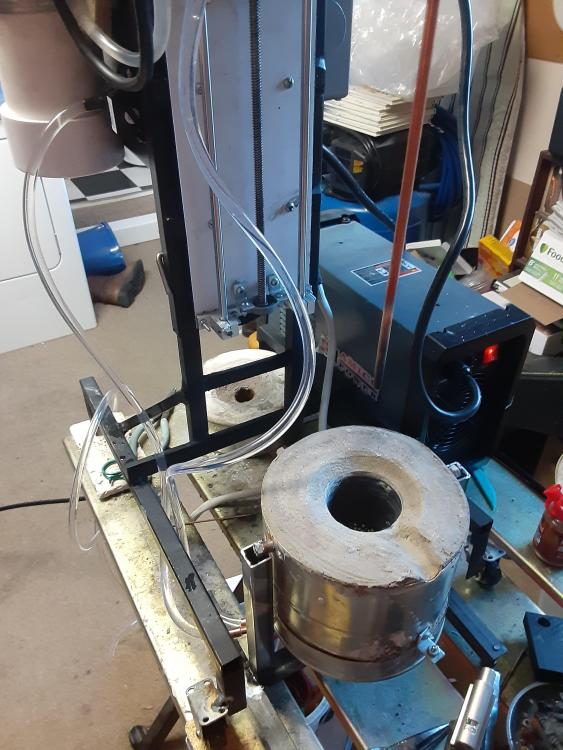

I wouldn't count it out just yet. The arc furnace I built LOOKS like it should be complicated, but it is basically just a little $8 microcontroller that I programmed to turn a $22 stepper motor and rod on a homebuilt carriage. The rod moves an electrode holder up and down. The coolant system pumps water through the rod holder (plumbing parts soldered together), through the bottom anode (about $15 of plumbing parts) through a fan driven radiator ($10 eBay) and back into a holding tank ($20 of PVC and hose barbs). Unless you are using a constant voltage source (MIG welder or SMPS, in which case current fluctuates), for electric arcs, shorter arc=lower voltage/higher amperage, long arc=high voltage/low amperage. Since most DC stick welders are constant current, the only thing that varies much is voltage. The trick is to get an arc length that maximizes the Wattage (Voltage x Current). so it is usually somewhere in the middle. Then you program the microcontroller and essentially tell it: "if the voltage is too low, back the rod up x number of steps, if the voltage is too high, turn the rod down x number of steps, if it is in the optimum range don't do anything." Then the microcontroller does this for you hundreds to thousands of times a second through a stepper motor controller ($19 on amazon). Because of this it will start the arc for you since it starts out at open circuit voltage (about 80V for my setup) and then dips to nearly 0V when it makes contact with the metal in the crucible (arc start) then backs up to the proper voltage, drawing the arc out. I have found for steel and arc about 1/2"-3/4" is about optimal as it is stable and isn't super loud but also dumps heat into the pool pretty quickly. As the metal melts, the voltage changes and the microcontroller automatically adjusts for that, maintaining or restarting the arc as necessary. Mine has a lot of other functions I wanted on it, like the upper and lower limit switches (so the arm doesn't bottom out at the top or bottom of travel), the arc length and step size control knobs, the screen that gives you a real time readout, and the pre-heat function. But none of those are necessary to get the thing to start and maintain an arc automatically. If you already had a welder, I would estimate you could build the rest of it for about $100-$150. Also, surrounding your crucible with a kaowool/high temp insulating refractory will go a long way to reduce the time it takes to melt anything given less heat loss. don't give up on it! Once you get it running it is so exciting and then you just get to watch it do its thing and melt your metal for you. The other thing you might look into would be an induction furnace. That is a much more complicated (read fancy, expensive electronics) build, but ultimately more efficient and less contamination to the steel. Also much faster if you have a big enough one.

How much metal are you trying to melt? My electrodes (3/8" gouging electrode) last probably an hour or each on DCEN. I have a bottom limit switch on my furnace that bumps the carriage when it hits the bottom of travel (electrode too short) and stops the furnace until I change the electrode. Mine is a computer controlled furnace and I am running it at about 120A most times and am trying to melt up to maybe a few pounds of metal at a time, not much more. Large furnaces figure about 200Wh/pound of metal, but that is economy of scale when you are melting 300 tons at a go in a $275,000 crucible lined with magnesium-Carbon bricks and 1.6GJ or power. I figure If I can melt 4lbs in 45 minutes to an hour at about 4,000-5,000W I am doing pretty good. Water cooling the bottom anode helps a lot, but I need to add another radiator. The one I have on my furnace was the right size when all I was doing was cooling the electrode armature, but with the bottom electrode in contact with the molten pool, it takes a good bit more cooling now. It is always a balance of trying to dump as much heat into the pool as possible but also needing to actively cool the components, which sucks heat from the pool.

The water is distilled and has about 5% anti-freeze mixed with it (ethylene glycol) making it non-conductive, or at least tremendously resistive. Otherwise, the current could travel through the waterlines and short back off the case through the aluminum radiator which is hard fastened to the case and thus the ground. Also I didn't try to mop anything up while touching both the cathode and anode lines... I shut it down first... I just let it run while coolant was dripping, then shut it off and mopped stuff up. I think I have plugged most of the leaks at this point. I am not in the habit of playing with wet electrical connections. That just seems like I would be begging for a Darwin award. Thank you for your concern though... I have a young child and I cannot imagine leaving her without her father, so I am overly cautious about things that could be dangerous... not so much when I was young and it is a miracle I still have all my fingers from all the "fireworks" I had made by raiding my dad's reloading supplies... I'm a little wiser now... I hope.- 64 replies

So I couldn't wait so I set up the crucible with its water cooling system and took a crack at running it. Bottom view under crucible housing where the water cooling comes in for the anode: View of the top: This is temporary to find any issues before I ratchet everything down. And it works! This was just on the preheat cycle so I didnt let it get too hot. Had a few water coolant leaks but other than that it works great! Now to test how far down the anode will melt....- 64 replies
