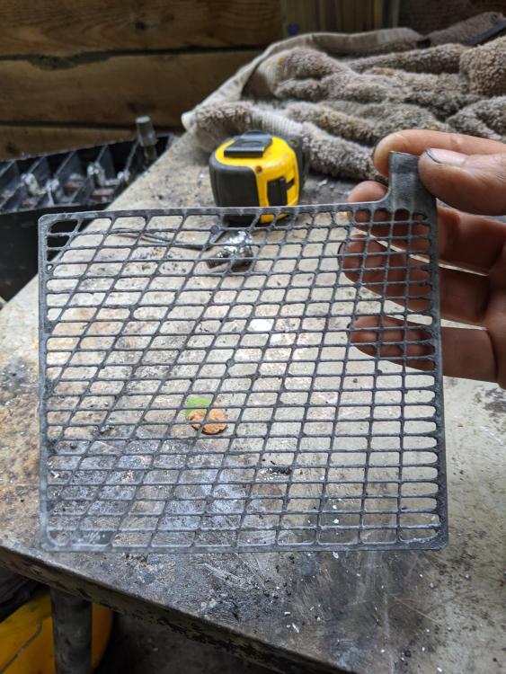

  4. This is a battery plate grid. They come in different grid shapes depending on the manufacturer, but just a standard vertical-horizontal grid works just fine. The grid size is generally 5.75x5.25" and about 1/16" thick. This is what connects an array of plates. each array forms the positive/negative halves of a cell. This is what it looks like inside a lead acid battery. The plates are arranged negative to positive with 10 positive and 11 negative plates per cell. Each Positive plates is always encased in a porous separator pouch to prevent the positive and negative plates from touching and shorting out.
