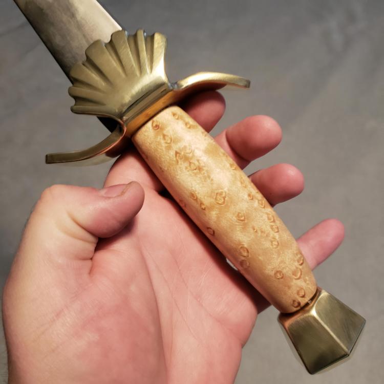

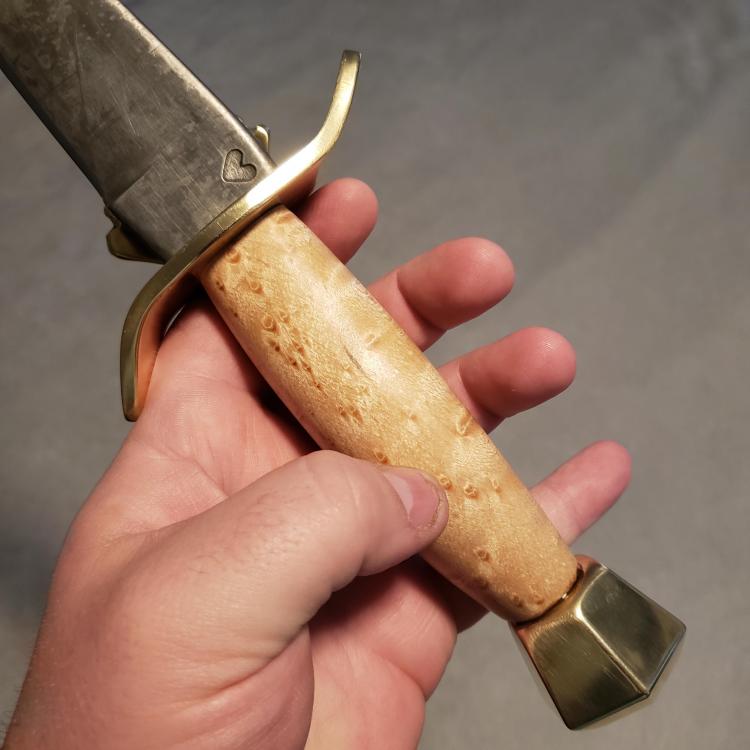

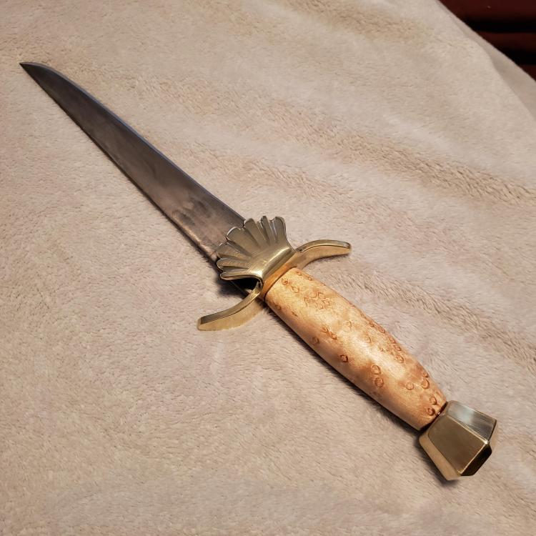

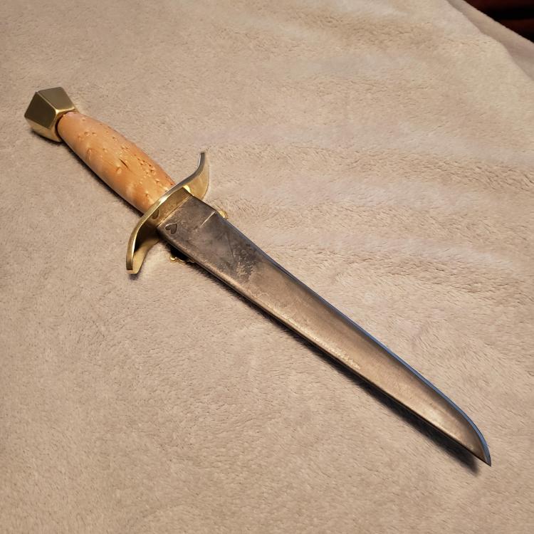

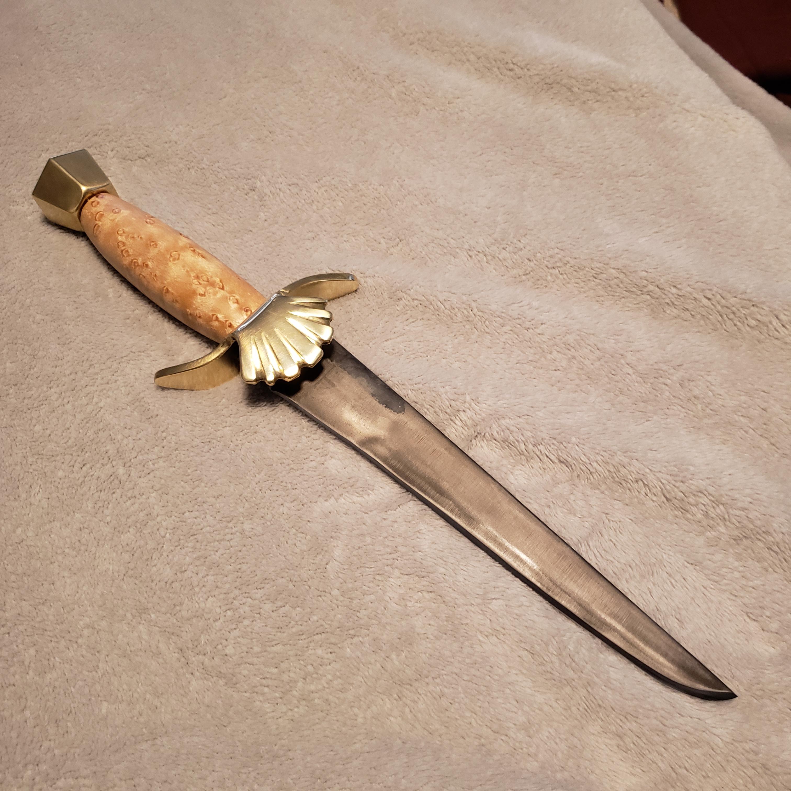

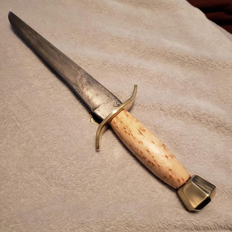

  1. There really is no visible epoxy there. I'm guessing it's some kind of optical illusion in the picture. But I do agree that the pommel is a bit out of sorts with the handle. I dry fit the thing about 200 times before final assembly but when I glued it up the pommel just didn't line up exactly. It either over tightened or under tightened by a half turn. It should have been a 1/16" reveal the entire way around. Not none at the bottom and 1/8" at the top. I'm not entirely sure what happened... but thanks for the feedback!!
  2. I recently finished this blade for a gentleman that does revolutionary war reenacting. It is a hand forged blade from 1095. (Quenched and tempered). 10" blade and 3/16" finished thickness. Just over a 4" hidden tang. I slotted the tang and welded in a 1/4" carriage bolt for the thread. The gaurd and pommel are solid brass. The gaurd was cut and ground from 3/16" x 3" brass. Annealed about 20 times as I slowly hammered it to shape and all hand filed and hand sanded the shell. The pommel is 1-1/2" hexagonal brass bar stock that I ground to 1-1/4" so I knew it was square. Drilled and tapped to thread on. 45° angles on the end and 16° angles on the handle side and hand sanded to final shape. All the brass was buffed to a nice golden mirror shine. The handle was made from a 1-1/2" square block of birdseye maple. Ground to size, shaped with files, and hand sanded to 400 grit. Topped off with 3 coats of danish tongue oil and hand buffed. I vinager etched the blade for about 18 hours and cleaned it up before final assembly. Everything was epoxy'd as I went. Right down to the final turn of the pommel. Its feels good in the hand and is quite well balanced. Feedback is welcome and appreciated. Thanks.

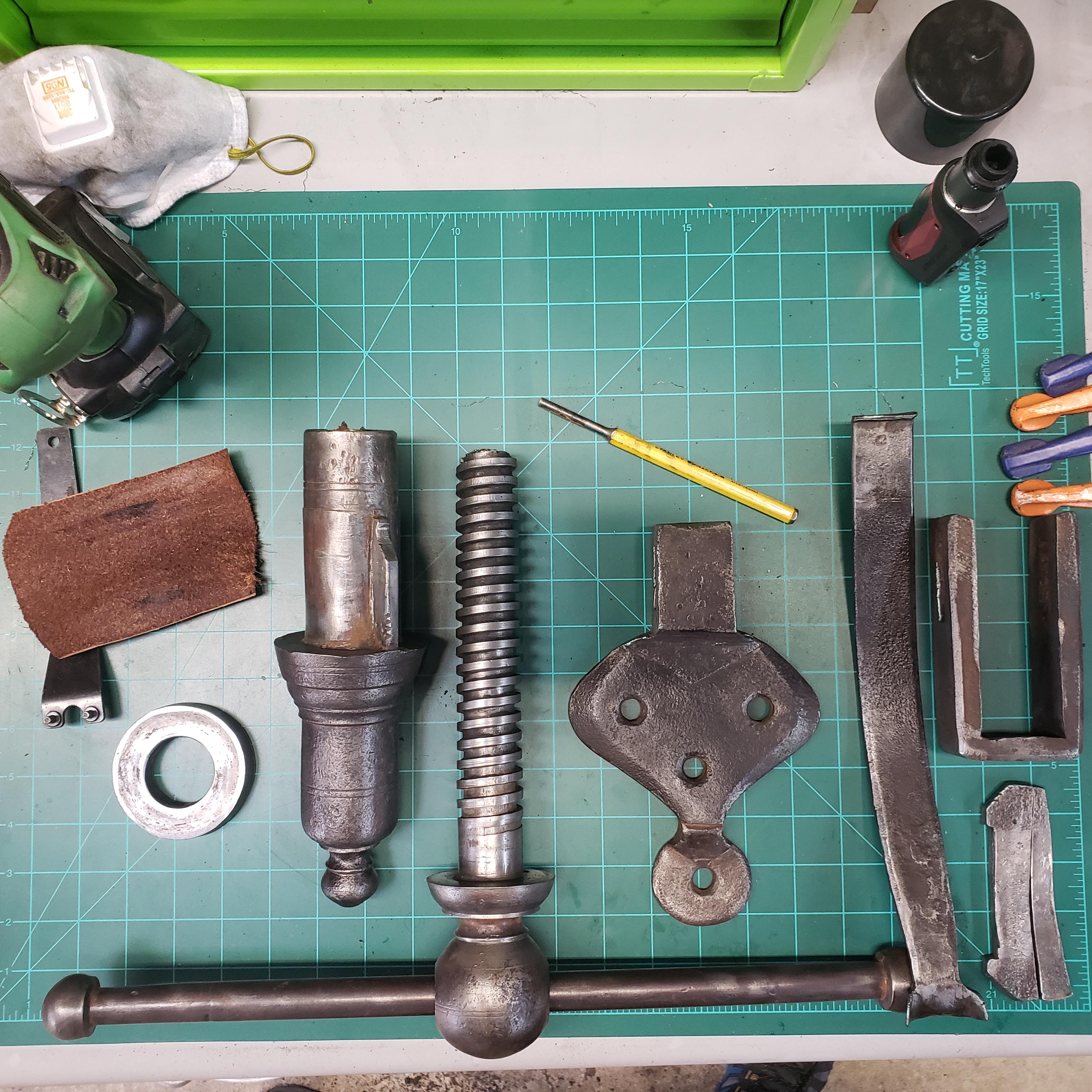

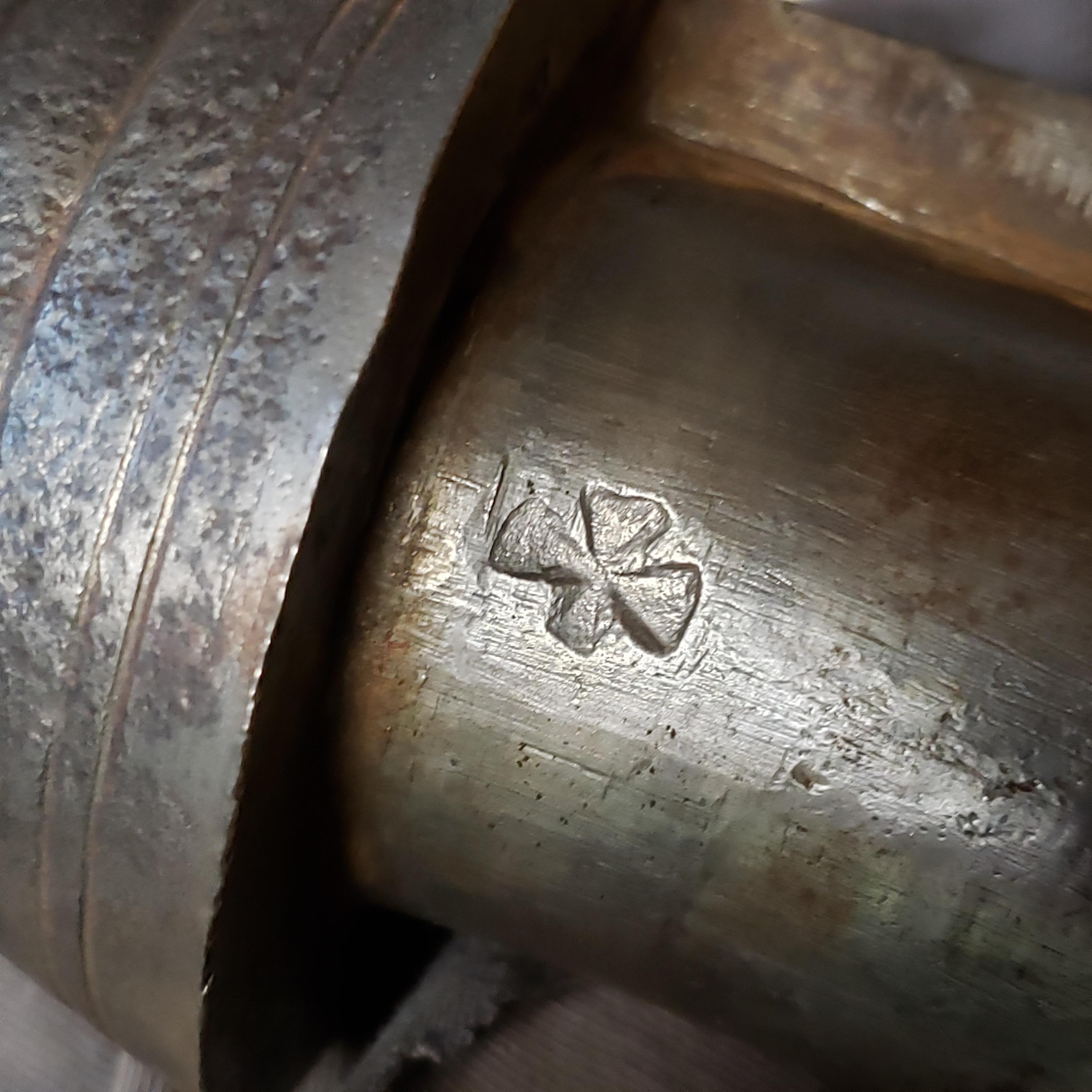

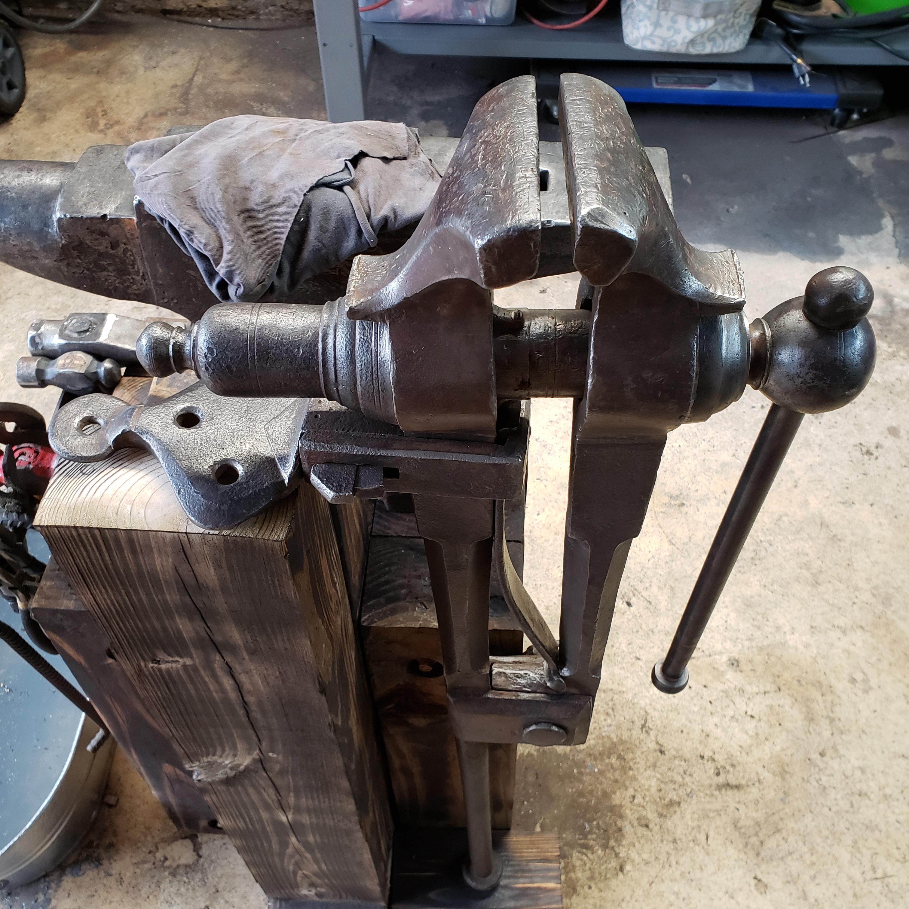

  6. I saw one of those for sale on Ebay recently. 500lbs if I remember correctly. If you have a spare 5800$ dollars laying around that is. Hahahaha A leg vise is designed specifically to take the abuse that a standard bench vise is not. It distributes the hammer blows in a way that doesn't hurt the vise or the surface its mounted to. The screw block is a completely isolated unit. Allowing the "hulk smash" to be absorbed by the ground and not the threads.
  7. Here's a few photos of the vise. And one of the "clover" stamp.
