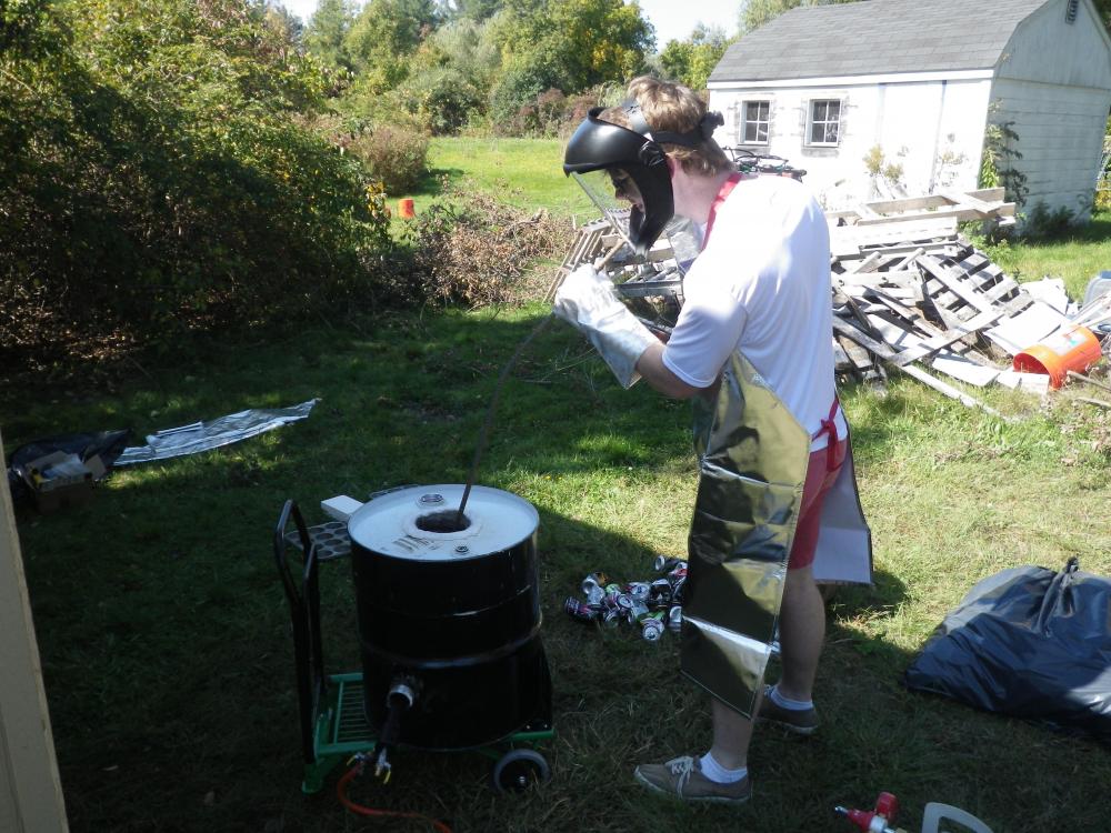

I'm not going to make any excuses for my son's attire but I will say that I kicked him out of the area before removing the lid and pouring. I was wearing aluminum leggings over boots and jeans with a welding jacket under a similar apron and gloves and face shield. My father died of lymphoma and to this day I am convinced it was caused by absorbing 50 years of chemical cocktails through the skin... it was a different time then... safety is my primary concern. I know of a wheel/tire shop with a whole backyard full of busted wheels. How do you know the quality of the aluminum? -

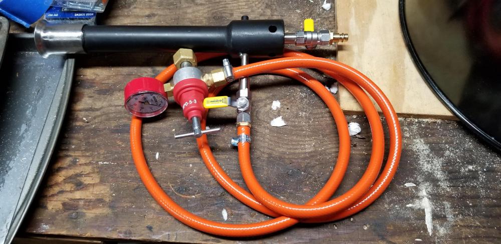

I appreciate your caution. After doing a little research, I think I understand the difference in opinion. You have a background in glassblowing, correct? I believe Oxy/Propane torches are fairly common in that industry and, as Thomas said, a flame arrestor/check valve is recommended when you are using pressurized Oxygen and Propane in a torch. My burner combines air in a venturi, just like a BBQ grill. It will run at 100,000 btus on its own and up to 300,000 btus when a compressor line is attached. There is no chance of the air being forced into the fuel line since the fuel and air are combined in the venturi. Even when I add an air compressor on to it, it is still not going to make its way into the .30 jet in the burner. If I tried to over pressurize the air by cranking up the compressor the air will just escape out the vent holes at the back of the burner. --- Yes on the rigidizer and coating. The horror stories on this site were more than enough for me. I will definitely put a drain in before the next melt. Thank you. Do you have a suggestion other than drilling a hole? I used half of my cans on the first melt and lost about half the weight to dross/slag. I'm going to use Morton Light Salt (potassium chloride) for flux on the rest of the cans just to see if the result is significantly different but I have to agree that using cans suck. I'm already collecting it from other sources...I have an old ladder that will probably go in next. -

first furnace, first melt
gadget replied to gadget's topic in Smelting, Melting, Foundry, and Casting
I bought the burner from Devil Forge. Where and why would you add a check valve? thanks in advance -
I'm posting some of the photos I have taken as a thank you for all the great information that I have found here. I've learned more than a few things here including many safety tips such as using a rigidizer on the Ceramic Wool. My son helped me out as I ran around solving minor process issues. I tend to over engineer but figure this furnace will be fine for up to 2500F.

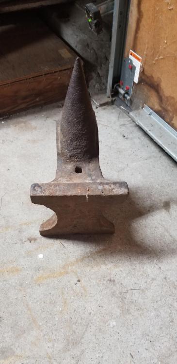

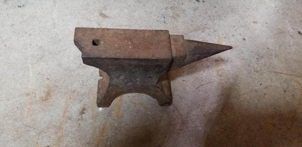

58 lbs and about 15.5 inches long My mother in law gave it to me after I spotted in the basement. She was using it as a door stop. It rings when I hit it and a hammer bounces back from it almost as high without effort. I know absolutely nothing about blacksmithing except what I have seen and read and have just started researching it. I would welcome any advice or observation. what does the 3 mean? it is the only marking that I noticed.
